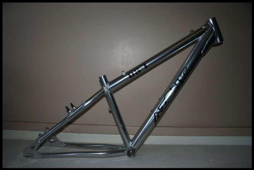

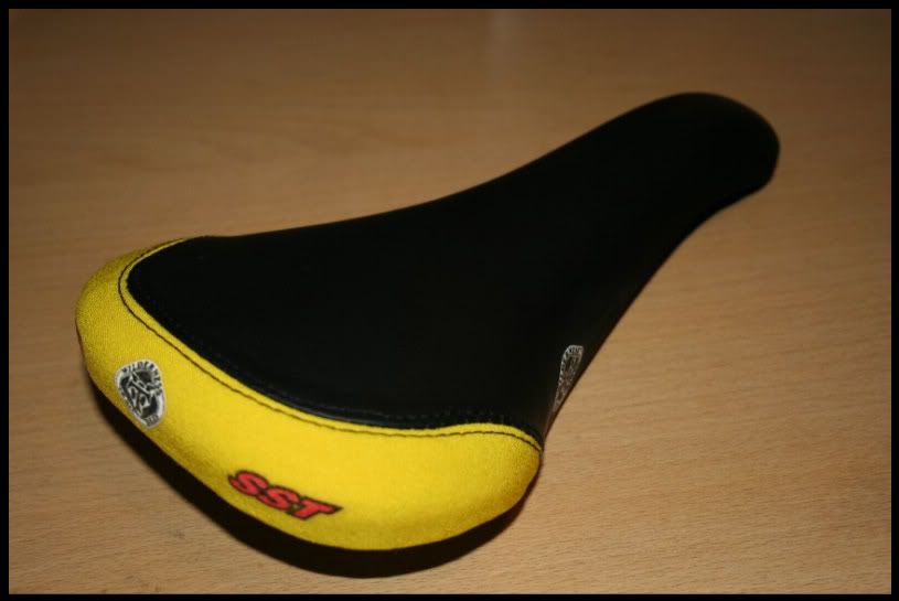

I'm currently trying to rebuild the custom bike i 1st built in 1997, all i've had to go from is a few old photos and my memory, have been collecting parts for 2 weeks and am getting somewhere now.
The bike (1997):
click thumbnails to enlarge
Azonic DS-1 Frame

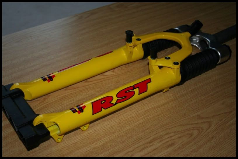

RST Mozo Pro 3.5" (May swap these for Rock Shox Judy SL's (if i can find some)

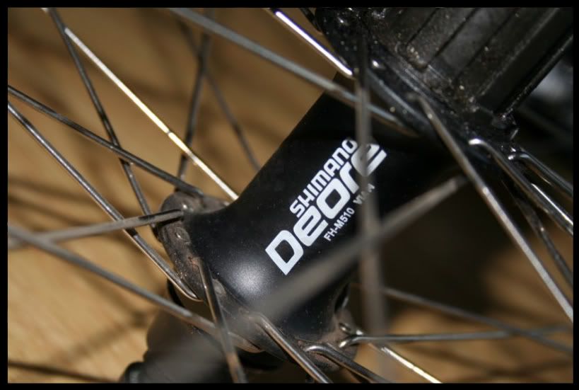

Sun Mammoth Rims (Had silver in 97 but black will do)
Deore Hubs

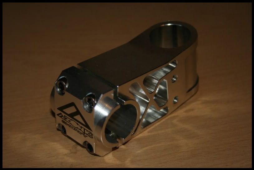

Azonic Shorty
FSA Headset

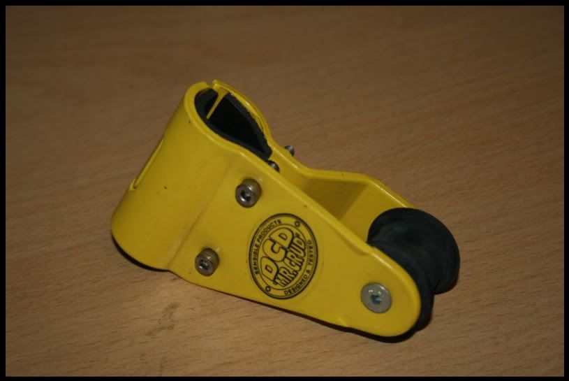

DCD
WTB SST
Stickers
Still have a few more parts in the post and on my list but i should have finished photos pretty soon. More pictures to come...

Looks like its going to be pretty good. All except the evil little DCD... The one I had came loose and twisted into the spokes, writing off my wheel. A useful tip though: if you wrap electrical tape around the roller it will prevent the chain from wearing grooves into it

Good tip, i'll try that :)
i had exactly the same problem, but mine was cuz i didnt tighten it up enough when i had last fiddled with it.

(and my DCD ended up with grooves from chain wear :lol: )
How about a bit of 700c innertube cut to the width of the roller and stretched over :wink: Prevents grooves and makes things a little quieter.

I guess its whatever you have lying about. I can imagine the innertube would be quieter but the electrical tape didn't seem to wear at all
