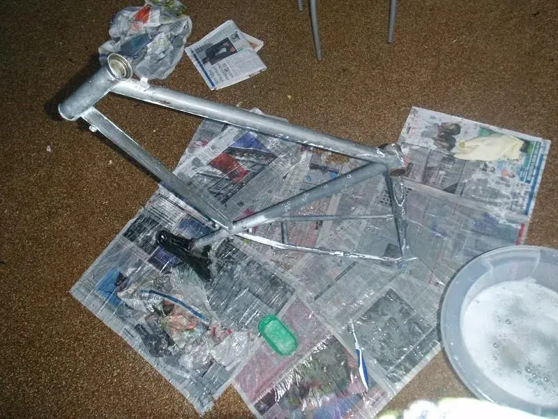

This was my first ever attempt at removing paint. Armed with a big tin of the Nitro Mors stuff, some newspaper, protective equipment for me, a baby bath full of water (baby does not fit in it anymore - it is just a £20 bucket my wife bought!), wire wool, toothbrush and bike bits I spent a lovely afternoon outside in the drizzle.

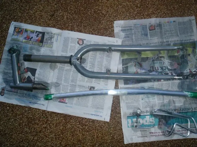

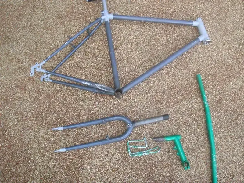

So I laid out the bits for a quick photo (see below). I then spent a while brushing on the chemical goo, getting very excited as it started to bubble away. As a stroke of luck my dad found the original Marin Lite bottle cage from my original Marin, along with the seat QR that he sent down to me. On both of these Aluminium parts the paint just fell away. It really was a joy (no primer?).
I then moved onto the bars and stem. The bars were quite easy to wipe down due to the shape. The stem was a bit harder with all the nooks and crannies but I got most of the paint off. Having never done this before I was pleased with how easily the lacquer came off, but it did take rather a lot of scrubbing with the wire wool to get rid of the paint and undercoat. I also spent a happy ten minutes scrubbing away before I realised that my rubber glove thumb had rubbed itself away so I was rubbing the Nitro Mors into my skin. Anyway no damage done, it is still the correct colour and not too red. At the moment.
I am really pleased with the result. It will be a shame to paint the bike now, the look of bare metal is beautiful, with the welds showing up neatly and the brazed on guides looking lovely (not sexy, just beauty to an engineer, you know what I mean).

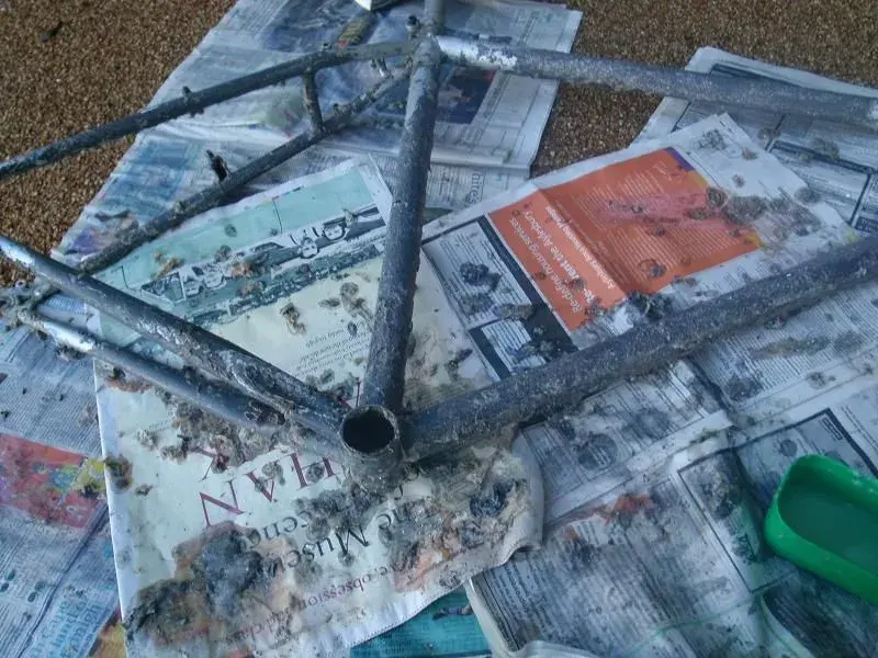

Next up were the forks. These took, for such a small part, quite a lot of work to get rid of the paint. From reading other posts I was under the impression that you paint on the Nitro Mors and all the paint just falls away. That was not the case today. Eventually the paint was removed and my fingers were starting to cramp with the effort.
Finally I started on the frame. So far this has taken a lot of effort. Partly due to not having quite enough wire wool, so the last hour was spent with old bits trying to scrubb the paint away. I also had to finish a bit earlier than planned because a) it got dark, and b) I had to go and make tea for my daughter.
Next up on the agenda is, wife permitting, to re-Nitro Mors the frame after buying some more wire wool and LARGE rubber gloves. Logically, if I had known it would be this much effort I should have just bought a new bike. But then it would not have meant so much to me.
