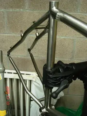

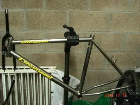

OK. Some of you will know this frame by now. I've been unsuccessful in my attempts to sell at a reasonable price, so am starting a build. I will document the build on a reasonable regular basis. I don't anticipate completion before the end of May (due to cash flow issues).
It will have 80mm Zocchi Z2s up front, and hopefully a full 8sp XTR component set.
Now, I'm interested to find out if anyone has successfully fitted disk tabs to such a Ti frame, or indeed if it is complete sacrilege to do so?

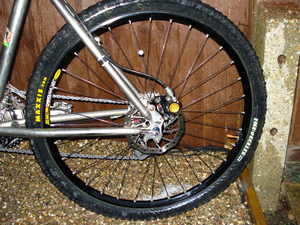

Failing that an adapter? I have an AtoZ one that works fine with my flat ti dropouts on my Hei Hei.
Not mine but you get the idea:

letmetalktomark wrote:
If you are contemplating a disc tab these guys are worth a shout....http://www.enigmabikes.com/index.html work seems to be very good considering the complexities of working with Ti.
Seem good value for money too.
A while ago, I had a quote from someone who was recommended to me for Ti disk tabs. It came in at £90. That included a brace stiffener.

So I'm going to do the proper thing and sort a nice build. Whether I will keep the Obed, or the Explosif after that build remains to be seen, as I probably won't keep both at the end of the summer.
I'm waiting on a disk tab quote, though the Ti guys tell me that the kinked stay Litespeeds can be difficult to sort that way.
 Post subject: ...
PostPosted: Thu Jan 07, 2010 5:34 pm
Joined: Thu Mar 19, 2009 12:08 pm
Posts: 1645
Location: Wales
Got a price for those of you who may be interested.
The snake stay models take much more filing etc, and thus the cost for fitting tabs, and a stay is roughly £200.
Lot of money.
