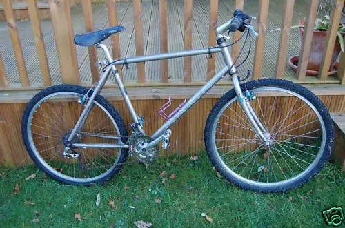

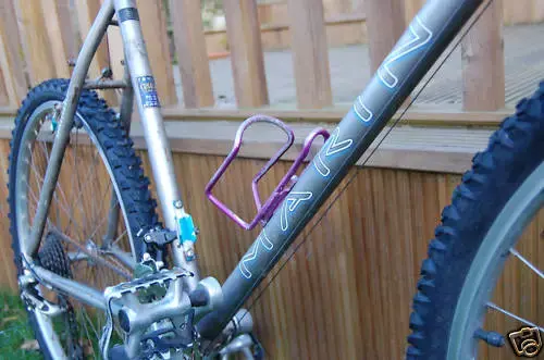

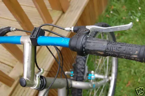

As suggested, here are a few pics of the '95 Marin Palisades Trail I picked up on Ebay. Not a pretty sight but any thoughts on the first post above would be appreciated!
Scratches on the frame are a fair bit worse than they look in the pics.

Paint wise I'd suggest going to model shop and buying a range of humbrol paints and trying to find or mix a match if you want to go down the touch up route.
Respray and new stickers the other route. Try gil@cycleshed.co.uk for decals. This however is not a cheap option!

Thanks John. Thinking it through I reckon I'll be better going down the 'Humbrol route'. If I do that, do you (or anyone) know if there's a good lacquer I can use to finish it? Is lacquering the best route or some other way?
When I've touched in chips before (and tbh I've never done an outstanding job so don't count me as an expert) I've painted a little higher than existing paint then flatted it back with a light abrasive like t-cut. Finally have polished and waxed using normal car stuff. I've never bothered lacquering a frame before...
