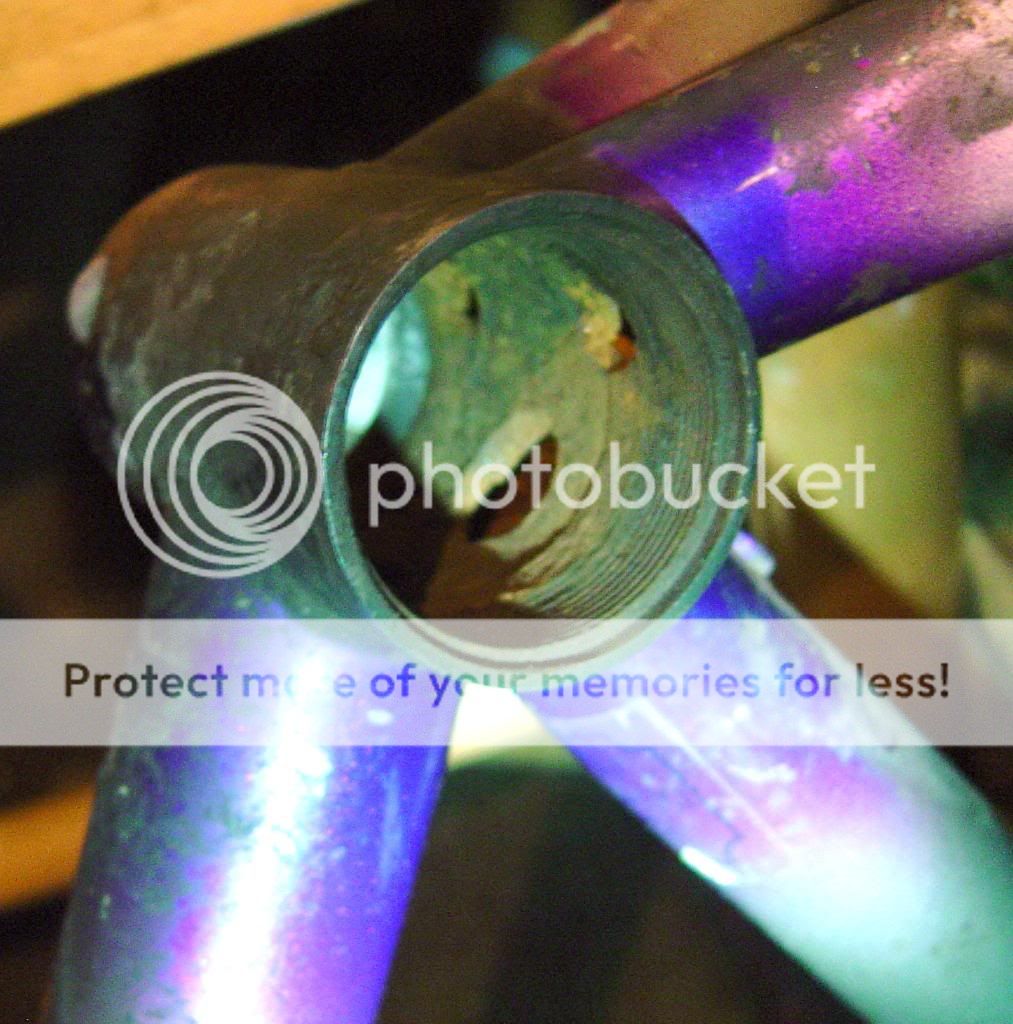

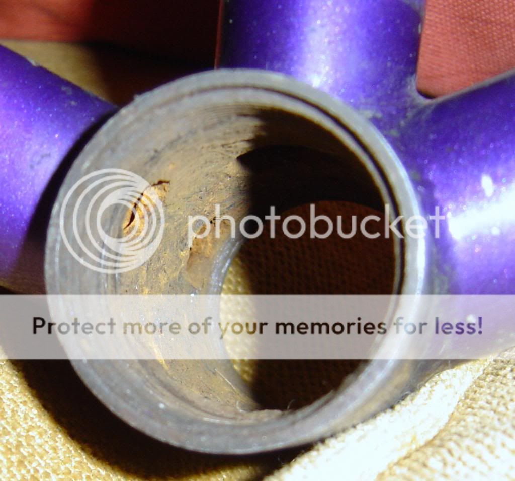

Got this frame yesterday from the bay and looking to get it licked back into shape. Initially my heart sank as I heard lots of tiny bits of rust rattling about in the rear wishbone coupled with the very rusty bottom bracket, however after much shaking and a closer inspection, I'm pretty sure she can be treated and protected from further decay 8)
I never really liked the purple/silver fade much preferred the matt black earlier prestige's so think I will go down that route (also fancy the powdercoat option as it is more durable and cheaper than a fade). Looking at early xt and pace forks pretty much robbing all the bits from the clockwork as TBH it is a wee bit cramped for me (the prestige is 1 inch longer in the top-tube but the same size as the clockwork)
It is in the towel cupboard getting super dry and then its waxoyl time, drill a drainage hole in the BB and then a trip to the powdercoaters.

Buy a bottle of Hammerite Kurust, pour it into the frame and let it slosh about, it neutralises the rust and turns it black, then blast some Waxoyl through it :wink:

+1 also when you waxoyl sit it in a bucket of hot water, this'll thin it a bit and give you better coverage. :)

Not wishing to be pedantic, but surely the sequence is 1. Kurust, 2. powdercoat, 3. waxoyl? i.e., the powdercoat bake would turn the waxoyl to useless gunge (and possibly damage the new paint?)
I think the Kurust idea is sound, but you ought to file/sand away as much rust as you can from the bb shell before you apply the Kurust, as I'm not sure how deep it penetrates - so if you have really deep rust, there's a danger of leaving a layer of rust between the sound steel and the new black outer surface, and that could prove unstable.

Need to be careful when cleaning out the BB that I don't damage the threads.

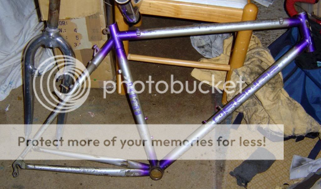

A bit like this one?
Yes, I guess similar but lighter does justice to both parties in that excellent comparison.
