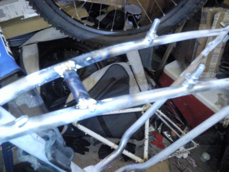

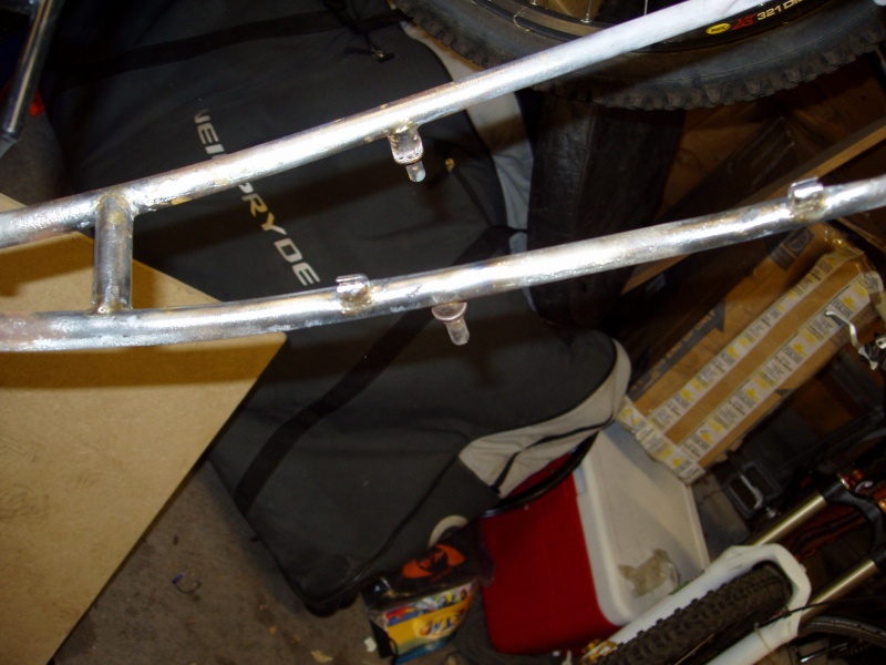

Anyways here are soem pics of the stripped frame.I am brazing on canti bosses and cable guide. I also wided the rerar end to 126mm for seom 70's large flange geared hubs. My Brazing is not as good as it was 20 years ago so some work needed to make it tidy. Anyways here it is with one bridge and canties done:
1. Old Bridges cut out and canties on:
2. First new bridge in:

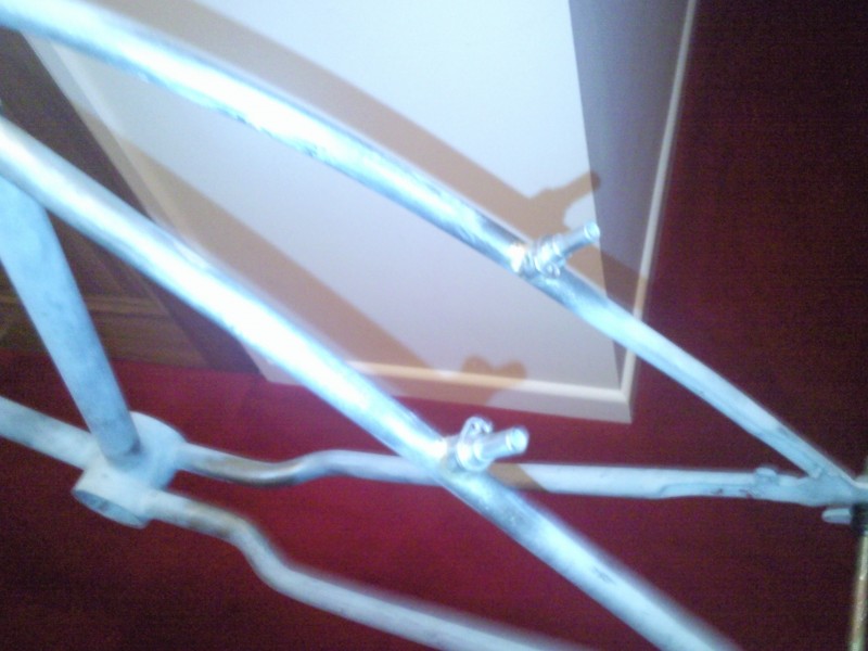

I have put on the bridges to widen the rear end to 126mm. canti bosses cleaned up a bit. and put on soem cable mounts. my brazing is not perfect and needs a bit of a clean up. you really have to clean all the old oxide of the frame before you can get any decent flow with the brass.

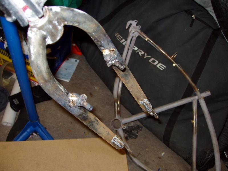

i have imported some cook brother forks, and brazed on some brake bosses.
my brazing has come on hence the small fillet, but still need a bit of cleaning up:

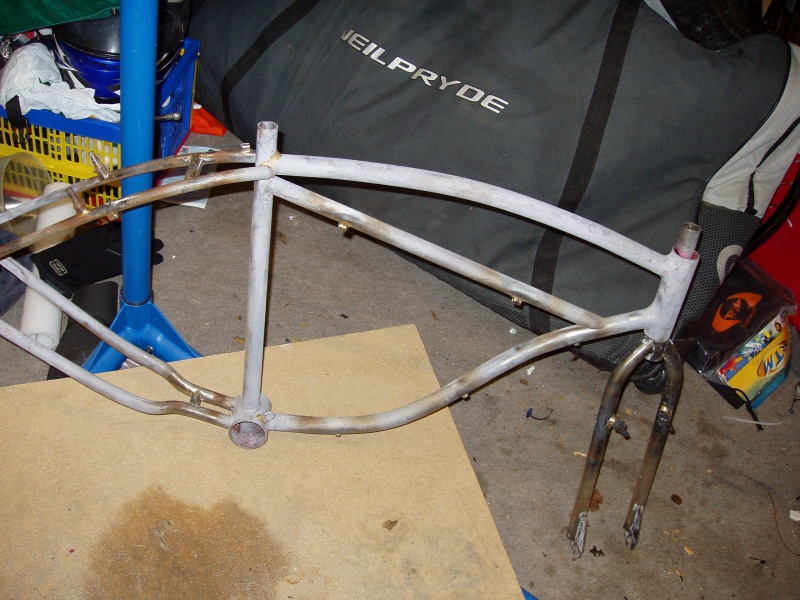

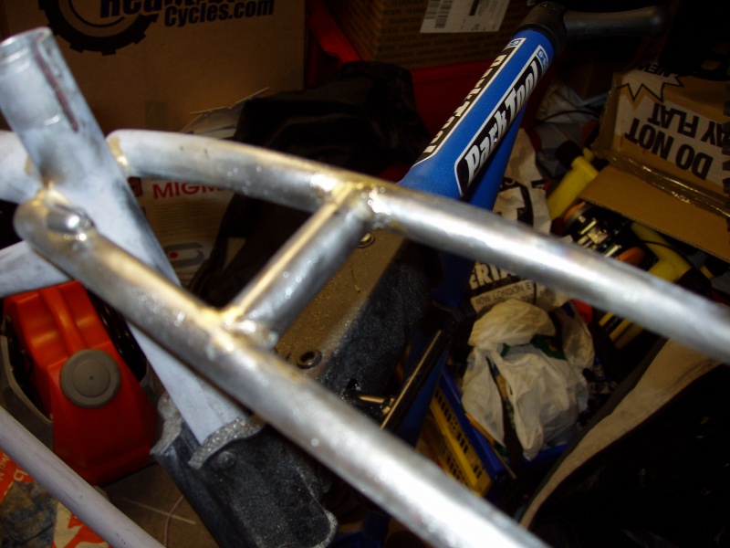

I have finished the cable routing braz-ons and the frame and it all ready for a clean up and paint:
