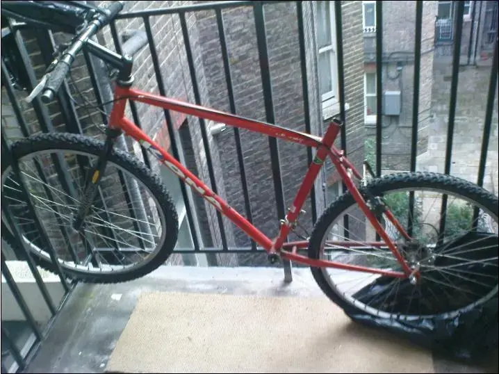

Thanks guys that's great, it sounds like I need a 26.4 seatpost, i should be able to remove the bb with the usual shimano sprocket took thing, and i need to replace it with a square tapered sealed unit that has a standard diameter but the axle length is the only variable so i can measure the old one once I've removed it - is all that correct?! I'm putting some '95 xtr cranks on so they must be fairly standard. Here's a pic as requested, not many standard parts left unfortunately, and quite a bit of work. Will be worth it though... Thanks everyone.

Pic didn't come through. Is it bigger than the file size limit maybe?

Right guys it seems you really do know what you're talking about, I've measured everything up and it's a 68mm shell and the spindle seems to be 122.5 wide. My XTR cranks are fc-m900 and they seem to fit on fine so I'll just get a new BB with the same specs but as a sealed unit ie cartridge type. the Tange BB was easy enough to remove using unorthodox methods... has a lockring which I tapped off using chisel and hammer and then one side has little holes that long-nosed pliers fitted into and got a large spanner onto the other side.
I've just bought a 92 kilauea also so i think I'll keep the Cinder Cone as an MTB and turning the Kilauea into a rapid commmuting bike with slicks! Will keep you posted, see photo below... thanks everyone.
