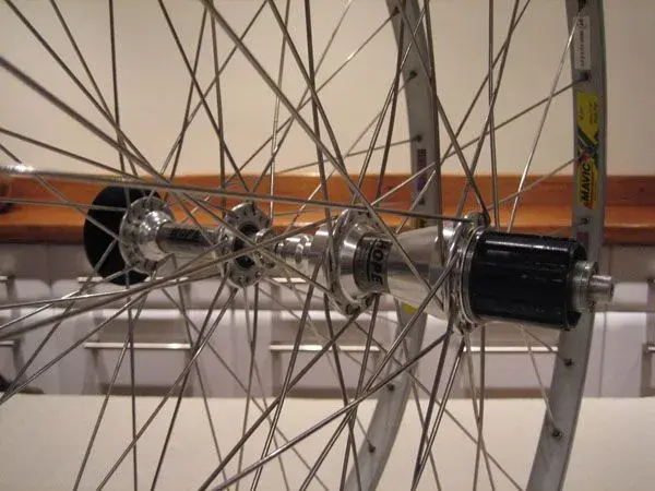

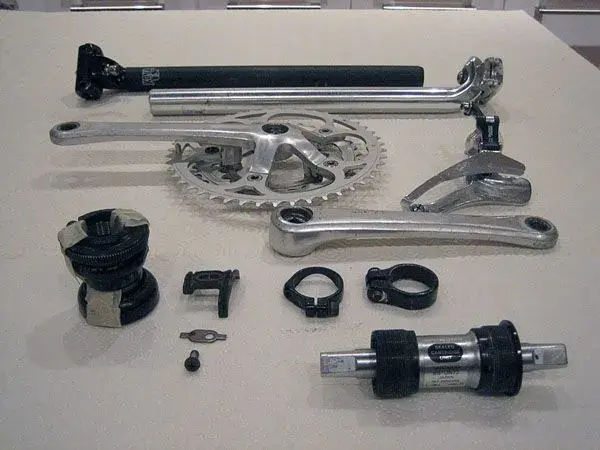

Frame: Custom Tange Prestige tubeset
top tube: Ultimate Ultralight
downtube: Ulitmate Utrastrong (externally ribbed)
seatube: Concept, rear triangle: Concept
Fork: Kona Project 2 Triple Butted
Headset: Joe Murray Impact Black
Stem: Joe Murray Velocity
Handlebar: Kona Race Light 165
Grips: Modern Kona Race lite
Barends: X-lite stubbies
Brakes: Dia-Compe 987 (NOS)
Brake Pads: Dia-Compe or Kool Stop Eagle 2
Brake Cables: Shimano
Cantilever cable hangers: Dia-Compe (NOS)
Brake Levers: Dia-Compe SS5 (NOS)
Shifters: Shimano Deore XT Thumbies
Front Derailleur: Shimano Deore XT M735
Rear Derailleur: Shimano Deore XT M735 Short cage
Derailleur Cables: Shimano
Cassette: Shimano Hyperglide XT CS-M737 12-28 8 speed
Chain: SRAM
Cranks: Sugino Mighty XP
Crank Bolts: SRP USA
Chainrings: Sugino Super Shifter
Chainring bolts: –
Bottom Bracket: UN72
Pedals: DMR V8s
Skewers: Hope hex key
Rims: Mavic 231 Silver
Hubs: Hope
Nipples: Alloy
Spokes: Stainless
Tyres: Schwalbe Citty Jets 26 x 1.50
Tubes: –
Saddle: SDG Bel Air Ti (265g)
Seatpost: Kona Race Light 350mm (275g)
Seatpost Binder: Gusset

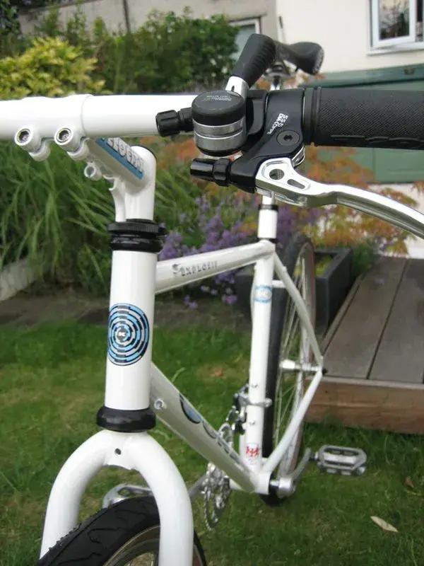

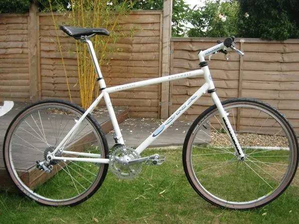

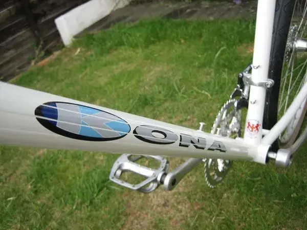

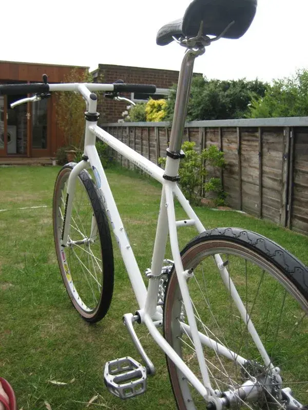

PostPosted: Sun Jun 28, 2009 9:04 pm
Joined: Wed Jan 07, 2009 6:33 pm
Posts: 264
Location: Essex
Hi all, just a quick update on the Explosif.
Just received it back from Bob Jacksons after waiting what seemed like and age. It's taken me most of today building it, taking it easy as it's my first project!
Now I know some of you are going to think it's sacrilege to disregard what many have said is the best paintwork of all Konas, and i know what i have chosen is not very original, but i love it. The pictures don't do it justice at all, it looks superb.
I went with a new colourway of the original decals, and apart from the hideous oversized pink project two decals on the forks i am really pleased. I'm going to source correct sized cut vinyl for these and send them back for another spray.
The Impact headset had a little tart up with some 'halfords gloss' and the result is better than I expected. I had a small setback when fitting the rear mech break off bolt, this took up almost and hour alone to get that 'freakin' spring back in place. I have no cables fitted and therefore no adjusting problems yet, however i have a feeling this maybe just around the corner.
I have hit a stumbling block with the cantis. I have the three holes on the forks to hold the springs, which i assume replaces the first nut with the hole. However, when i put the rest of the cantis on and screw the bolt home i have a gap the size on the removed nut. which i know is wrong.
Could someone give advice on this.
See below for some updated pics and forgive me for yet another white Kona. I'll update this thread with my progress and hopefully soon a finished bike.
All comments welcome.
