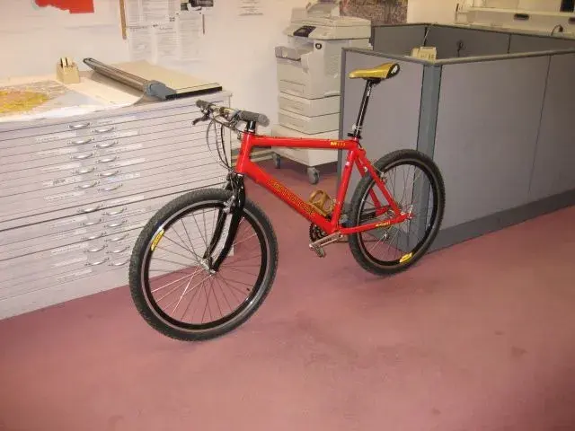

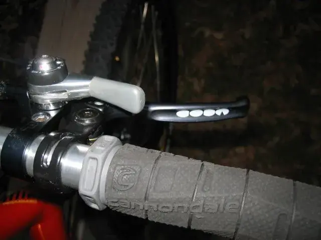

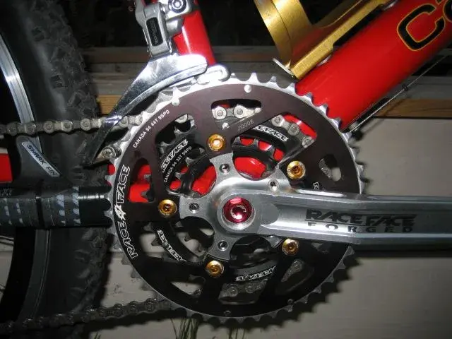

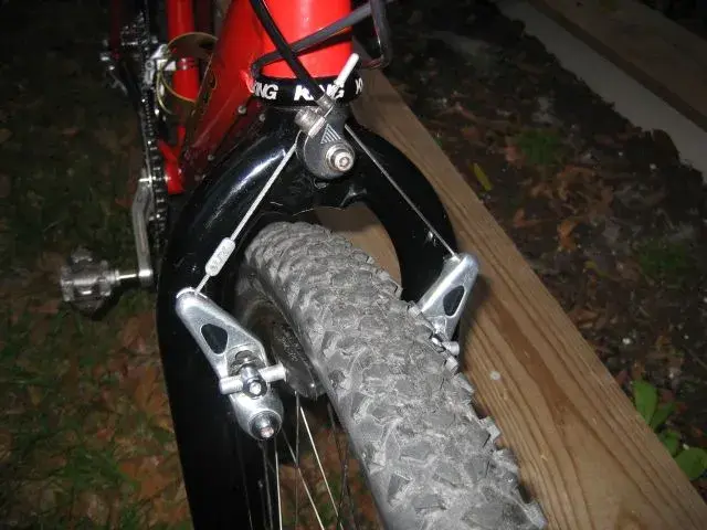

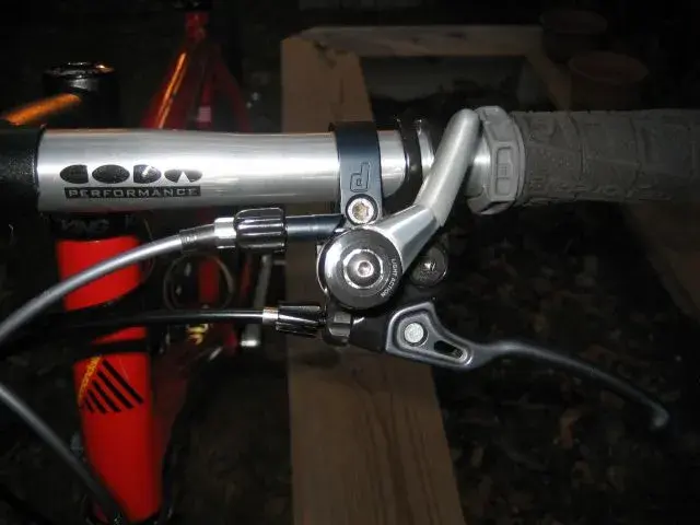

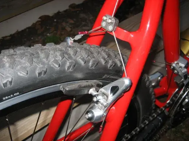

I built this bike as sort of a resto-mod, as far as the drivetrain is concerned, converting the older XT hubs to XTR 9 speed and then fitting Dura Ace shifters and a Sram cassette and chain. The rest of the bike is pretty period for the year. The Deore DX parts would have been installed on the Beast thru 92, and then LX with DX thumbshifters for 93 and 94. The Force 40 brakes are on the front, but because Force 40s were such a horrible invention, I've kept the X-IT Dual-Eez hanger that I originally fitted to the back. Hey, I worked for those guys, so I gotta represent (even if they are now defunct!) The threadless 1.25 headset arrangement was a problem, sorting the Cannondale fork. I had a Kona P2 fork on there, but it looked like hell, and the longer suspension corrected fork raked out the geometry horribly. Now with a Pepperoni the bottom bracket height is back to a more manageable 13" or so... :D

looks great, the forks make all the difference, did you spray them and the stem yourself?
Do those X-IT Dual-Eez hangers screw into the frame? I have force 40's but I don't like them and that looks like a nice solid alternative.

Peddled the Beast to work today. The fork makes all the difference. That P2, while a great fork, in the right application, was just too long. The Pepperoni makes for a very quick bike, much like I remember from back 14 or so years ago, riding my first Beast. I'm a happy man. :D
Kaiser, you bet the fork changes things In addition to the obvious handling differences that having the right fork provides, the Pepperoni is S-T-I-F-F-! :shock: Sort of like riding with your chin pressed to the pavement. Bicuspid Rattling. :lol: I wonder if I'll be able to tolerate it on the trail, what with me advancing in years and all. :wink:
Clockwork...I did spray the stem. It should be the clear coat nickle color, like a Zoom, that came on the bike. I sanded it up, taped up the bar and steerer holes and pinch bolt holes, and hit it with some textured black. I know, I know...I rail against modern companies painting stuff textured black, but I just can't see spending money to have what is essentially a Zoom stem re-nickled. Besides...that nickle color is ugly, the black looks much better. The fork though, as far as I can tell by poking around on the web, was a mass release fork, all painted one color, that was intended for warranty replacement use. There was a recall back in the day on Pepperonis, and this would have been the replacement fork. To my knowlege, most warranty forks for the recall were painted this metalic black color, as it would have 'matched' the multiple frame colors affected by the recall. Again, all of this is Internet hearsay, so if anyone has anything more accurate, please pony up (Joe Montgomery, is that you?)
The ride in to work was fast, fast, fast! 8) 8) Thanks for the kind words, everyone! :D
