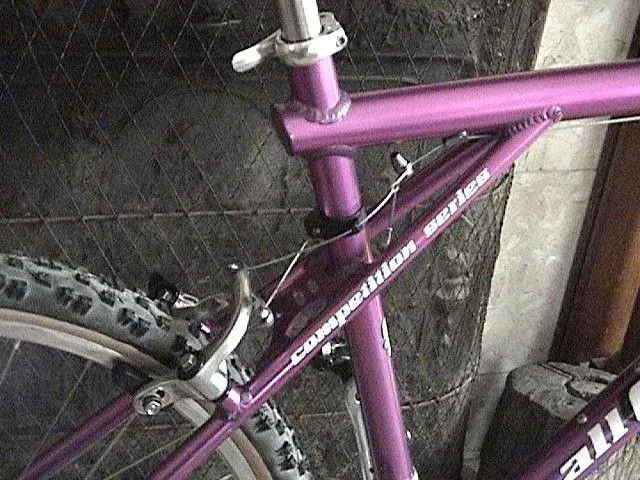

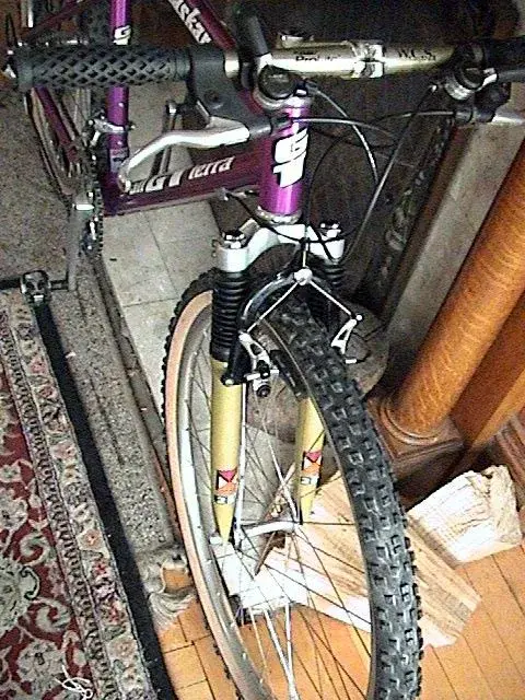

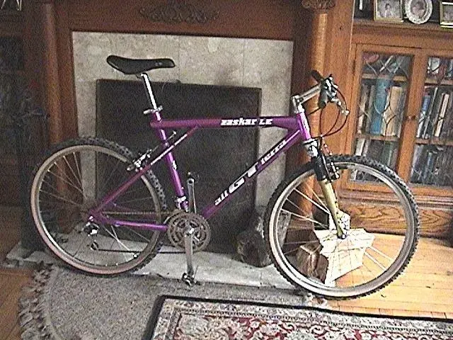

Built in June of 92 18" frame....so u-brake in the rear....this frame was in one of the first batches to get anodized at GT. Anodized Zaskar LE frames first showed up in a GT catalog in 1993 which was the year they switched to cantilever bosses in the rear of all sizes except the 14.5". I'd been sitting on this one for a while...wanted to get it built up earlier...back when purple was the BOTM competition. I worked for a while back and forth with Gil getting the 1993 decals dialed in for this frame as there haven't been any original GT decals available for 1993 for over a year. Pretty simple build on this one.
Frame: 18" Zaskar LE 6061-T6 Alcoa aluminum
Fork: Rock Shox Mag21
Headset: Chris King Nothreadset silver
Stem: Tioga polished
Handlebar: Rtichey WSC Pro-Lite
Grips: NOS GT/A'ME anatomical
Crank: GT Billet CNC 175mm w/SG-X 48/36/24 rings
BB: GT titanium 73x116
Derailleurs: Shimano M735 Front and Rear
Shifters: Shimano Deore XT 7 speed (using the 8th click on this application)
Cassette: Shimano XTR M900 11-32T
Chain: Shimano CN-HG90
Hubs: F/R Shimano XTR HB/FH-M900 32 hole
Rims: Ukai 26x1.5
Tires: NOS IRC Mythos
Seat Post: GT/Kalloy
Saddle: NOS Bontrager Velo Ti Perforated
Seat Clamp: Salsa QR
Pedals: Shimano PD-M535
I finished up a red one last week and have a green frame in the stand right now. More coming!

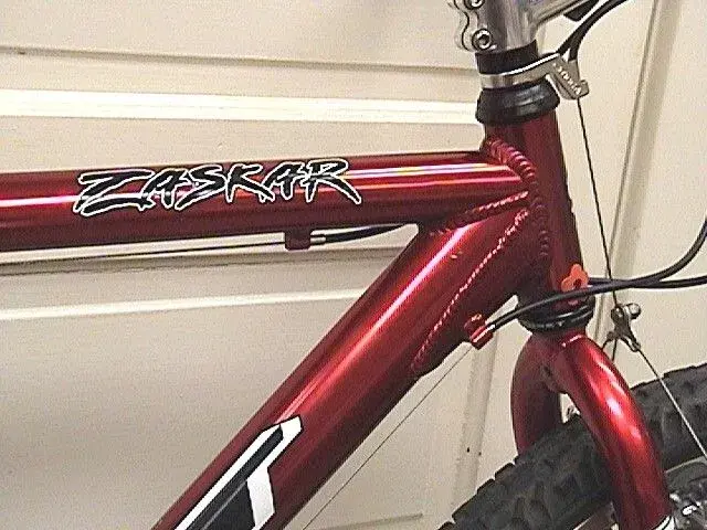

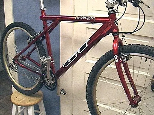

The red build...early 96 frame
Fork: GT Bologna lite (Candy Red paint from a Backwoods AMAZING! match to the red ano)
Headset: Tioga Alchemy
Stem: Comtrol Tech Polished 120mm
Bar: GT alloy
Grips: NOS GT/A'ME anatomicals
Brake Levers: Ritchey Logic Black/Silver
Brakes: Ritchey Logic Cantilevers Silver
Crank: Shimano Deore XT FC-M737
Derailleurs: Shimano Deore XT RD/FD-M737
Shifter: Shimano Deore XT SL-M739 offers more adjustment
Cassette: Shimano Deore XT CS-HG93 8 spd
Wheels: NOS Mavic 217's in Gold with GT/Hadley red anodized hubs, DT DB spokes
Tires: Panaracer Smoke and Dart 2.1
Post: Ritchey Nitto 27.0mm
Saddle: Vetta SL Manganese rails
Seat Clamp: Critical Racing CNC silver
