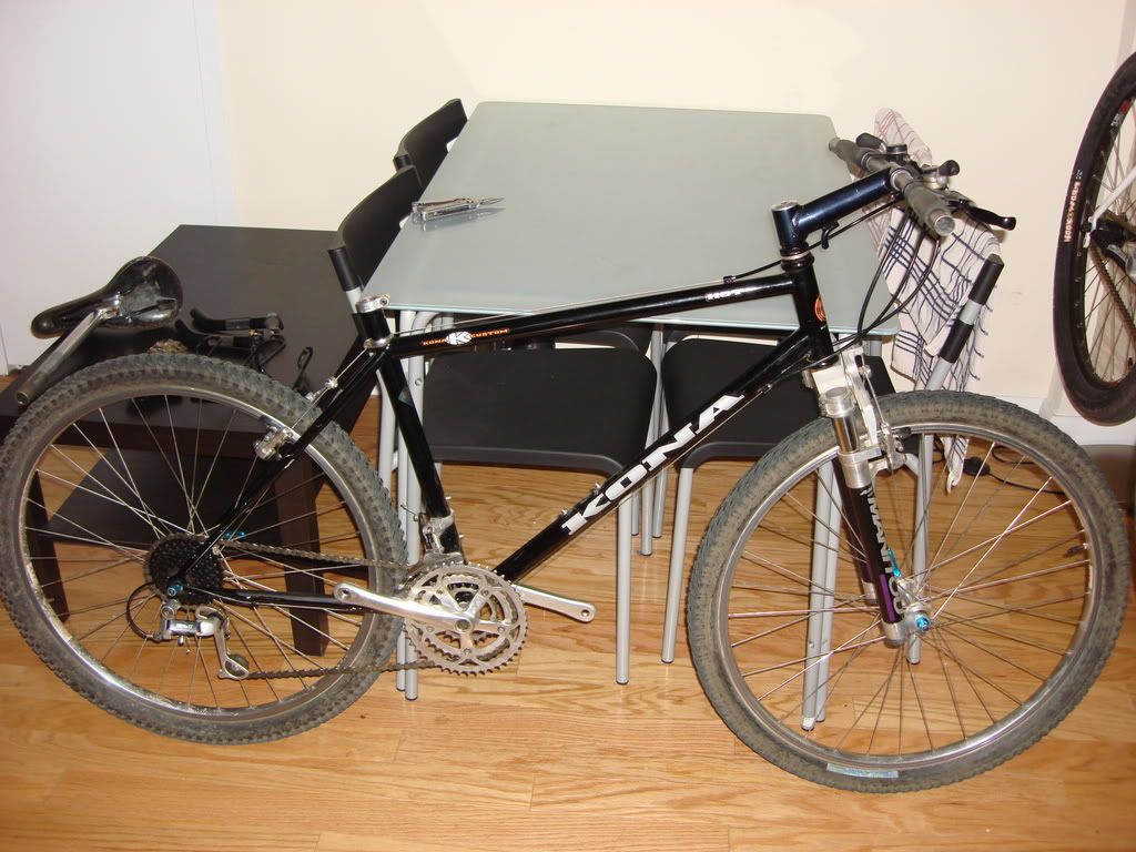

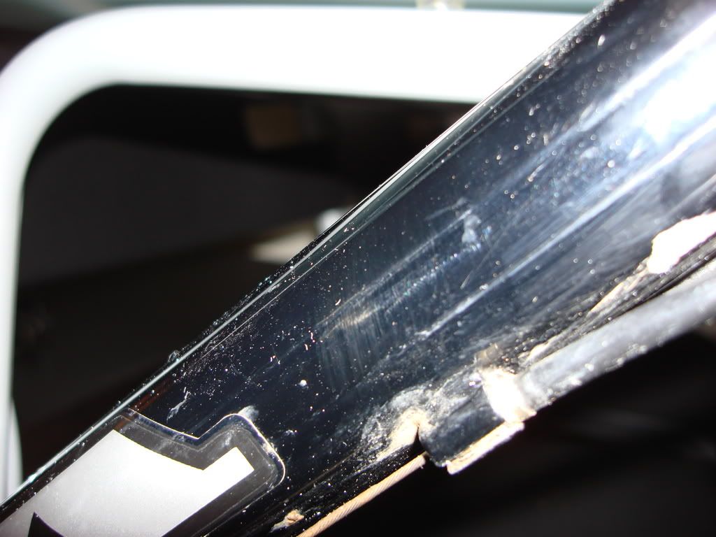

After waiting patiently for 2 weeks the Kona Hot that I bought from eBay finally made its journey from west coast to east. I quickly unpacked it and built it up, sat astride it for fit (was worried it would be too big, but there is just enough clearance with the top tube) and then started to see what was what component wise. It's a little dirty, but here are some initial pictures.
the all important down tube
the important stickers!

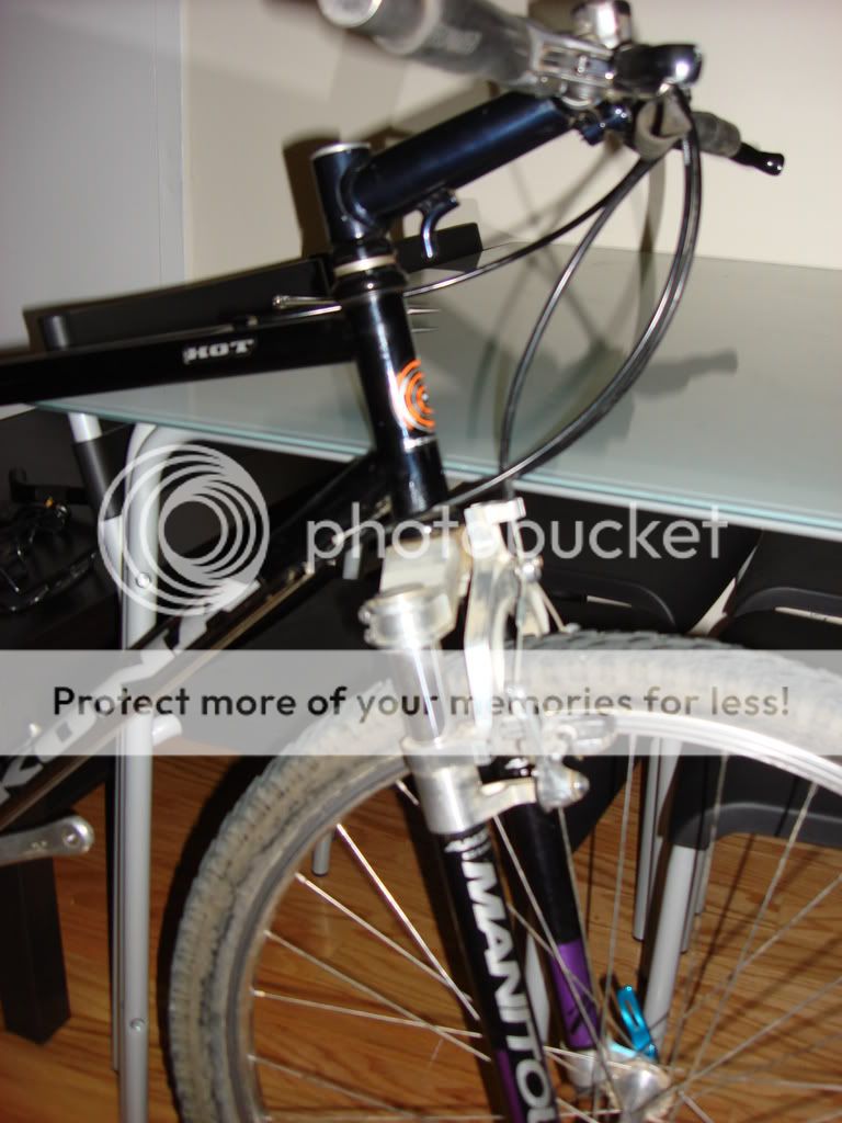

The first thing to go be all the Specialized kit that the previous owner threw onto it (saddle, seat post, cranks, rings, grips, rims). Next will be the 150mm stem. Way too long for me and I'll probably replace with something about 100mm. Not too keen on the Manitou 2's either. They seem exceptionally stiff (about 10mm travel when pushing down on them). The rest of the kit seems to be Deore XT from 93. Not sure what to do with this as some looks ok, whilst other bits seem tatty. Oh and I think it has some Ti bars, but not sure.
So, generally very happy with it. Looking forward to the build, but cash flow will mean it make take some time. Also I'm not 100% sure which direction to go with it. I'm almost certainly going to send it off to Tom Teasdale for a respray and get fresh decals put on. Possibly going to fit Magura's too, but not sure...
Any feedback/idea's/comments welcomed!

That looks in pretty good condition. Personally I'd keep that paint, even though black wouldn't have been my first choice. A Hot is only half a Hot once it loses its original paint IMPO. A clean and polish with auto wax would be the first thing I'd do.
The choice of forks would be the important decision, but I guess it depends on what you want to use the bike for. Bear in mind though that as it has the 94 geometry, that geometry stayed the same for many years from 94 onwards, so you aren't restricted to period-correct forks from a dynamics point of view. Something classy-looking from White Brothers would be nice.

The paint work is in better condition than I expected and I think you are right, a good clean and polish will have it looking nice and tidy. I still think I would like to get it resprayed eventuallyjust to get it pristine looking. If I get it done by Tom Teasdale does it then mean that it doesnt lose its originality? ;)
Also, some of the decals are scratched and peeling away in places so I'd like to get them reset and possibly laquered over.

Those Manitous are sitting way too low, your elastomers have probably rotted to mush. That's why the thing is firma nd low on travel.

I think a 100mm fork would be a bridge too far for the geometry of the frame. They're really designed for a 63mm fork, but 80mm is ok. With an earlyish SID, you can switch between 63mm and 80mm according to taste of course.
