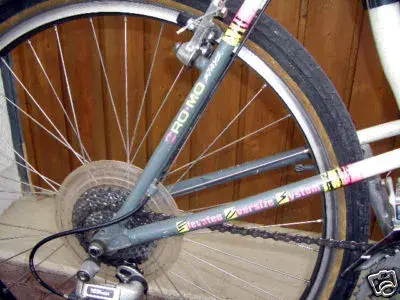

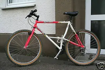

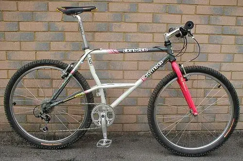

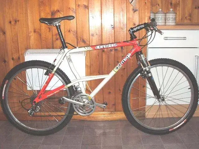

A few pics i've nicked off the web at various points. Might give you an idea of original spec etc.

They are mechs with removable bands. Built for 1 1/4" seat tubes on conventional bikes. You remove the band and the short band bolt and replace with the longer alpinestars bolt and ovalised grip nut. Here's a pic to demonstrate.
