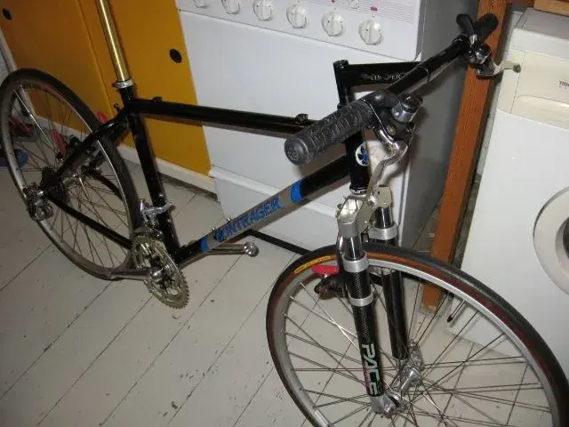

Seized the opportunity to quickly assemble the bits i've been hoarding for the race lite whilst the missus was out shopping with her mum :twisted: I bought the frame a few months back, it could do with a respray and needs a bit of a reweld at the seat clamp (eventually) but thought I could use it as a bit of a light rider/commuter in the meantime, i'll probably rattle can any real bits of missing paint for now and pray it don't break :wink: .
Note that I don't plan to ride it with the seatpost sooo high, just shoved it in a bit for the pic! It's a pretty standard (ish) build and I wanted to keep it a bit stealth like.. I plan to ditch the road tyres(as soon as I decide what to fit), will strip the anodising on the seatpost most likely and maybe get the forks serviced if i'm feeling flush :wink:
Frame: Bontrager Race Lite
Fork: Pace RC35
Headset: XT threaded
Stem: Bontrager bar stem combo
Handlebar: Clue above
Grips: Yeti Speed Grips
Brakes: Deore XT low profile cantis
Brake Levers: Diacompe SS7
Shifters: XT thumbies
Front Derailleur: Deore DX
Rear Derailleur: Deore XT short cage
Derailleur Cables: Shimano Deore
Cassette: Deore XT 12-28
Chain: Deore XT
Cranks: Cook Brothers RSR
Chainrings: Pace and Middleburn granny
Bottom Bracket: White industries Ti
Pedals: Probably my DMR flats (fitted to 4 bikes and counting)
Hub Skewers: Ringle
Rims: Mavic M231
Hubs: Deore XT
Tyres: Still thinking..
Saddle: Flite Ti
Seatpost: USE
Seatpost Binder: Hope
Weight: Lighter than my lady, heavier than my nephew

Mynchiboys seatpost being delivered yesterday:
:wink:
Very nice build already mind!

I knew that I should've lowered it a bit! My good lady has been making fun of me already, she knows that I'm a short arse aspiring to be 6 foot 5 :oops:

Other than the saddle height it's looking good :D

My gawd... it's an ejector seat! Nice frame.

is it a race lite? the head tube doesn;t look relieved.

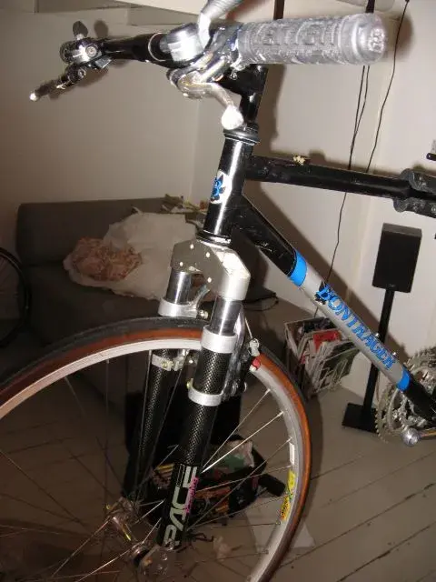

Is it me or is the crown the wrong way round? :?

Looks it doesn't it, bolt heads should be on the front rather than back.

Good point guys, to be honest I wondered myself but the fork was fitted the same way on a bike I bought for parts. Personally I quite like the way it looks, suits my character :oops:
Thanks for the comments so far by the way, I knew I should have fitted the seatpost properly before taking the pictures :lol:
