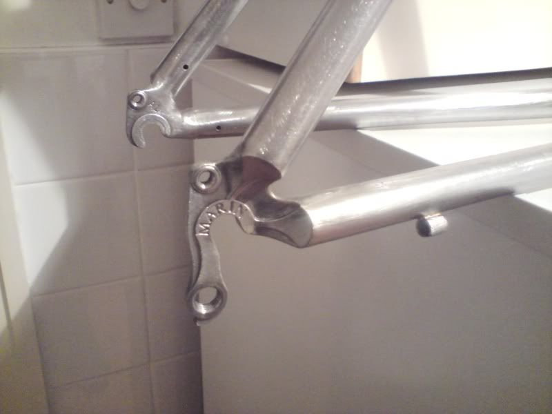

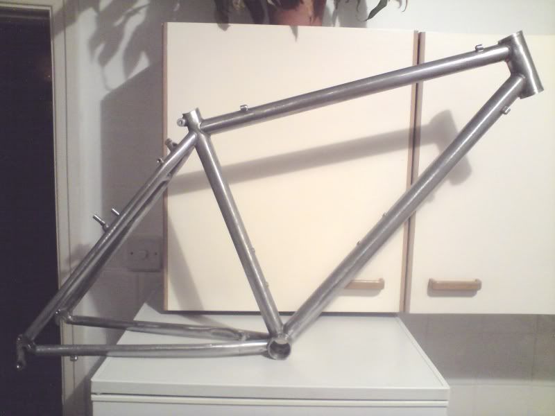

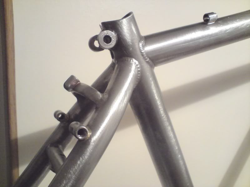

Stripped all the paint off the frame today and the rubbed down the surface rust.
A horrible job. I wish I'd taken it down the road to the metal stripper now.
I will etch prime it in the morning, and then get the first coat of White on.
I'm undecided yet, whether to have Black or White forks.
I did get a bit worried at one point as I noticed a big gash in the chainstay, but luckily it hadn't gone through. Saved me a repair, but highlighted that you never know what lurks below the painted surface.
I was actually amazed to see so much surface rust, that would have just gone worse, had I not chosen to strip and restore it.
I thought about removing the canti stop bridge as I will run V-brakes, but realised that it's a lot of work for aesthetics only. The pannier mounts were always going to stay, as I will need to fit one at some point, due to the kit required for long distance rides.
PostPosted: Mon Dec 01, 2008 7:21 pm
Joined: Sun Aug 10, 2008 3:13 pm
Posts: 3098
Location: on the trail
thats looking better
will it be paint or polish when done??
rob
PostPosted: Mon Dec 01, 2008 7:24 pm
Deputy National AEC
Deputy National AEC
Joined: Wed Jun 04, 2008 4:43 pm
Posts: 5178
Location: Cumbria, England.
Crikey, I can appreciate how much effort has gone into this so far. I think it will make a cracking long distance bike.
Should look great in white, i'd go for black forks with a black stem, always like that look. I would put the effort in now though to remove the canti hanger, once painted you'll always look at it and wish you'd removed it and for what, half an hours graft, go on get the hacksaw out and say goodbye.
Keep the updates coming.
PostPosted: Mon Dec 01, 2008 7:55 pm
Joined: Sun Nov 02, 2008 12:03 pm
Posts: 394
Location: Scotland
Nice work in getting the paint stripped. You've done a cracking job 8) Will look forward to seeing more of this
PostPosted: Tue Dec 02, 2008 12:19 pm
Joined: Tue Oct 09, 2007 1:55 pm
Posts: 8949
Location: New Forest, UK
I'd advise against removing the canti stop bridge as V's can be difficult to get to co-exist with panniers. The rack stays can be just in the way of the noodle.

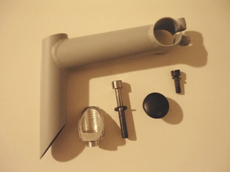

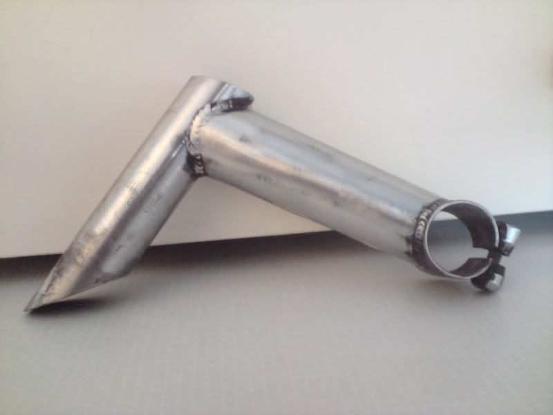

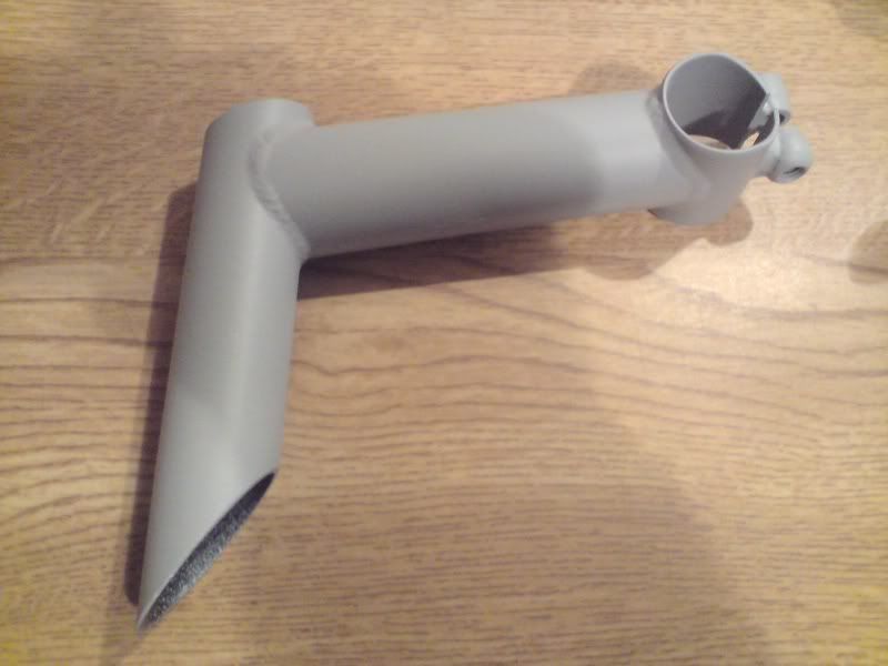

Found time to clean up the stem today.
When I stripped each component down, it was all in fairly good, but grubby condition. As the roller was already broken, I had no problem in removing the canti stop and roller hanger. Took longer than expected actually! I was quite pleased at how light those stems are - less than 200g without the bolts. You can just see the gold brazing on the underneath, before all evidence is covered.
Then a coating of etch primer.

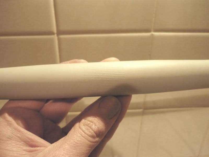

The bars received the same treatment, and they are both now waiting on some black paint.

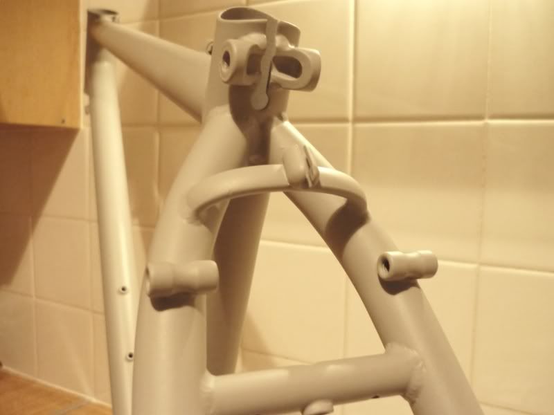

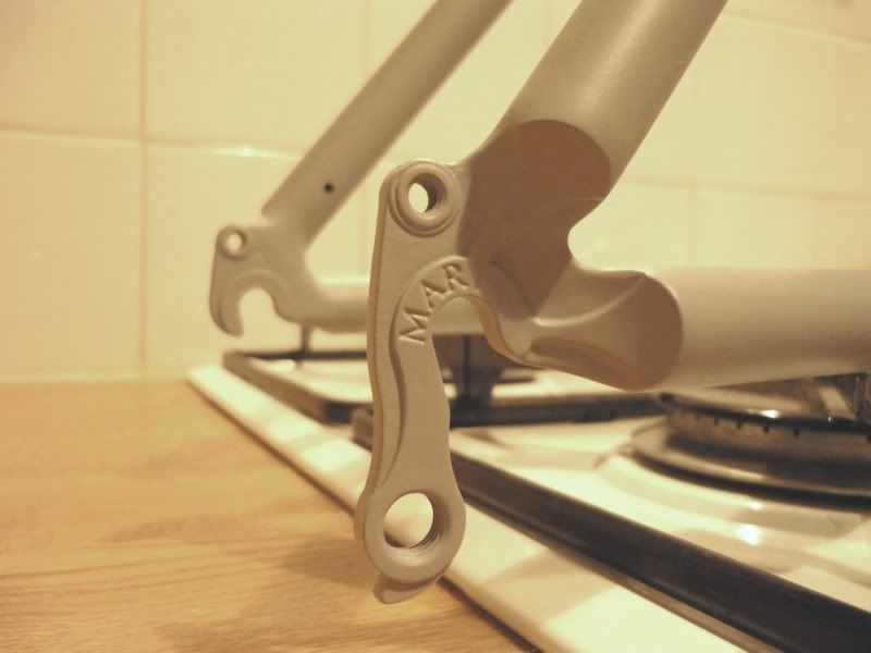

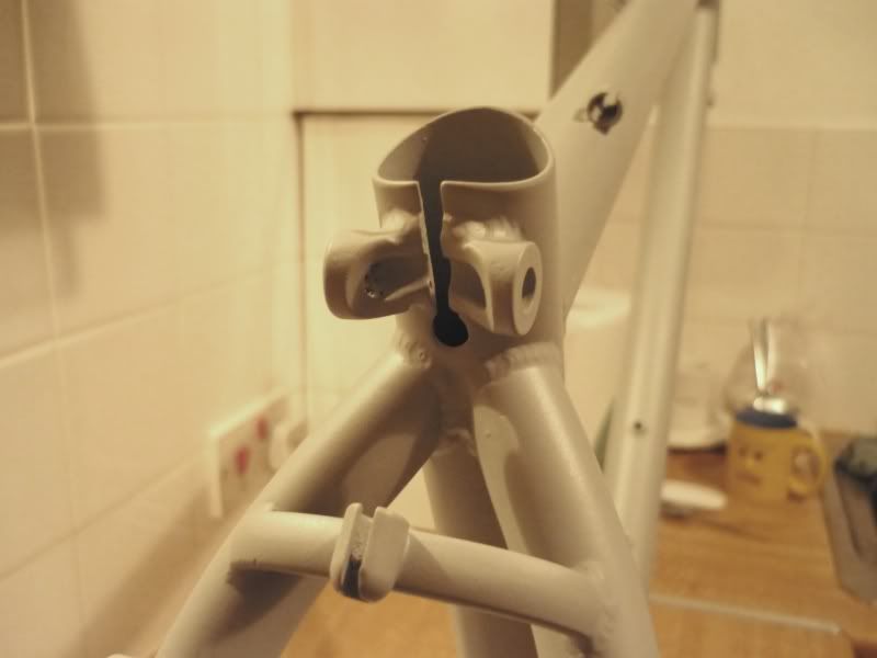

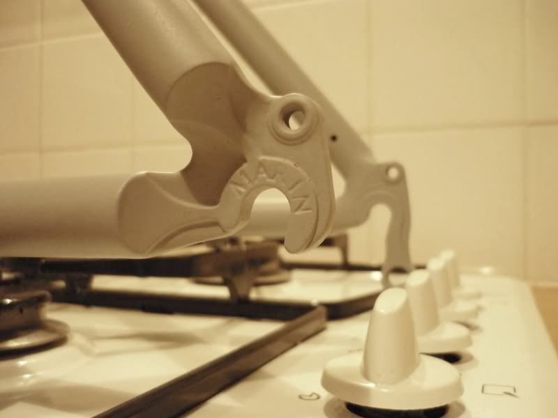

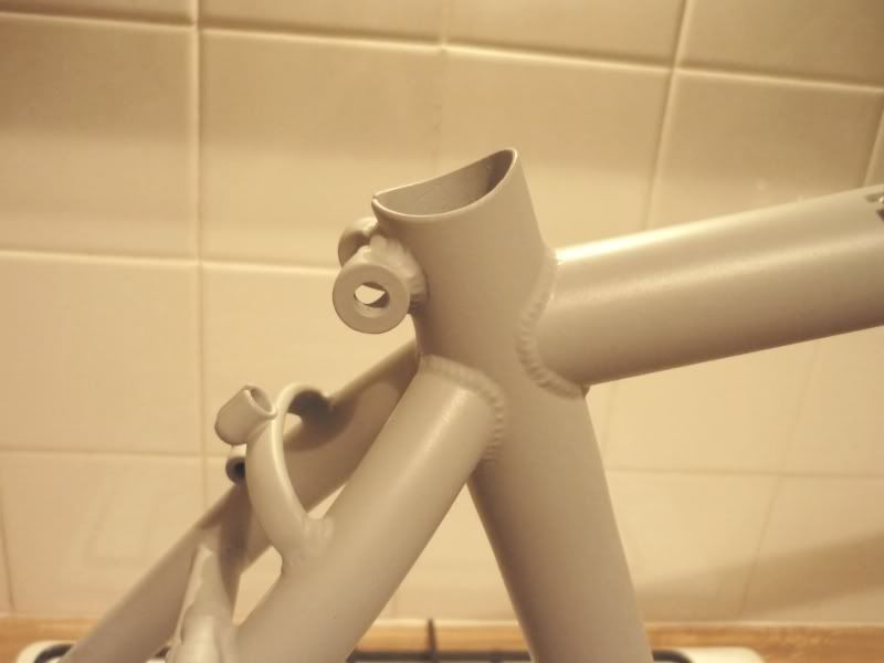

The frame was put outside on the washing line, and a spray with the etch primer again...
It will just need a little rubbing down before the White paint is applied.
Sorry for the quantity of photos, but I feel they give more info than words.
