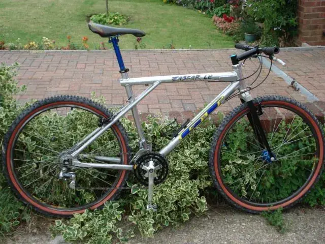

Want to get my decals on asap but dont know what goes where ???
Not even sure the age of the bike ? Think its prob mid nineties !! The decals I have are -
2 Large GT in black and white, about 12" long
2 smaller GT in opposite white and black, around 7" long
2 with ZASKAR LE in black and white around 10" long
The little Rocker Tuned ones which im sure go on the seat stays !!
2 little upright GT decals and the frame material one and a warning sticker ! Pretty sure they go down the bottom of the seat tube ;-)
Any help much much appreciated !!
Derek

Your frame looks to be somewhere between 92-95. Your best bet for decal position is to check out the relevant catalogues in the gallery section under GT. :wink:

Uhm... those Rocker Tuned ones go nowhere as it ain't no RTS I see in the picture ;-)
As far as I know, depending on the year of the bike/decals:
Zaskar LE on the front top-tube (and if they're larger than the GT ones they go on the down-tube).
the big GT All Terra ones should be on the down-tube then I guess.
The warning sticker goes on the bottom-upside of the downtube IIRC.
The little GT ones go on halfway on the seat-tube and one on the front of the head-tube.
The frame material one (7005 or 6061-T6) goes on the bottom of the seat-tube.
And then you should actually have two "Triple Triangle" ones that go on the seat-stays and a "Handmade in the USA" that goes on the chainstay IIRC :?:
Hope it helps... but then again, you could google for some Zaskar pics or have a look at the online catalogs at mtb-unterlagen.de for pics. Pretty sure all the GT info is about there.

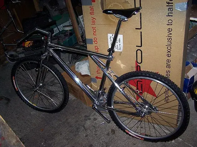

95 decals:

The rocker tuned ones dont want to be going on a Zaskar mate.....they are for an RTS :lol:
