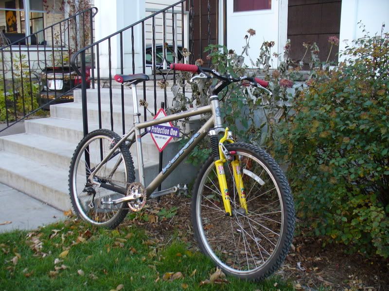

This is what it looked like last summer:

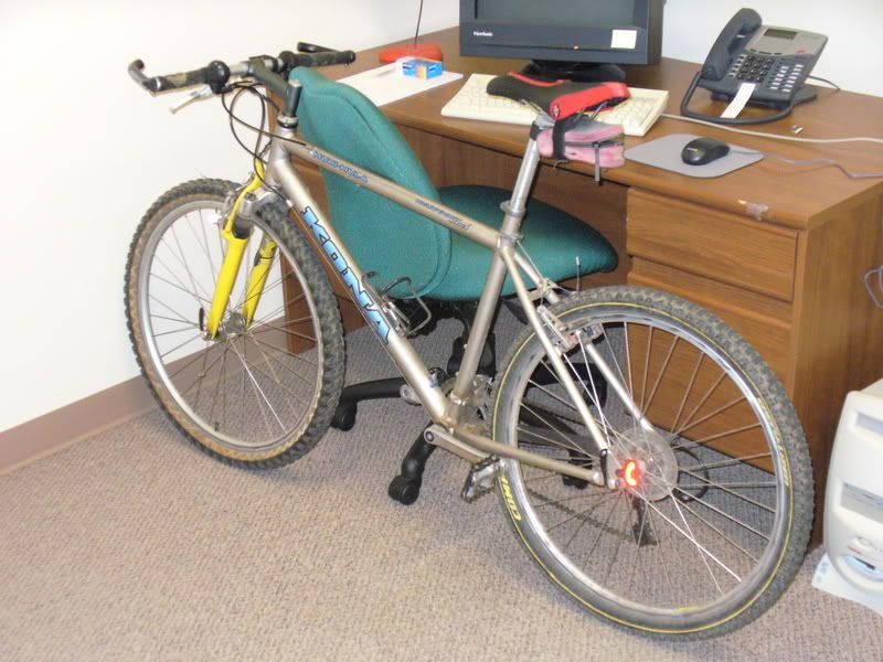

This is what it looked like this morning:
It sat in my basement w/a bent rear wheel for a year until I bought a new wheel and dingled it (sounds dirty) over the past few weeks. It seems to be equal parts utilitarian, ghetto, and totally awesome!
I've ridden it to Theo in the 42-16 combo which is a great road ratio and i've ridden it at Leb w/ the 32-16 which was fine although it showed how out-of-shape I am.
The chain could probably be one link shorter but it didn't come off on me once at Leb so that's not a problem.
As for the bike itself it's a blast to ride! It's too small for me but the stem and bar combo puts me in a great position and the bike is incredibly nimble. I just wish the rider was as well.

I left off the front mech and I don't have any desire to put it back on. As with a previous poster my "home" trail is about 5 miles away so spinning at 100 rpm but traveling at 15 kph isn't terribly intriguing to me. The disadvantage to my setup is having the rear mech attached, having two chainrings, not having a perfect straight chainline in the big ring, and chainslap is still present. None of these problems have proved to be deal-busters yet, however, and the noise from the slightly off chainline is fairly minimal.
I like the setup quite a bit thus far!
