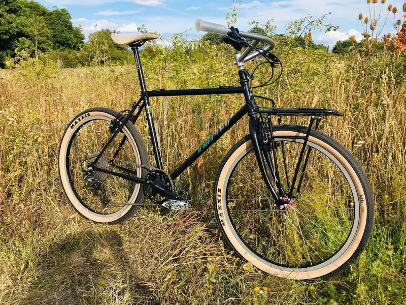

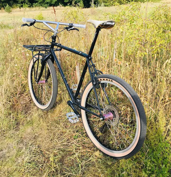

Been building up this 80's British Eagle 531ATB frame I picked up for cheap.
Not the most prestigious of framesets, but hand-built in UK, lugged 531ATB will do for me.
Started out as a beater shopper/dadwagon build but I got a bit carried away during lockdown... Got a Kona P2 fork fork still to fit after I have the steerer extended.

That is excellent work! Looks great and you've got some quality parts on there. 8)
Great first post, too.

Blimey, wasn't expecting that! The pictures took a little while to upload on my desktop, so it was a bit of a surprise.
Cracking build and shows what can be done with a quality old frame, modern parts and some inspiration. Happy dadding around with it :D

Everything Mynchiboy said + I do have to agree you 'DID' get carried away ( How much :facepalm: ) :shock: :lol:

Umpf ...... thats looks really cool

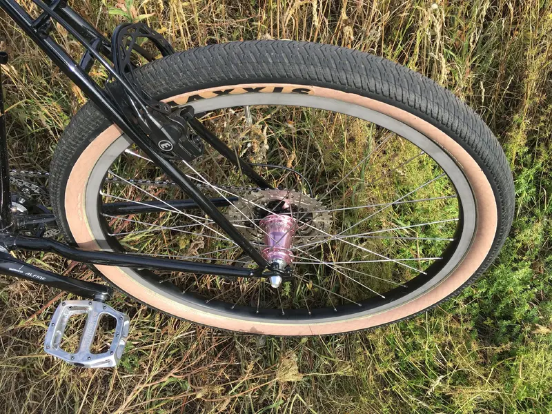

Love it. What’s the drive train set up - 11 speed? Rear cassette sprockets look huge!
10-speed 11-42 Sunrace cassette, 10-speed Shimano XT shifter, 11-speed clutched XT mech as it deals with the 42T cog better than the older 10-speed and the cable pull is the same.
Single narrow-wide chainring up front.
