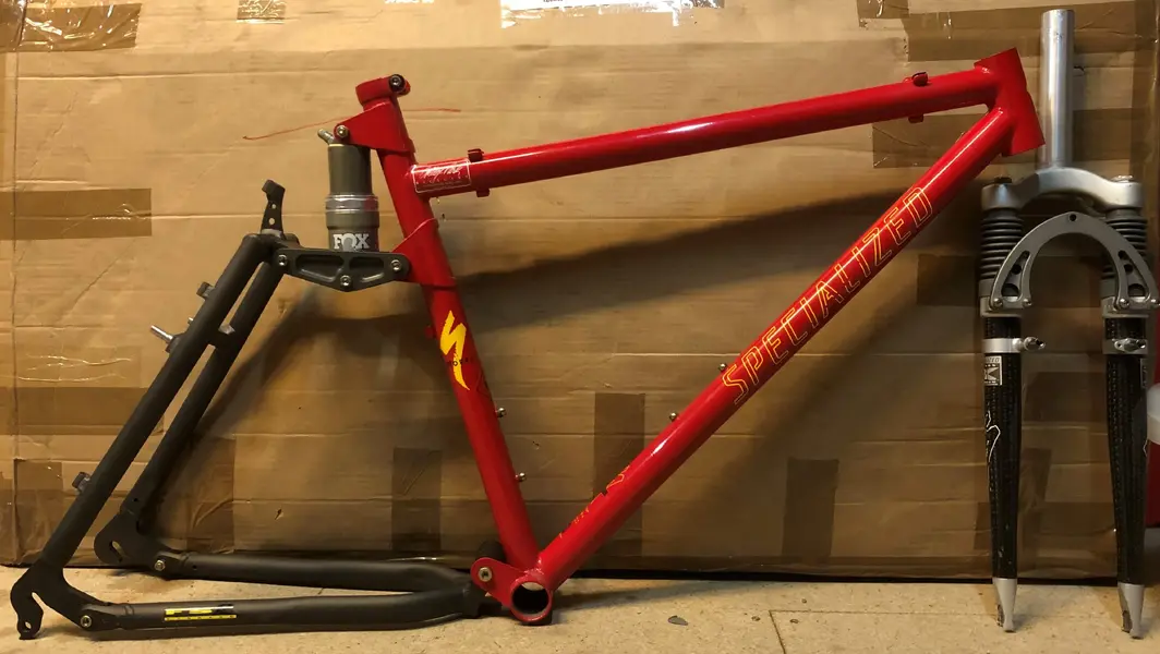

I acquired this NOS frame here recently and it's moving closer to the front of the line to get built. I'm still collecting parts as I'm not sure which way to go with some elements, so I'll have multiple options in some cases. I've also contacted Specialized UK to see if they have an archivist who can tell me what the catalogue spec was - as the '94 S-Works catalogue appears to be illusive. Most of the spec is pretty straight forward and can be seen in some pics in the '95 S-Works catalogue, but it would be good to see/know the original spec.
I believe it's had a few owners on here (jjwood being the previous), and as it shows very few signs of having been built up before (perhaps never fully) I'm trying to find parts that will do it justice.

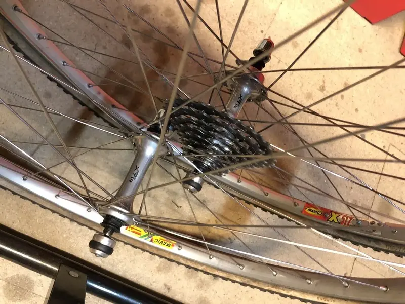

Wheel choice, I currently have these to choose from, and I kind of feel none are 100% right;
XT M737/M738 on 32H Z-21 Pro rims. Correct rims, but could be higher spec hubs.
M910 on 32H Mavic 217 rims. Pretty but hubs a year too new.
M900 on 32H Mavic M231 & X517 rimes. Leading hub choice but mismatched rims.

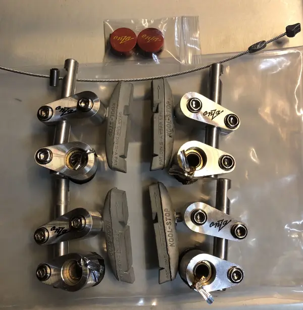

Brake options, I had planned to give this NOS set of OnZa H.O.s a try;
But then a set of Avids came up...
