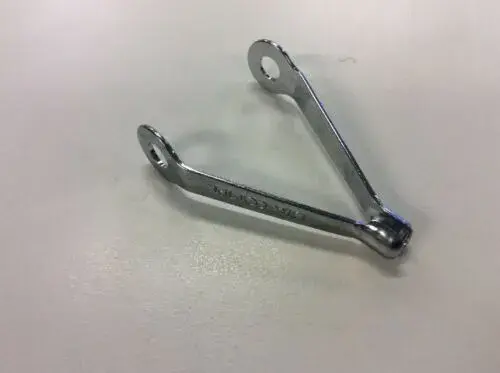

Unusual for this year frame not to have a brazed on canti hanger.
Most, if not all Oranges upto the year of around 96 had the braze on for cantis.
The prestige you have has the brazed on seatclamp bolt fixing, Dia compe has a Rear Brake Hanger, Seatbolt mounted attachment which would solve your problem.

yes it would, thanks for the thought, I think the dia compe one was originally for road bikes, I have something similar off my old carlton I had where back in the 1980s I swapped the old weinmann 730s for some centrepulls, and fortunately I never throw anything away :) but somehow it doesn't look quite right which is why I am keen to see what Orange originally intended on this one back in 1992. I suspect as such a small frame maybe there was less space for the hanger. I'll post a close up pic tomorrow. I've a small Hahanna for the Mrs as well, which didn't have a hanger either, but because someone removed it, but there's no sign of that here.

Sorry dude, not had chance to sort it. Like I said, I’ve had at least 3 Orange’s this size of similar age and all didn’t have a canti mount but each had a different arrangement. This one had a Pace RC35 fork rocker link type fixing which I will take a picture of.

Get a rocker for the brakes, Suntour Power Hanger. Tektro make a version now, don't cost a lot on eBay. 6 quid maybe
