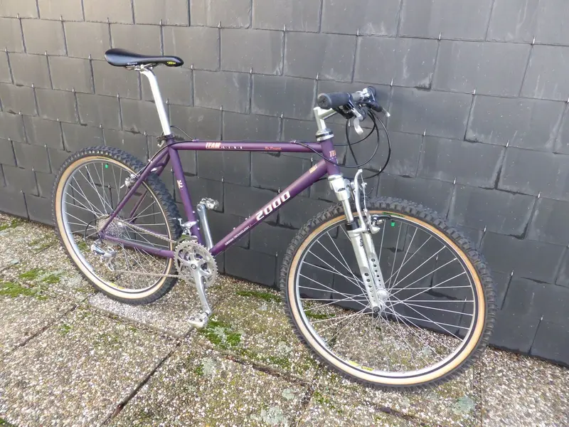

PostPosted: Fri Dec 27, 2019 4:21 pm
Joined: Sat Jul 22, 2017 9:38 pm
Posts: 283

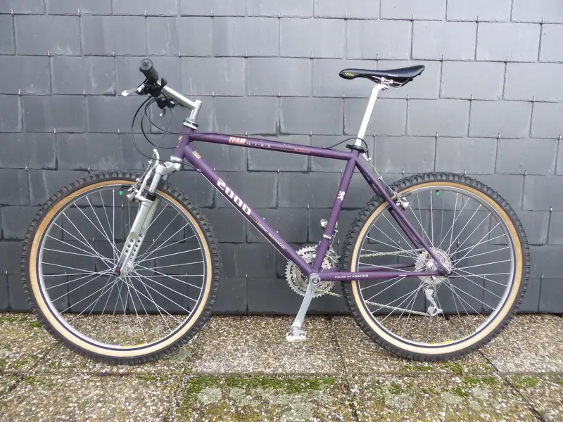

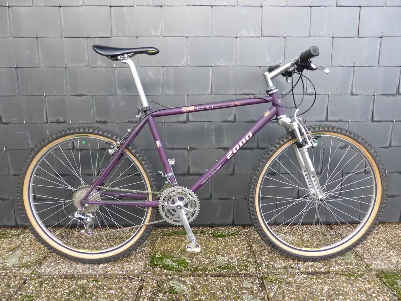

Dear RBers,
Please find in the following posts the autopsy of my 100% catalogue specs (including the tires and inner tubes!) '93 Peugeot Team Line 2000 MTB. As usual, since English is not my mother tongue, feel free to correct my sentences, spelling, grammar, etc. Thanks!
File comment: Peugeot Team Line 2000 - Drive side
File comment: Peugeot Team Line 2000 - Non-drive side
Frame: Peugeot TL2000F3, 46cm size
Fork: Marzocchi XC 400, 1 1/8" (5.5") threaded steerer/crown
Headset: Stronglight X15, 1 1/8"
Stem: Ritchey Force Comp Mountain, 130mm 10° rise
Handlebar: Ritchey ProLite, 560mm
Grips: ProGrip 745 MTB
Barends: N/A
Brakes: Shimano XTR BR-M900
Brake Pads: Shimano XTR BR-M900
Brake Cables: Shimano SLR
Cantilever cable hangers: Shimano A/73
Brake Levers: Shimano XTR ST-M900
Shifters: Shimano XTR ST-M900 Rapidfire Plus
Front Derailleur: Shimano XTR FD-M900, 28.6mm bottom pull
Rear Derailleur: Shimano XTR RD-M900, max/total 32/33 teeth
Derailleur Cables: Shimano SIS
Cassette: Shimano XTR CS-M900, type P 8-speed 12-32 teeth
Chain: Shimano Dura-Ace CN-7401, 108 links
Cranks: Shimano XTR FC-M900, 175mm
Crank Bolts: Shimano XTR FC-M900
Chainrings: Shimano SG-X F-26/36/46
Chainring bolts: Shimano XTR FC-M900
Bottom Bracket: Shimano XTR BB-UN91, 68 x 107mm English thread
Pedals: MKS MXP-110
Hub Skewers: Miche
Rims: Mavic M231 Ceramic, 36 holes
Rim Tapes: Michelin
Hubs: Shimano XTR HB-M900 (front), Shimano XTR FH-M900 (rear), 36 holes
Nipples: ?
Spokes: ?
Tyres: Hutchinson On The Rocks II, 26 x 2.10
Tubes: Hutchinson Butyl
Saddle: Selle Italia Flite, titanium rails
Seatpost: Ritchey Comp Mountain 26.8 x 330mm
Seatpost Binder: Miche
Weight: 12.6kg, including pedals
PostPosted: Fri Dec 27, 2019 4:22 pm
Posts: 283
While chasing my first real MTB (a '92 Peugeot Team Line 1000 "Grisley" stolen in 1997), I stumbled across an ad for the top-of-the-range and rare 2000 model. Though not the bike I was looking for, it was only a few kilometers from me, so I couldn't resist. Even better, it finally appears to have been hardly used. On closer inspection, it even seems to be in original condition, including the tires, with only a few paint chips. All it really needed was a good TLC and service. And also some adjustments to make it 100% catalogue specs: removing the extras (water cage bottle, non-stock barends and computer support), adding the missing clipless pedals and replacing the grips, cut to let the barends fit the handlebar.

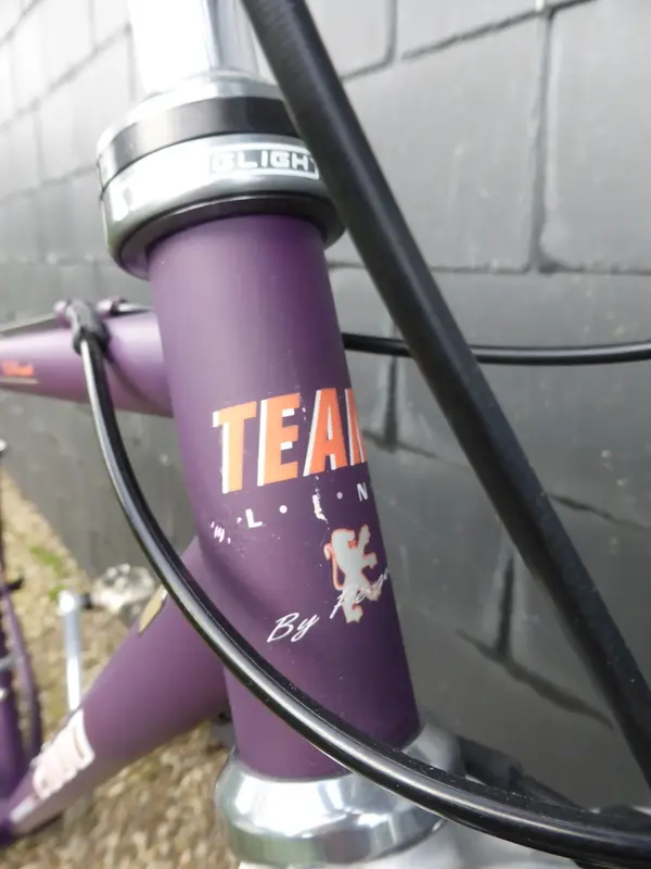

PostPosted: Fri Dec 27, 2019 4:33 pm
Posts: 283

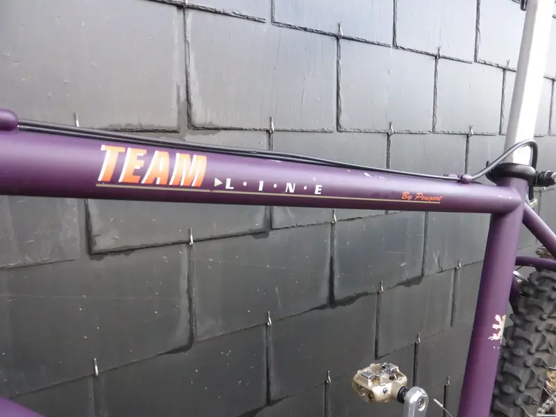

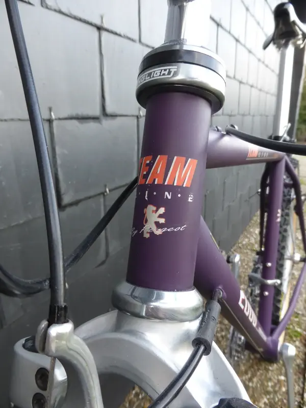

Team Line by Peugeot was somewhat similar to Raleigh's Special Products Division: race-oriented bikes with carefully selected components and competitive prices w.r.t. USA-made equivalents. In 1993, the Team Line range is comprised of the Easton E9 1000 "Grisley", and Columbus Nivacrom 1500 and 2000 models [1]. The pictures in the '93 catalogue however depict the '92 models. You have to look at the '94 catalogue [2] to find pictures of the actual '93 bikes, though the model references and specs are highly folks with a total mismatch between the listed components and pictured bikes.
File comment: Team Line by Peugeot logo - Drive side
File comment: Team Line by Peugeot logo - Non-drive side
File comment: Team Line head badge - Drive side
File comment: Team Line head badge - Non-drive side

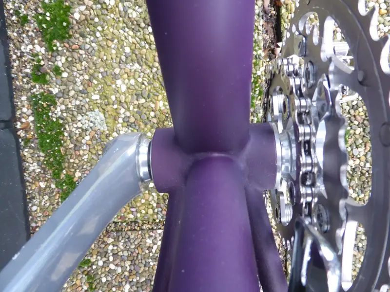

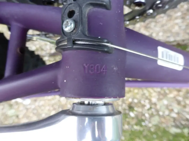

PostPosted: Fri Dec 27, 2019 5:04 pm
Posts: 283

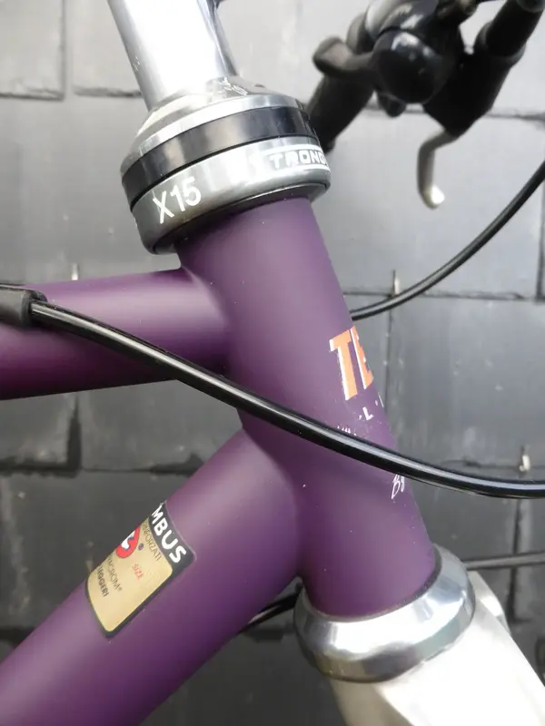

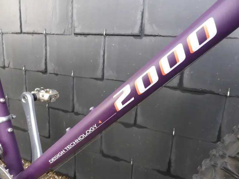

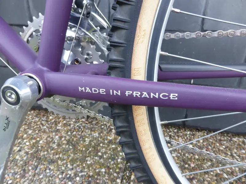

The Team Line 2000 frame was made in France around Columbus reinforced special Nivacrom steel tubeset, dubbed MAX EL by Peugeot in its later catalogues. That is, the frame is built with Columbus OS (OverSize) EL (Extra Leggeri) steel tubeset, except for the down tube that comes from the MAX series, showing oriented ellipsoidal sections at both ends to increase frame stiffness, vertically at the head tube junction and horizontally at the bottom bracket junction.
File comment: Team Line 2000 logo - Non-drive side
File comment: Team Line 2000 logo - Drive side
File comment: Frame ID sticker
File comment: Frame S/N
File comment: Made in France frame :-)
File comment: Columbus Nivacrom OS EL tubeset
File comment: Columbus Nivacrom MAX down tube - Head tube junction
File comment: Columbus Nivacrom MAX down tube - Bottom bracket junction

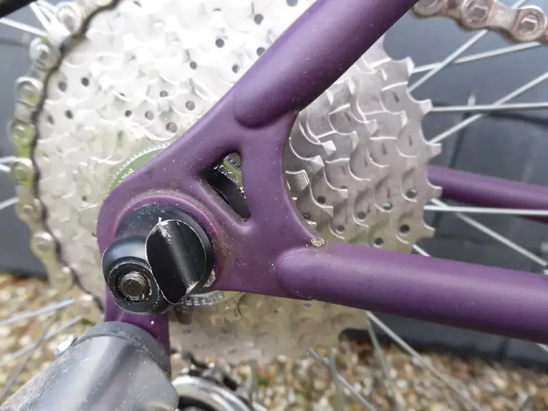

PostPosted: Fri Dec 27, 2019 5:10 pm
Posts: 283

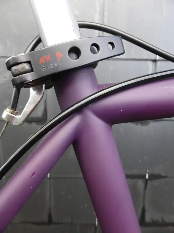

The frame construction is awesome though I was unable to determine the welding process (TIG or fillet-brazed). The "welds" per se are nearly indistinguishable, as in the in-external welding process by MBK/Motobecane and Gitane in the late 80s and early 90s. In some later catalogues, Peugeot makes reference to pulse TIG and cold-brazed frame constructions. It's also highly possible that the manufacturing process evolves around the years, as for the tubeset, since the final incarnation of the Team Line 2000 was built around Columbus Genius rather than MAX EL tubeset.
File comment: TIG? Fillet-brazed? I don't know, but beautiful welds nevertheless
File comment: Drop out details

To my knowledge, the 2000 model was only available in the satin purple livery in 1993. Some paint chips here and there allowed me to see that the frame is in reality painted in purple color with a bright finish and then a satin clear coating is applied above.

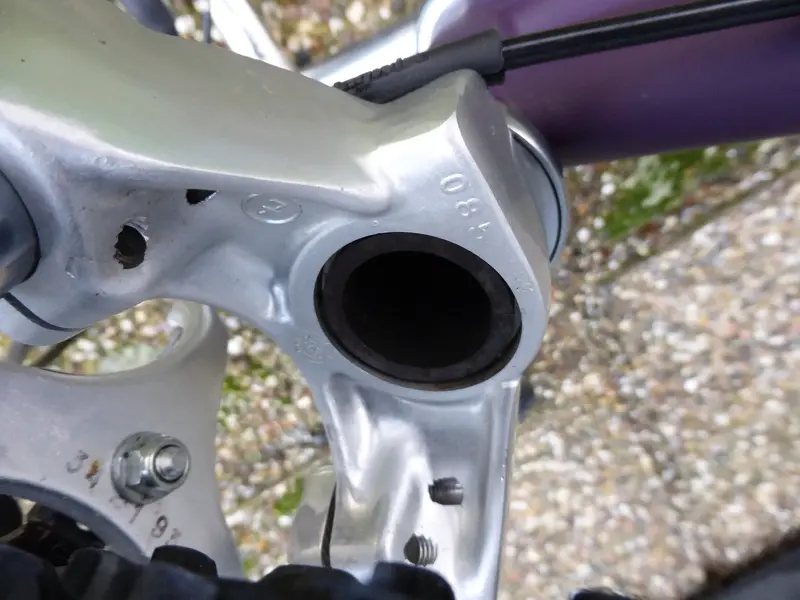

PostPosted: Fri Dec 27, 2019 5:21 pm
Posts: 283
The 2000 model was suspended by a Marzocchi XC 400 air-oil fork providing ~50mm of travel, IIRC. I was a little bit anxious while cleaning the bike, as the left leg was entirely oil-smudged. Much to my surprise, the fork still operates and holds air, with only a minor leak of the right leg.
File comment: Peugeot Team Line 2000 front end - Marzocchi XC 400
File comment: Marzocchi XC 400 crown
File comment: Marzocchi XC 400 crown details

The fork is fitted with a somewhat unusual Stronglight X15 headset with needle bearings.
