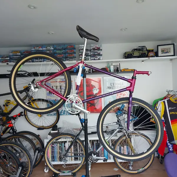

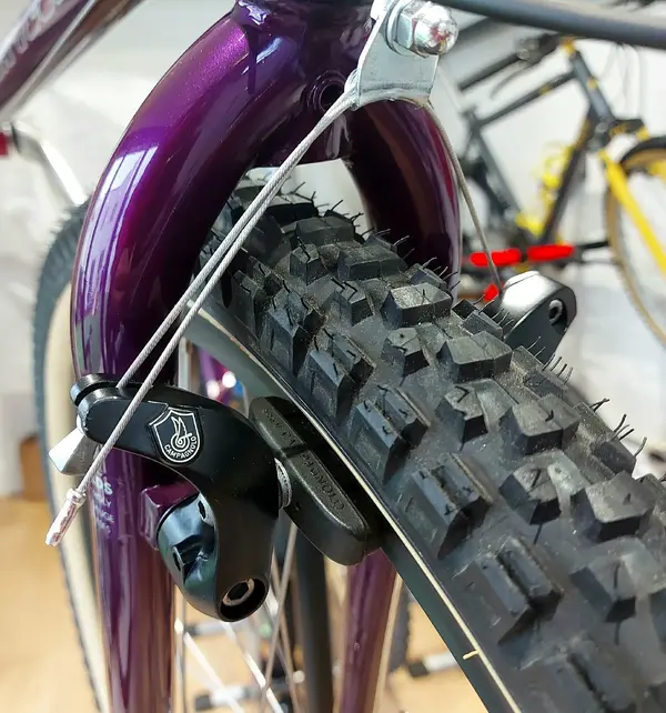

Cheers! There's nothing like reading that copy of MBi / MBUK you remember some 30 years later. I'm fortunate enough to have most of these (other than those in my signature) so when I saw this feature in MBi - it really stood out..... Probably more for it's review to avoid it and go for the lesser Odessey!
I've never seen another here!? - anyone else with a Dynatech Endeavour?

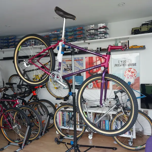

Day 2 update....
The paint goes on. Perfect day for drying outside. :D

PostPosted: Thu Mar 26, 2020 11:28 pm

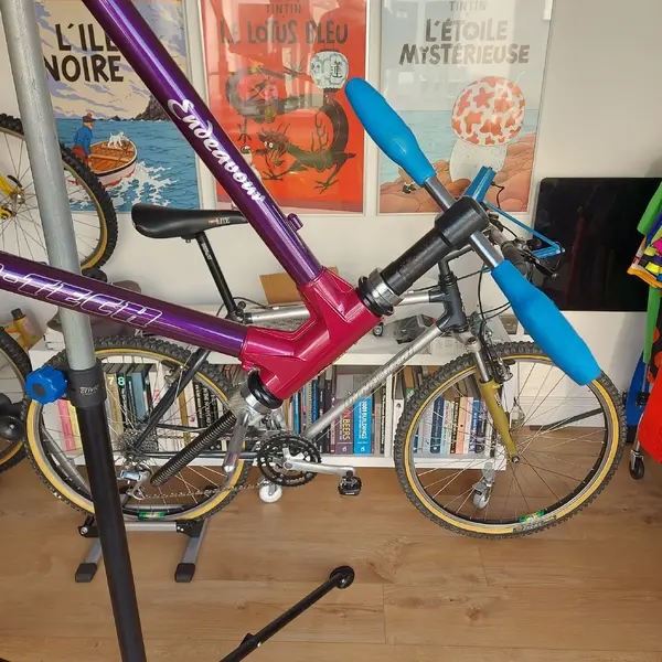

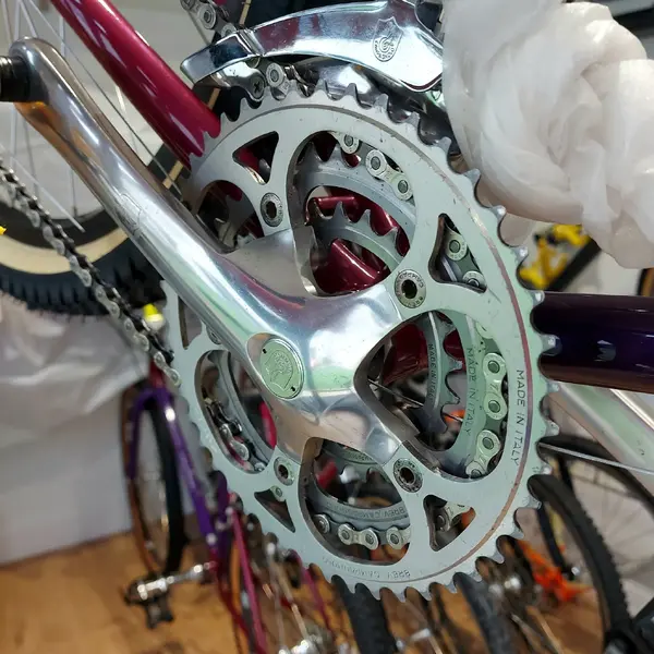

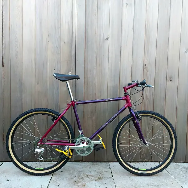

Thanks UZ. Here's the day 3 update.
Base coat of blush went on well.
Scuffed the surface with Scotchbite fine and onto the lacquer coats.
A perfect day for drying outdoors. Going to let this harden out for 7 days now..... But plenty of updates to come to get the Dynatech build ready.
Watch this space....
Cheers.
boy"O"boy

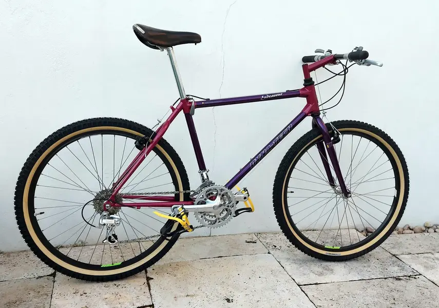

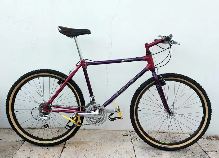

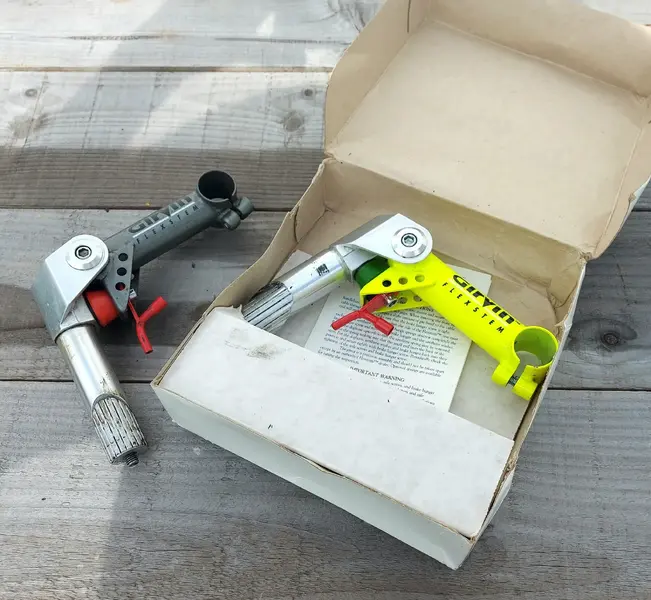

Day 4
Dynatech Endeavour
So, the clear coat/ lacquer has been left to harden for the next week.
The neon yellow flexstem is an essential part of this build. The catalogue pics show the early steel flexstem whereas the MBi review shows it with a later aluminium quill version.
After much deliberation- thanks Minifreak for sourcing me a steel quill version, I've decided to opt for the aluminium quill.
eBay served up a very nice NOS/NIB fluorescent yellow. However, not paying attention to the discription - I had purchased an 1 1/4" type.
Couple of months later, eBay served up another NOS/NIB flexstem- this time in the correct 1 1/8" size, only in black.
Simple solution, just swap over the quills and I've now got the correct 1 1/8" stem with a spare 1 1/4" stem to boot.
Here's some more pics of a fairly easy day waiting for the lacquer to harden.
Cheers.
boy"O"boy

Such a nice colour really pops in the sun light, do you work in a body shop ?
