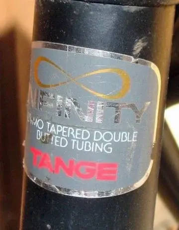

Nice project. If you are re-spraying make sure you carefully remove the Tange Infinity decal and then put it on some double sided tape as they can be hard to come by. :wink:
PostPosted: Wed Jan 02, 2019 9:14 pm
Joined: Mon Jun 19, 2017 7:01 pm
Posts: 1294
Any tips to get it off intact? It's a little rough but it would be good to preserve it. I've actually got a close match repro to put on the frame when it's repainted. There's a possibility Gill will have one by then too & I'd get his if it's a closer match. I'll be getting the main decals from him of course!
1. Make sure it’s warm, hairdryer should do it.
2. As you ease back a corner with a sharp blade, you could try squirting either lighter fluid or white spirit to help soften the old adhesive. When you’ve got it off (lots of patience needed) stick it down flat on some white paper and post it to Gil so he can scan it.

On the one I got repainted I just lifted a corner of the decal the peeled it off. If you need a copy I have a nos one I could scan for you?
