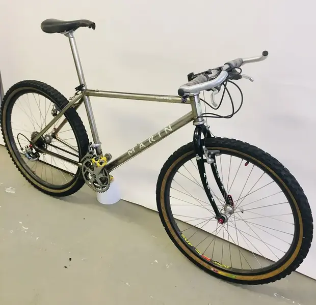

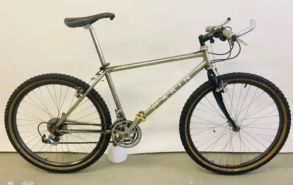

I picked this 92 Team issue up a few months ago. I was really excited to get it as I, like a lot of you possibly, hankered after one of these as a teen. I haven't seen many about apart from mint examples. As you can see this is less than a mint example! Not sure how to proceed with it. I want to keep it pretty stock. I do have the original wheels but the rims aren't great though possibly saveable.
What would you do with it? Ground up resto with a new layer of nickel? Or just polish and clean as much as possible and use as a weather beaten rider? Or split and accept the frame is too far gone? Lots and lots of pitting. Needs a seat post, saddle, correct wheels possibly, grips, XTR shifter pods, decals. Bit of a project! Hoping to get it done over the winter but not sure how to approach it.

Now, restoration. I had a P7 nickel rescue job, had been in a neighbours garden rotting for a year. Rustier than yours - all I did was wire wool it. Came up a treat. Then spray all over with GT85. Done. And that one has been ridden all year sun and rain and just needed a refresh once in a while in places - quick rub and then spray.
This gives you a nice compromise I think. Retained patina so you know it’s a historical bike, and not a rat bike. Better than an expensive full restoration I believe, but other may differ. The person who had the bike before you knew what they were doing - that’s race spec kit on it. I suspect that this bike might have an interesting history. There were not many of them imported.
You have a real piece of mtb history - when designers REALLY began to understand geometry. Marin led then, I think, then lost it.

Getting the frame re-finished will be spendy so I'd only consider that if you picked the bike up for peanuts. Otherwise I'd clean the frame up as well as you can, new decals, tyres and replace the non stock parts with used stock stuff. 8)

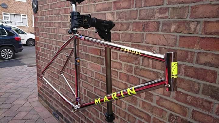

If it was me (but i know it's not) i'd tidy up the frame as best you can and leave the decals as they are and ride the hell out of it. I know of someone who went through a massive restore on one of those including fresh nickel plate and decals and never rides it because it looks too nice which is a shame. Whilst new decals would freshen your bike up, they are not exact replicas and that would spoil it. I have the standard team from 92 and my decals are slightly faded but original and that makes me smile.

The one i mentioned.

the rust isnt as bad as it looks. fine wire wool, autosol and fine wet n dry 1200 -1500 -2000 will have it looking a treat in no time ... well not no time... its quite a job really but well worth doing. seal the polished frame with a decent car wax every couple of months and your laughing !

At the end of the day, it's original, right? And it's only original once.
By all means, take some tin foil, add a squirt of wd40 or GT85 or similar, and work it baby!
But, it's original........embrace it!
