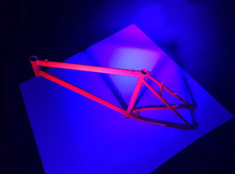

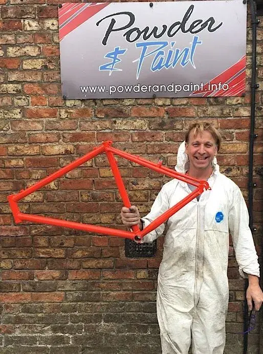

Tamiya TS-36 Fluorescent red, (for general plastics) they come in tiny 100ml cans so quite expensive but easy to spray (although for best results you must have a good white base)
They also do the same colour as PS-20 Fluorescent red for Polycarb. but I'm pretty sure the polycarb paint isnt as UV stable (loads of RC boys moaning about it)
Superb, many thanks. Looking forward to seeing how this comes along

Slow burn I’m afraid... I’ve got a couple of Christmas bikes to build and a house that “needs finishing” or something like that!
