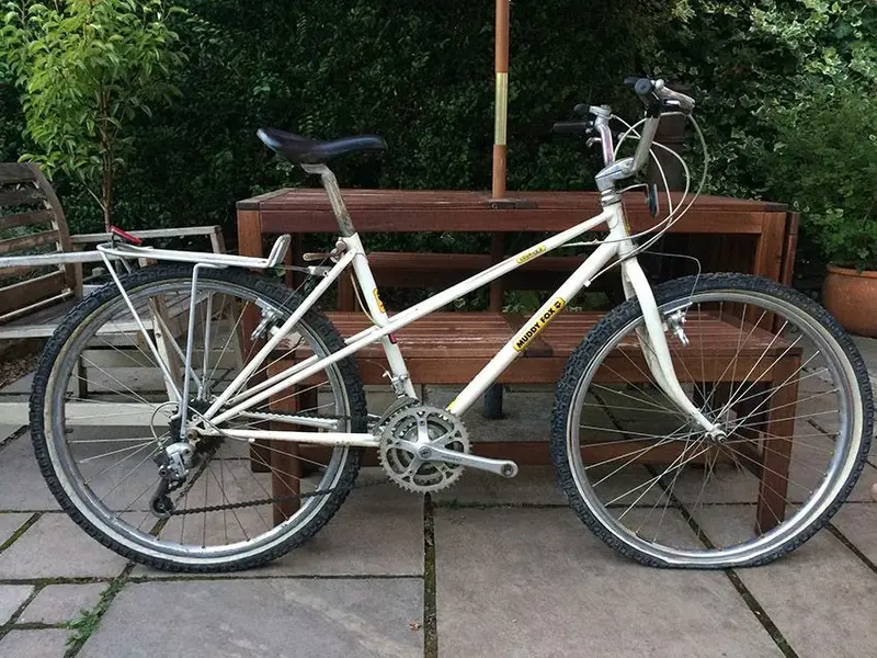

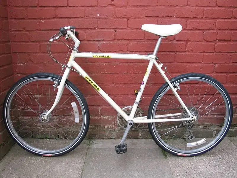

So, I thought I'd try something a bit different for me. A couple of weeks ago I won a nice 1987 Muddy Fox Courier on eBay. It was local and pretty cheap so I thought I'd have a go. It was also original, and I really liked it in a a way I couldn't really articulate. It just felt 'nice'. I got involved in the idea of a restoration. Wire wool, T-cut, Humbrol enamel & Autosol were all lined up on the bench ready to begin...
...and then, my wife saw the Muddy Fox and liked it in the same way as me. I had already found another pretty original MF Courier on eBay as a potential parts supply, but this one was a Mixte framed one. I showed it to my wife and she was sold, so I bid on that too, and won.....
Scene set, a double restoration looms, both bikes are in sound condition, the Mixte framed one is a 1986 model, I'd not had anything so early, my usual territory is early 90's, so this felt like fun.

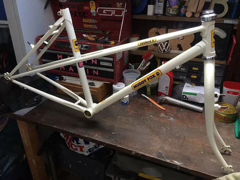

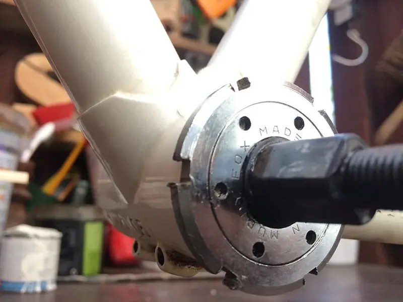

The bikes were stripped, I carefully put all components in separate bags to keep everything together. The frames were t-cutted and polished and touched up with Humbrol Enamel paint. Both BB's were removed (nothing seized on both of them amazingly), and re greased. I really like the attention to detail, the standard Courier has the nice paw print on the seat stay, and the BB spindle and cups have Muddy Fox branding on them. These bikes are growing on me even more.

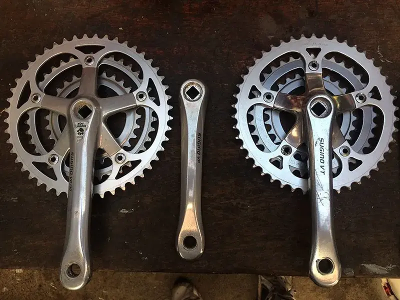

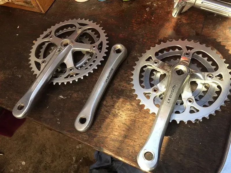

Both cranks were cleaned up at the same time, maybe this is how these builds are going to go, in tandem, so they are finished together....
The chainring bolts are Sugino branded and there are a few that haven't made it, plating has come off, but I've seen a NOS set on ebay, so I might get a set when I get paid.
The rings are smaller than I would normally expect for an early MTB, the standard Courier has 48 tooth large ring, but the Mixte has 46, and the crank is 165mm rather than 170mm on the standard one, and they are different models, VP on the standard bike and VT on the Mixte.
