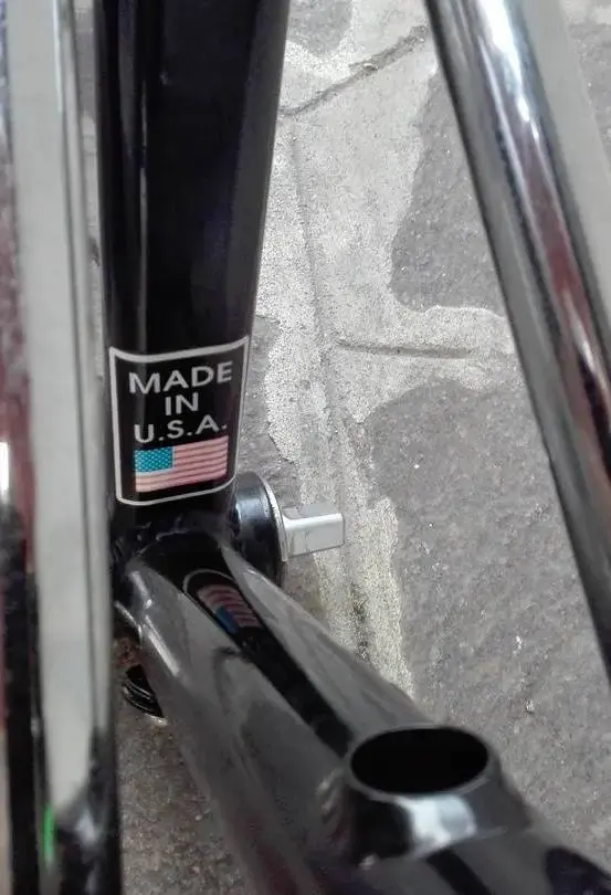

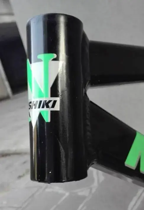

OK...one of my unicorns: 1990/1991? Niskiki Alien ACX:
frameset bought from Valleyman here: http://www.retrobike.co.uk/forum/viewto ... p;t=387664
Unusual in black since all the brochures, ads and reviews show the red version, but original:

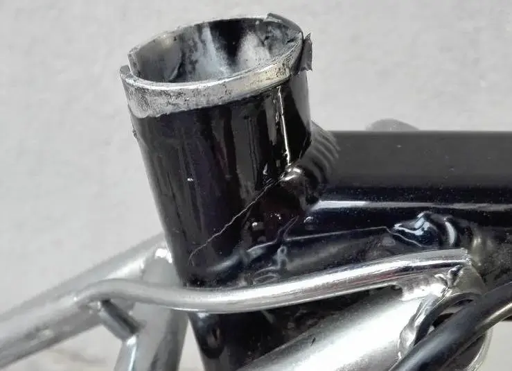

Both the usual Nishiki cracks at the head tube and seat tube, but I plan to replace these tubes.
I don't really want to mess with the BB jonit and the fitting for the rear end, so I'll probably spliced in a section above the chromed rear end:

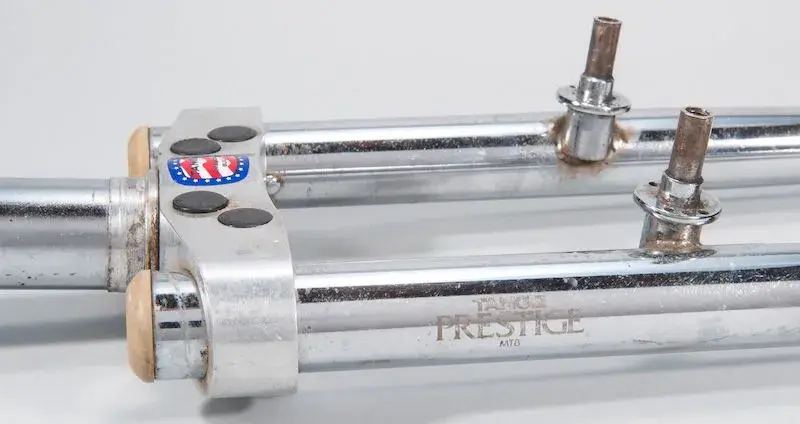

First part bought: the a chrome Tange Prestige Switchblade fork. In need of some TLC, but should come up nice:
