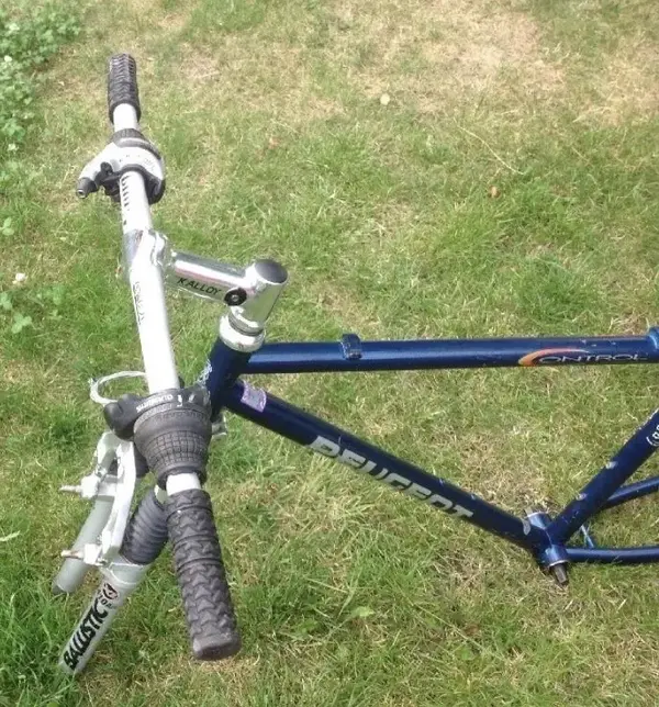

[title now edited for build thread]
Hi,

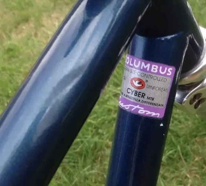

Just bought this hopefully arriving in a few days, no idea what it is, can’t find any details for a “Control” model, or of the tubing is any good....
If the frame is no good, hopefully the stem, bars and seat post are light
The forks are garbage I know already...

Being Colombus Cyber the frame should be decent :D :D :D 8)

Thanks, I couldn’t find any details on “cyber” I wasn’t sure if it was a good tube or not...

From the top with description
Hyperion - ovalized titanium
Metax - butted Nicrmox (non-rusting Steel)
Altec - butted aluminium
Ego - aero section butted Nivacrom (steel)
Nemo - round Nivacrom tubes with 'Zona Butted Concept'(Z.B.C.)
Genius - round Nivacrom tubes with 'Differential Shape Butted'(D.S.B)
Max, Minimax - Oversize ovalized Nivacrom
EL-OS - round oversize butted Nivacrom
Neuron - round Nivacrom with S.D.S (Stress Disrtibution System)
SLX - round butted Nivacrom with helictical internal reinforcements
Cyber - round butted Nivacrom
Brain - round butted Cyclex(steel, lower grade than Nivacrom)
Thoron - round butted Steel 25 Cr Mo 4
Gara, Aelle - round Steel 25 Cr Mo 4
Tandem - oversize ovalized Nivacrom
This was taken from the Columbus tubing catalogue at my LBS

So it’s reasonable...?

Definitely reasonable :D

I heard a very interesting rumour that the frames used by the Peugeot race team in the early 90s were in fact Chas Roberts frames branded up as Peugeot Team frames.

Excuse my ignorance... :) I take it he made good frames? :)
