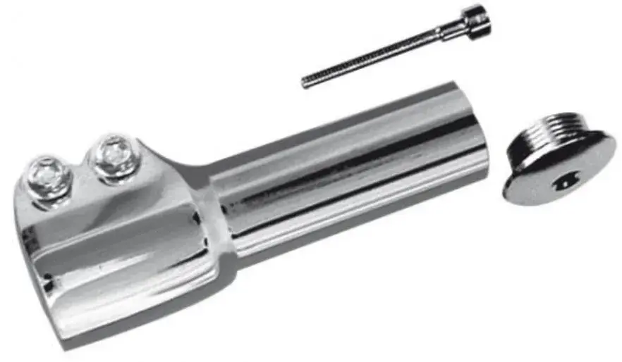

Aheadset with steerer extender ? Threadless 1 1/8.

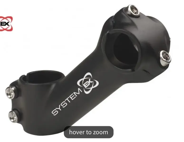

If as above not a real top cap. Take it all off and get a high rise stem and normal type shallower unthreaded cap held by the central bolt. There should be a star nut in the steerer tube that this tightens down onto to prevent a loose headset before tightening the stem (two Allen bolts) onto the steerer.
