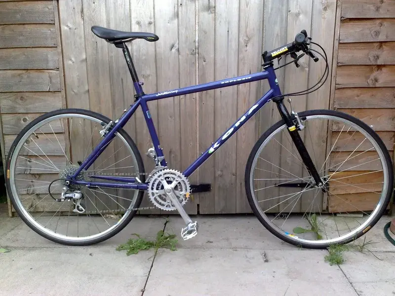

Incidentally if you look at Stew-B's 1991 Explosif below (and recent thread), it disproves something that the 91 Kona catalogue says and opens the possibility of your frame being a 91 Explosif. i.e., it has a braze-on seat clamp (which says 91 and not 92) and it also has rack braze-ons on top of the seat stays (which the Kona catalogue says applies only to lower models in the 91 range). So not the first time that a Kona catalogue turns out to be misleading!

Excellent, that's a 91 Explosif then, and a real bargain.
Apologies for giving wrong advice when you were considering it - as I say, as soon as I saw Stew-b's bike, I thought 'that's not supposed to be there, but at least it means Mr K's got lucky'. But it's not luck, is it? You've either got it or you ain't.
