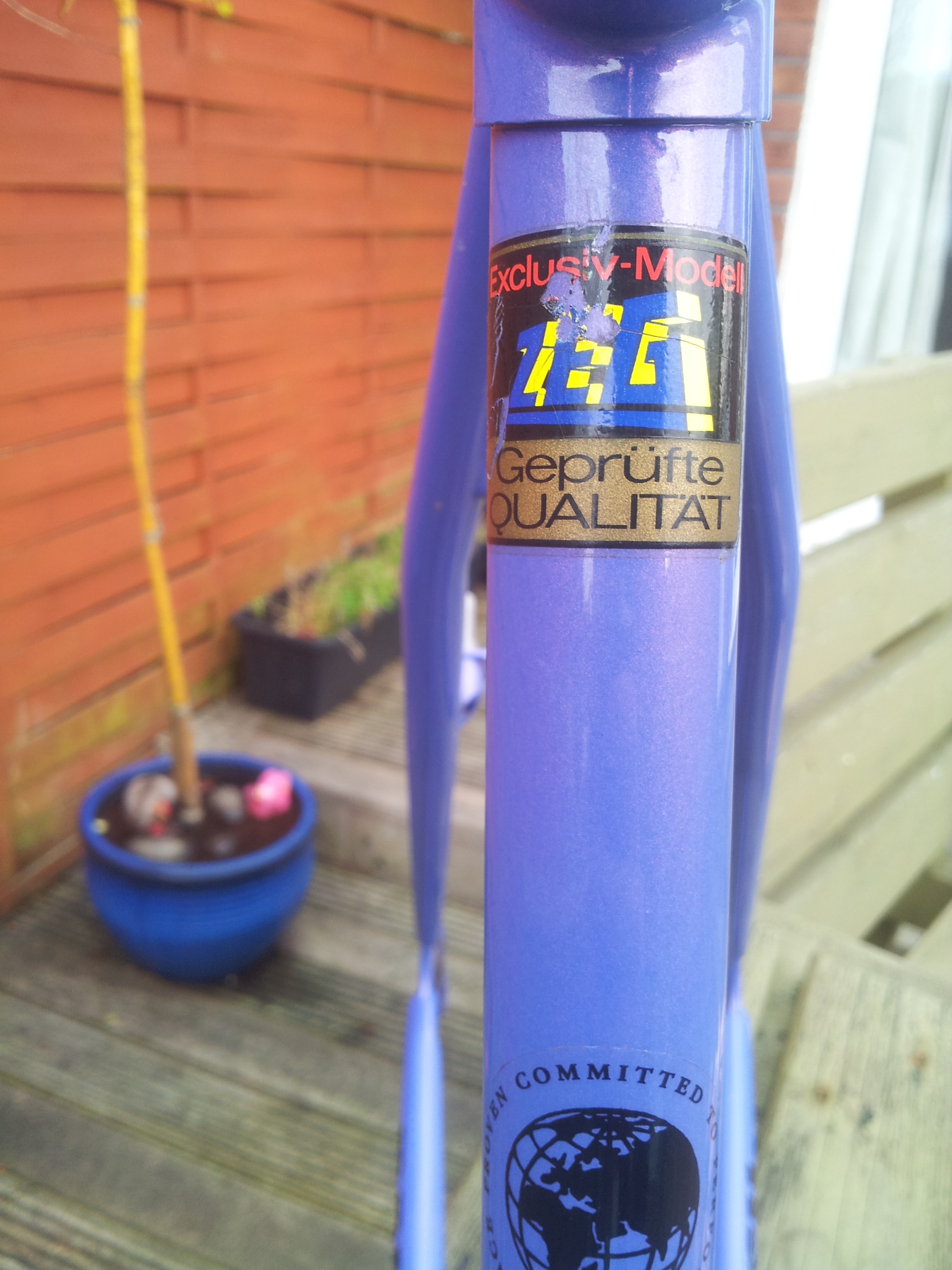

I had an identical Raleigh a few years ago, also with the top tube name decal missing, but I never found out which model it was. The groupset is definitely 1993, based on the low profile black Deore LX cranks with standard chainrings (Shimano's compact chainrings came in from 1994 onwards).
The best match from the 1993 catalogue is the Peak (others had lower groupsets or a suspension fork). Mine had a sticker in German on the seat tube from 'ZEG', a German retailer:
My limited German tells me the sticker says this was an exclusive model to ZEG. From your photo, your looks to have the same sticker.
My guess is the Peak in this colour was produced by Raleigh for ZEG, and some found their way back to the UK market or else got sold off by Raleigh at end of the 1994 season. It would be interesting to know what the German name was, but I guess the name decal was removed (or never applied) when it was sold in the UK.
