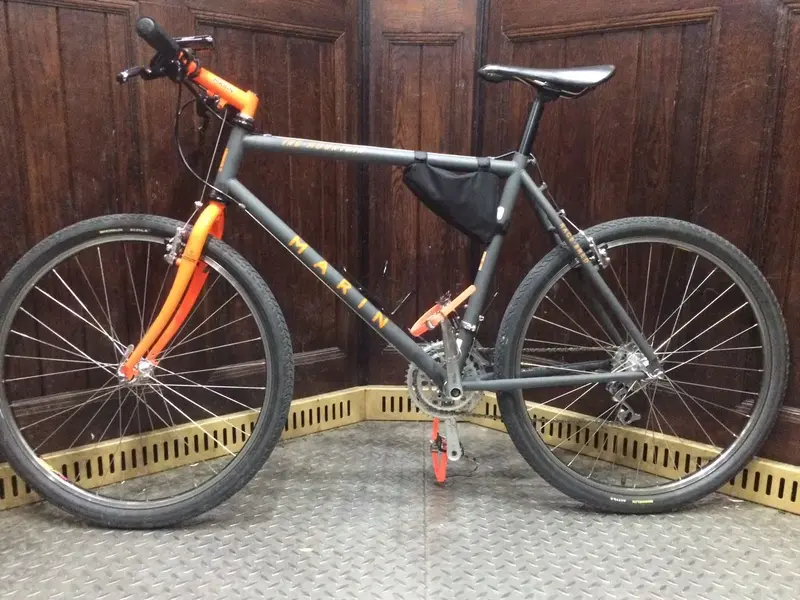

Just seen this project and I love it. How are you getting on? I'm hopefully attaching a pic of my 1991 Pine Mountain which I finished early in July. Mine was in pretty good nic when I got it so nothing like what you've taken on. It rides beautifully so it's worth keeping going. One tip: Gil dis me some great decals but some of them were larger proportions than the originals so worth specifying exact sizes if you're going that route.
