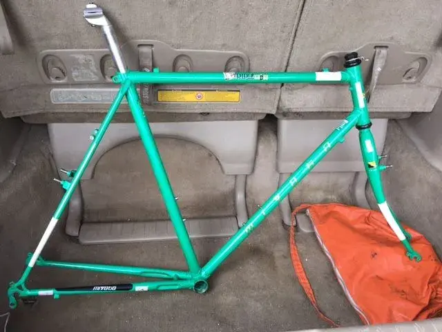

So I bought a 91 Miyata Triple Cross which isn't quite a mountain bike, but I figured it would get more love over here than on the road board which seems focused more on vintage light weights/racing bikes. I've been thinking about converting my commuter (a disc aluminum CX frame) to a steel bike with fat tire capabilities because I like the ride of steel and I'm appreciating these fat light casing road tires more. I was originally thinking of a velo orange disc pass hunter, a Soma fog cutter, a Soma pescador (sp?) or a New Albion privateer frame. I have a 700c p2 fork from my old Kona Dew which was part of my calculations. Anyhow, this frame cam up much cheaper than any of the other alternatives. I recalled hearing very good things about it - many saw it as a nice alternative to a Bridgestone XO. So I took the plunge and bought it (likely paid too much) with the idea that it would be eventually built up rando style with lots of polished bits (possibly vintage). It may also get a new finish as the powerdercoat is in pretty rough shape and I'm not a big fan of the original colour.
First build will likely be a flat/riser bar mountain bikeish build with 9 speed Deore bits I have hanging about to see if I like the ride. If I do then the plans for a paintjob and a more vintage French themed build will take place.
Anyone have a good way of removing that reflective tape without harming the finish?

Thanks. I think its a 91 - I found a catalogue online and its the same colour as the one in that catalogue. It also is missing the canti stop on the frame a characteristic shared with the 91 model. I found a pretty decent condition set of XT mechs in my parts bin so I've mounted them up. Most everything else for the initial build (aside from wheels) is coming from my snow bike. I'll post some pics of the build when its done and give a ride report. I was putting in the bb yesterday and had trouble getting the drive side cup in - I think I may need to get the threads chased (I was worried about that when I inspected the frame at purchase). Bit of a bummer.

Ok, so here is my first build on the Triple Cross. Initially I planned on building it up with some 9 speed modern deore I had on my snow bike/back up commuter. After thinking about the whole fenders and v-brakes issue I decided to go with some Tektro canti's my friend gave me. That lead me to drop bars and a set of 9 speed bar ends I got for that drop bar mountain bike conversion I planned on a Bridgeston MB2 frame two years ago. I was thinking of stripping and painting it, but the green has grown on me over the past months - particularly as I removed the reflective tape (almost all done) and saw it built up with black bits (was planning on silver build originally).
I still want to put on fenders and get some fatter tires on it - 35mm Paselas perhaps? I've been riding it around town and like it. I'm still not sure if I'm really happy with how slack it is up front, but I rotated the bars yesterday and I'm liking it more. So here is the build (as best as I can remember):
