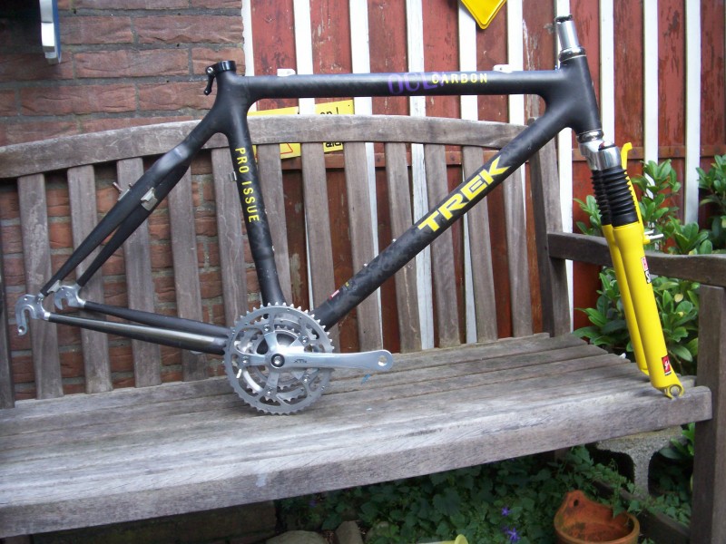

I started only the frame but soon I found a '95 Rock Shox Judy SL in pretty good nick

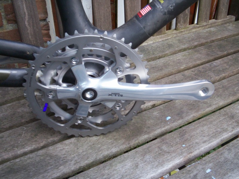

A week ago I fitted the headset and Bottombracket and with that the Crankset so it now looks like this:

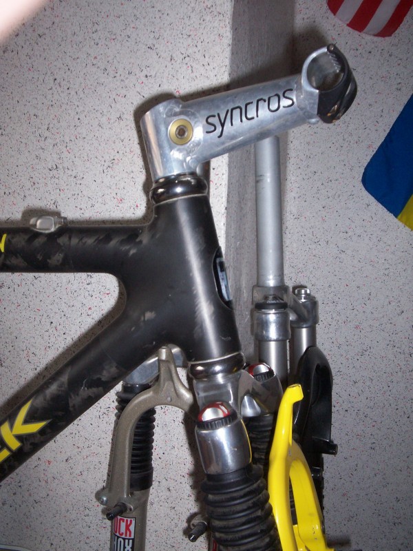

* The Syncros stem is not in a good condition yet, it needs a good polish and new bolts, I already ordered a set of new stickers for it.

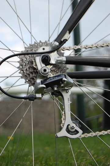

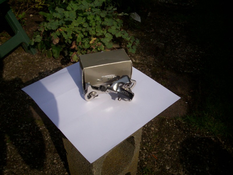

XTR M910 SGS Mech:
XTR M900-A Crankset:

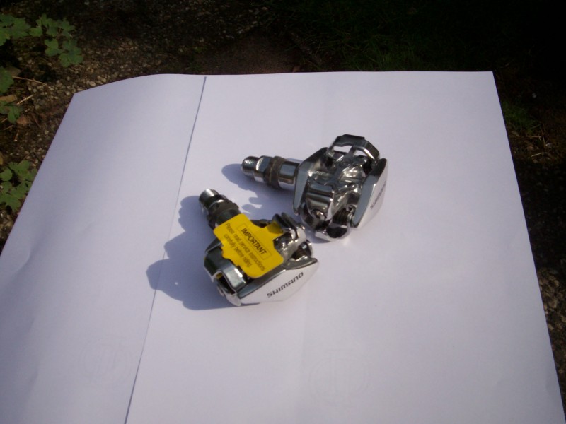

PD-M747:

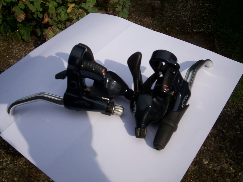

M910 STI:

Yesterday I got my Syncros stem from the States, as stated above it's not in super good nick but with abit of TLC I think it will look great again:

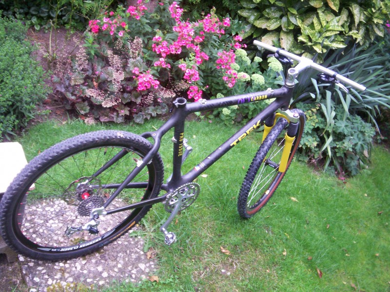

Today I did a little mock-up with the parts that I have (some of them) to see what it's going to look like.
I don't have the rims yet so the wheels are not for this bike (rear is rather logical with the disc on it) The front wheel was the closest I could find to a retro wheel
I did fit the front tire on it to see how it would look and if I got the right size to clear the forks.
total view:
Front:
The pics are not great, the weather wasn't great and well the camera isn't top of the range eighter :lol:

About the NOS XTR parts, I got most of them of Ebay, the STI was from a LBS who had the left one on a shelve behind glass, so I asked if it was for sale and if he had the other half, and they did, I bought it for 75 euro.
Stuff I got from Ebay:
German Ebay:
- XTR Crankset: 216 Euro Buy Now! (it's a 170mm, but he rather a 170mm NOS in box then a 175 worn)
- M910 hubs and QR used but in great condition 124 euro
- Continental Leader Pro 16 euro
- Continental Cross Country 35 euro for a set
UK Ebay:
- Rock Shox Judy SL
US Ebay:
- M910 rear mech $150 (96 euro) Buy Now!
- M900-C Canti's $75 (48 euro) Buy Now!
- Syncros Pro Series bar $84 (54 Euro)
- Syncros hinged stem $26 (16.70 Euro)
- 747 SPD $117.50 (75.50 euro)
I think with some parts I got very lucky, specially the rear mech and brakes, the brakes pedals where found by LTS_biker, I would most likely not have seen them... :wink:

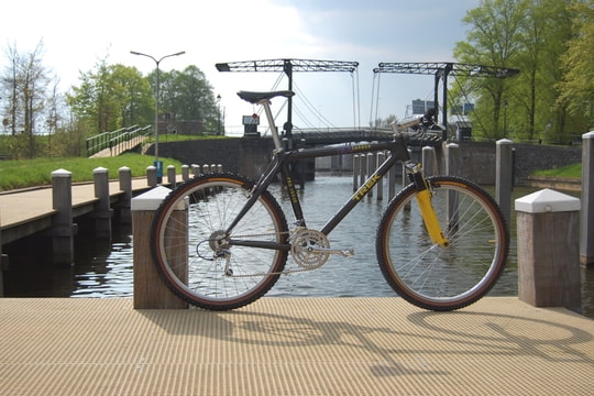

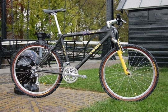

Well Finally my Trek 9900 is finished
Click the picture for a larger (and much better) picture
Some extra pics:
Together with LTSbikers '99 Trek 9900 and my brandnew '09 Trek 8000 :
Basicly the bike is finished... at least it looks finsihed in the pics.
There are some things I still need to do and want to add to the bike to give it a bit more personality
Finish:
- I still need to polish the Syncros stem and get the new decals on it.
Replace/Add:
- Replace Trek System 2 stem by a Syncros Titanium version (preferable NOS :roll: )
- Ringlé Mojos in black
- Ringlé H2O also in black
- Matrix Voodoo Rims so I can build a wheelset with my M910 hubs. (currently the bike has a XT M737 set with Mavic 217 rims)
But stuff like the Mojos and the H2O are not stuff that I want to rush, if I find them I replace it until then the stock stuff will do fine.
And yeah in case you're wondering... the pics are taken at the same place as LTSbikers RTS....at the same time to be exact...
And also with the same result... (damage rear mech and saddle)
