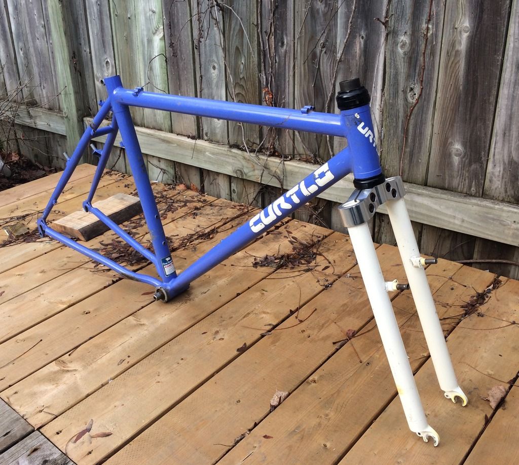

Here's another example of handmade brazed MTBs from the early 90s.
This is a 1993 Curtlo Mountaineer built by Doug Curtis in Santa Clarita, CA.
I've been looking for one of these for a long while and tried to pry two out of CA unsuccessfully. Finally three suddenly showed up on fleabay in a matter of weeks and I nabbed this one.
I'm not 100% sure if this is one of the frames Doug purpose built for the ActionTec fork. The previous owner said it had a manitou fork of some kind on it. Curtlos were some of the very first suspension adjusted MTBs. That rigid fork on it is suspension adjusted so it may get the call. It certainly matches the tubing well. I may need to track down an Action Tec fork.
Anyway - it needs a full repaint.

Really nice, great to see some fillet brazed goodness as they are pretty rare in the MTB world.

8) thats looks very nice, i think it would look good with those forks colour matched. Have you decided on a colour yet? Look forward to seeing more pics :)

Thanks ... still trying to get the BB out :|
I'm not sure on a colour. Curtlo did like wild colours, heavy annodizing, or both. I don't have any bikes with 3dv so I may go there.
I'll prob use that fork or a Manitou of some kind. Something chunky like the frame.

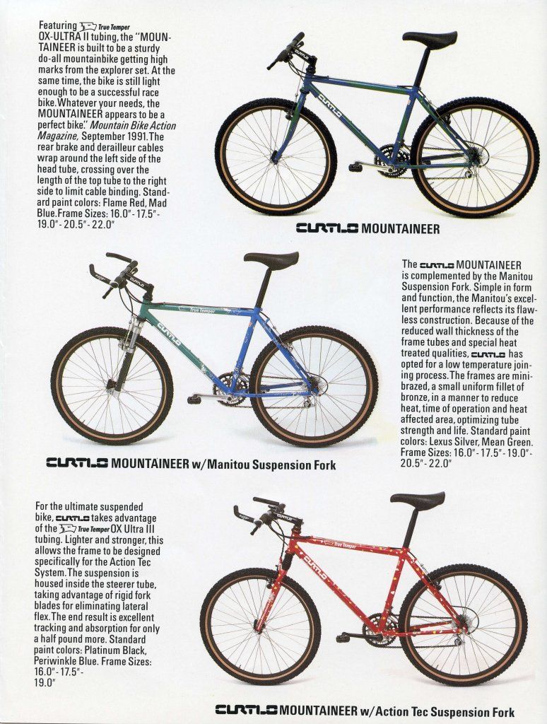

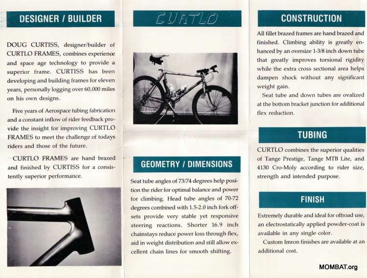

Here's some examples of Curtlos.
