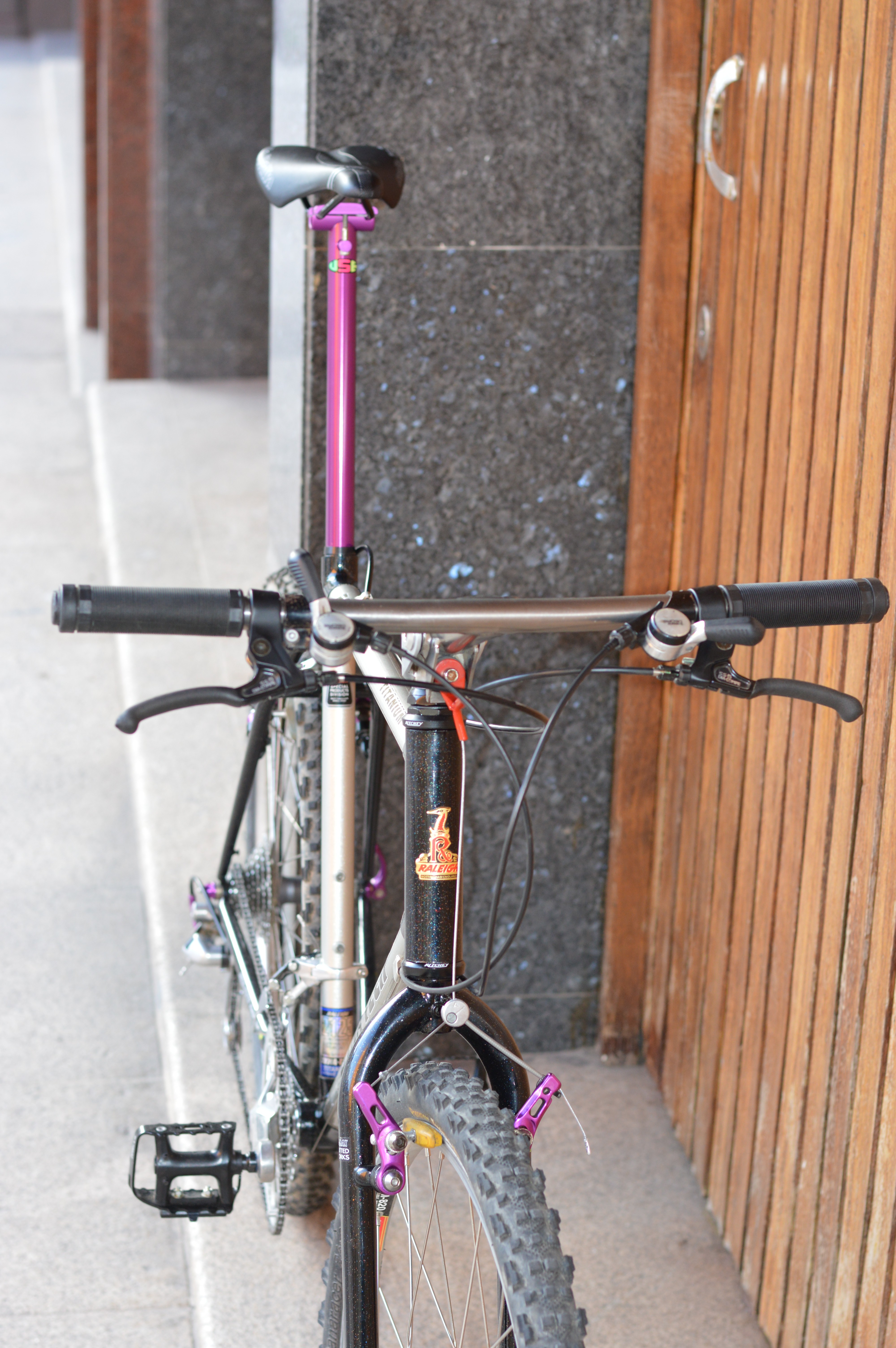

After a long time at the planning and parts collecting stages, I have now completed build version 1 of my Raleigh Dynatech MT4.
The frame and forks are identical in construction to the Dynatech Ogre, my first and longest standing unicorn, so this is a pretty special build for me. The idea was to build something light, with titanium components ,purple bits and a period correct groupset where possible. And of course, because space is limited at home I wanted to build something I will want to ride, as I don't have space for dead weight here.
I also tried to include some cool components I've wanted to use in a build for some time, like the titanium Girvin Flexstem and my snowflake front wheel.
Spec sheet:
Frame: Raleigh Dynatech MT4
bonded Ti (main tubes and chainstays)
Reynolds Mang-Moly 531 steel (seat stays)
aluminium (head tube).
Fork: Reynolds 531 Direct Drive fork.
Headset: Ritchey Logic
Stem/bar: Girvin titanium stem and bar combo
Seat post: USE 420 mm
Saddle: modern Selle Italia with steel rails
Brake levers: Dia Compe SS5
Brake cantilevers: Dia Compe 987
Drivetrain:
Deore LX RD-M550 rear derailleur
Deore LX FD-M550 front derailleur 28.6, bottom pull
Deore LX FC-M550 chainset SG rings
Deore LX PD-M550 pedals
Deore MT62 thumbshifters
Deore LX HG70 11-28 8 speed cassette
Purple cog hog
Front wheel: Deore LX hub HB-M560 with Ti axle, PG stainless steel spokes (snowflake), brass nipples, Araya TM820 rim
Rear wheel: Deore LX hub FH-M570, double butted stainless steel spokes, Weinmann Zac 19 rim
Skewers: modern Hope steel QR purple
Tyres: Panaracer XC Fire Pro 1.8
Tubes: Butyl
Weight including pedals: 22.5 lb (+/-0.5 lb)

8) Nice, i always liked these black MT4's, i think they did a blue one as well, i even have a pair of forks sat waiting if ever one in my size comes along :)

Please tell me you're going to lower the seat-post!

Thanks for the feedback, guys.
I wanted to maximise the purple look, so I set the post quite high. But at 6'3" I do need a pretty long set post to ride even the largest of Dynatechs. I'll probably just use a black kalloy post for everyday riding, though ;) If I like the way it rides, and if I can deal with the low front end, I'll make a few select upgrades.

Hey Andy it's really great to see this, nice job! :)
The Ti flexstem's a perfect choice, Dyna tech's can carry it off much better than most I reckon.
It's a little bit emotional seeing her up and running to be honest. It might have been a 'false start' and never used, but this frame (built up), was essentially my first MTB, and sat forlornly in the bedroom for 22 years with me feeling so guilty for not using it.
Go thrash the wheels off it mate!
