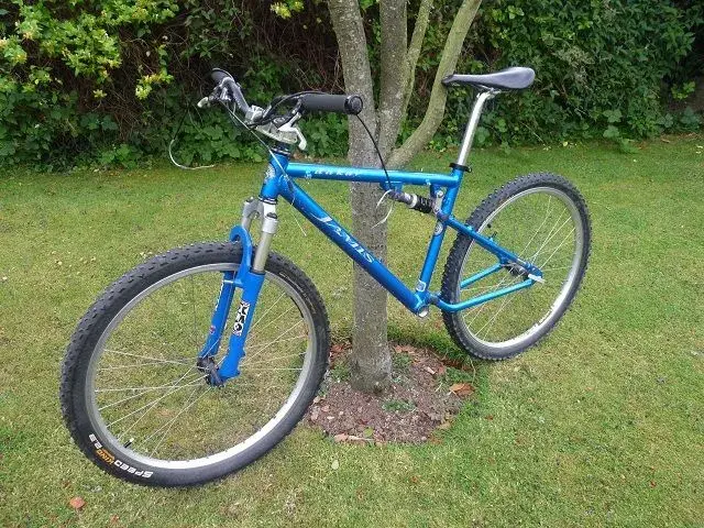

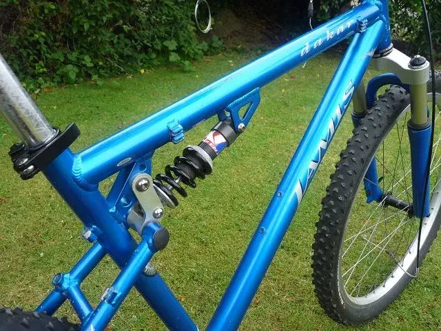

Anyway, sorry for prattling on, here's where I'm at, pics are crap as my camera really doesn't like the low light. Stand over is a bit high for my little legs, but the saddle is pretty much where it will need to be, so doesn't look too daft, and stood against the Breezer, you can see that this has a higher bottom bracket.
So I give you....1995 Jamis Dakar....

Thanks! :mrgreen:

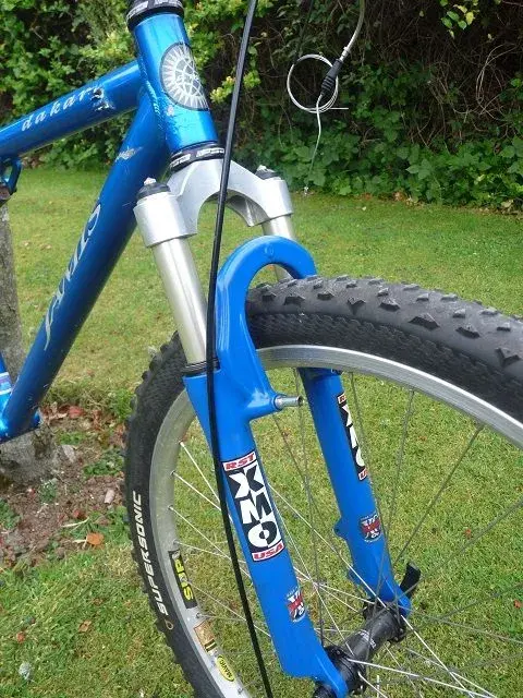

The forks are amazing, so incredibly smooth and light. Have been fiddling with air pressures, but really need to be riding it before I make any firm decisions, seem to need less air than they recommend, but suppose it's only ever a 'ball park' figure... Englund cartridges in them, and Made in the USA stamped on the back. So cool.
Thanks for the compliments guys.
Get some if you ever get the chance Lynne, these are far nicer than SIDs, or the Judys or whatever it was that had the Englund air cartridges in.
Of course, it doesn't hurt that they're blue, my favourite colour.... :cool:

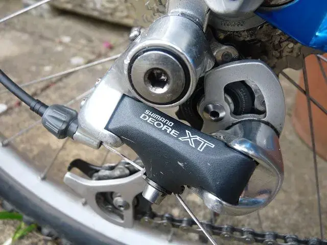

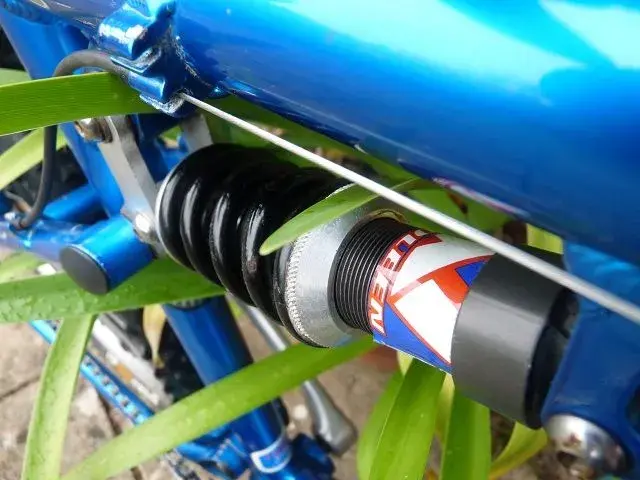

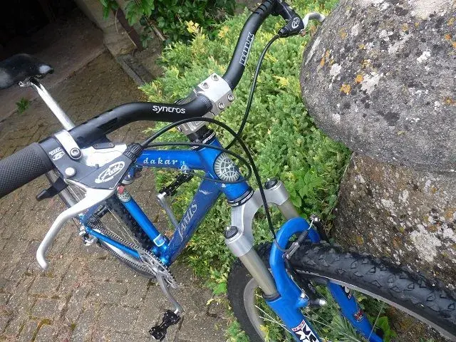

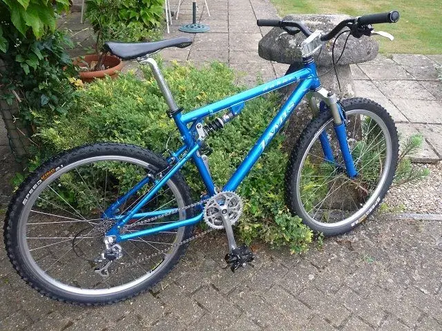

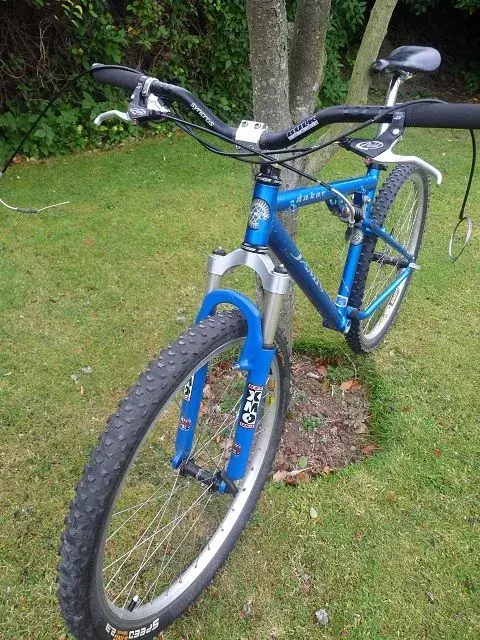

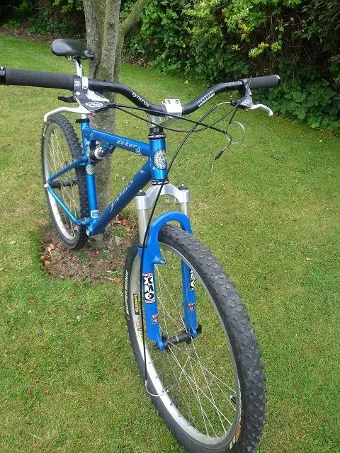

A bit more progress over this weekend, just need to find a front mech and shifter now. I do have a LH thumbie but not keen on using it if I can find a rapidfire with a bit of patience.
Special thanks to MatBH5 who swapped me the XT rear mech for a tool I had, and Widowmaker, who karma'd me the Sugino chainset a while ago, both perfect, and apparently that chainset was OE on these!

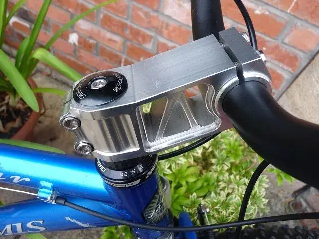

Not liking that stem though, could do with something slightly shorter and less heavy, with more of a rise, so will look out for maybe an Azonic Orc or similar. Definitely back to 'budget build' status now though, a bit heavier than I would like overall but not wanting to spend money means I'll have to live with that for now....

That looks great! :cool: I've had an Azonic ORC on ebay for a couple of weeks with no interest so have just relisted it as part of a clearout job lot. Let me know if it's any use Kaz.
Nice build, I love these frames.
I had a Team once, bare alloy with red decals.
Very nicely built and light, still a pitty I had to let it go.
Another stem and flatbar would finish it perfect.
