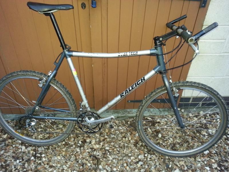

had this for a while now, built it up as a cheap work bike and rode it on a few retrobike regionals and to be honest it rode really well, just looked scaby and tired .........patina? :wink:

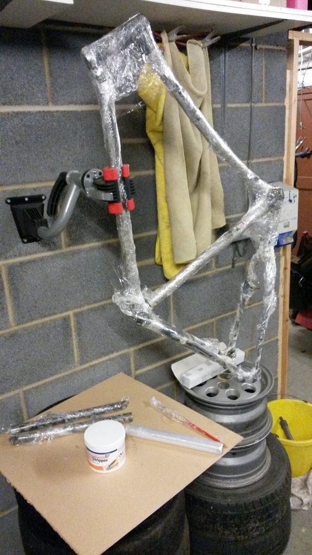

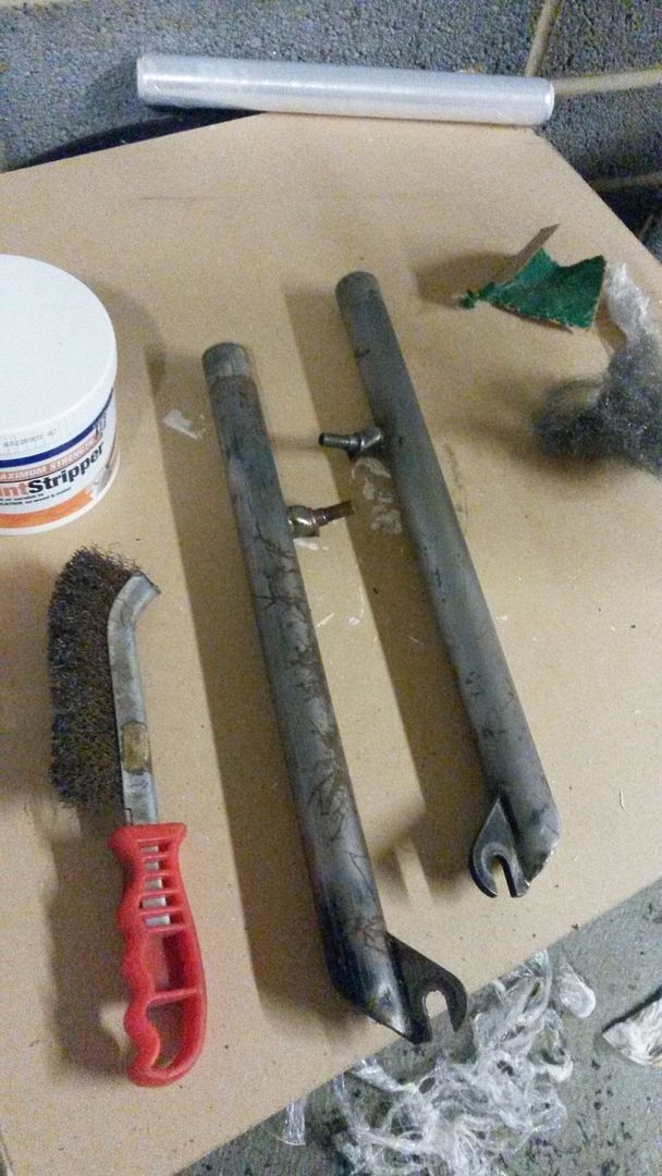

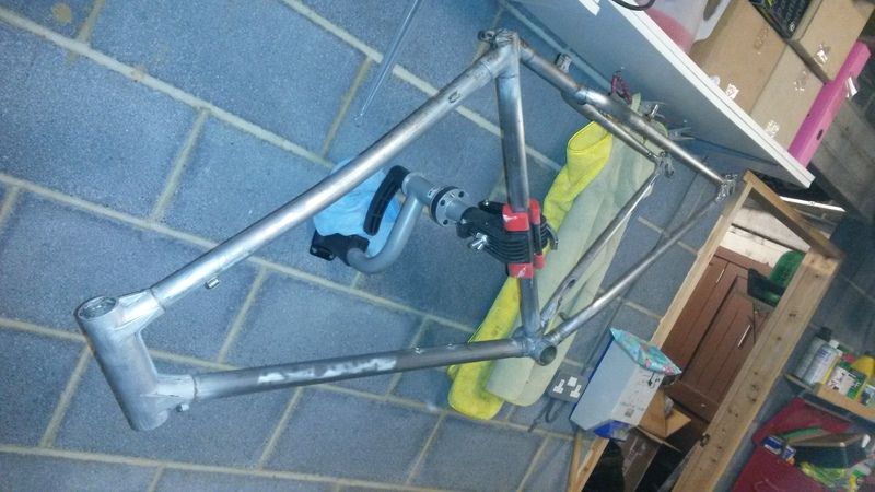

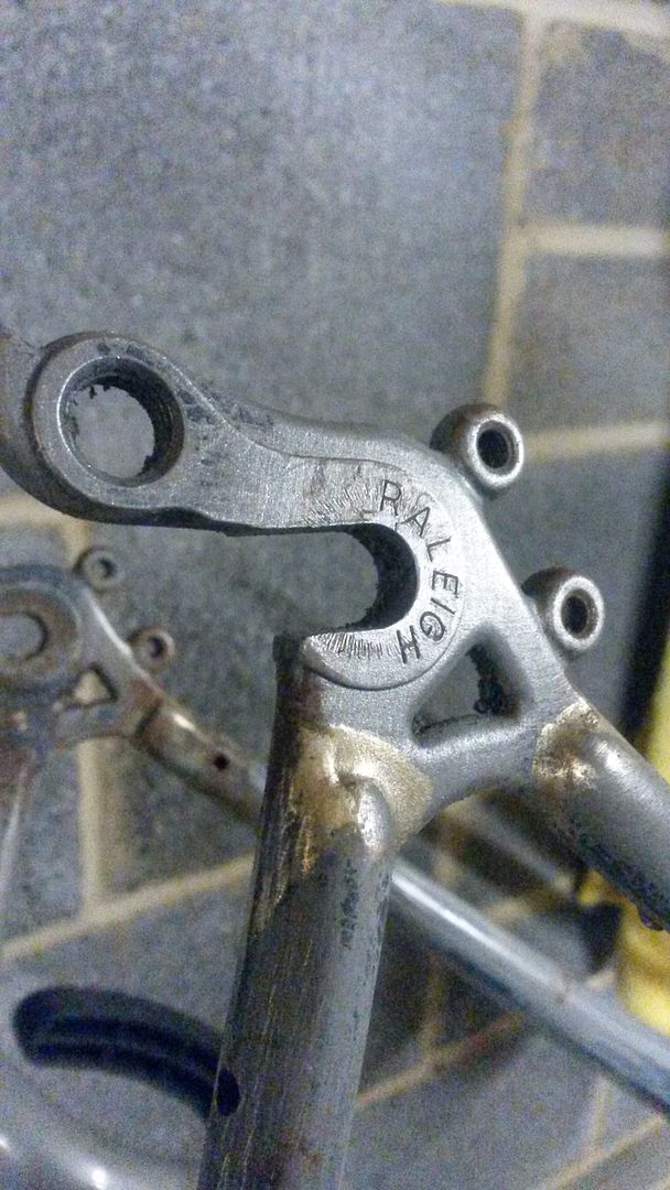

first job was to strip the old paint, after reading dan chambers reply in another thread i got some paint stripper from b&q, wrapped it in cling film and forgot to unwrap it after a night, 2 days later the paint came of really well!!! cheaper than media blasting and quicker than waiting for it to be done after hours. great trick and ill be doing it again. the rc30s i got of that there ebay had the same treatment.
before
built for abuse
paint stripper and cling film
rinsed and rubbed down

forks

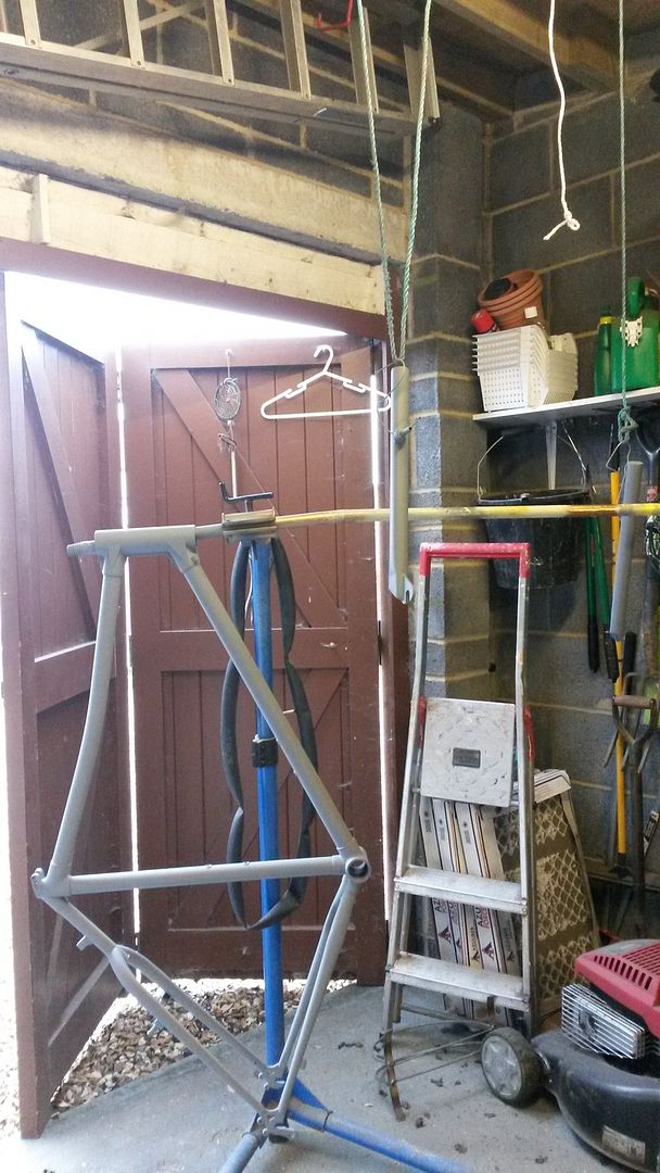

currently sat with a primer coat to protect it while i source more paint etc

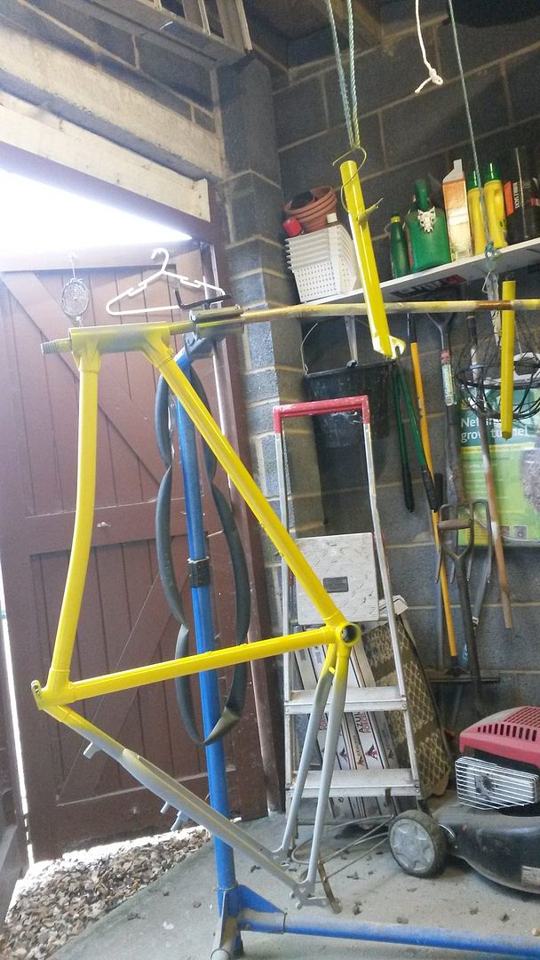

small updates, primed it and gave it its first couple of yellow coates this afternoon.Will wait for it to dry more before i finish the yellow and will figure out the best way to cover the yellow before the blue gets laid on. Reckon clingfilm and masking tape will be easiest?
getting there......slowly

Looking good C,
What paint are you using? Other than yellow and blue,obviously!
Clingfilm and tape sounds best, got any transfers on the way?

cheap hycote? stuff from wilcos, saving for another pace so limiting funds, itll get mucky and scuffed eventually so not bothering with costly stuff this time. the wifes just told me shes out all night so no mancave action for me :(
may test clingfilm on some old forks, see how it goes.....
