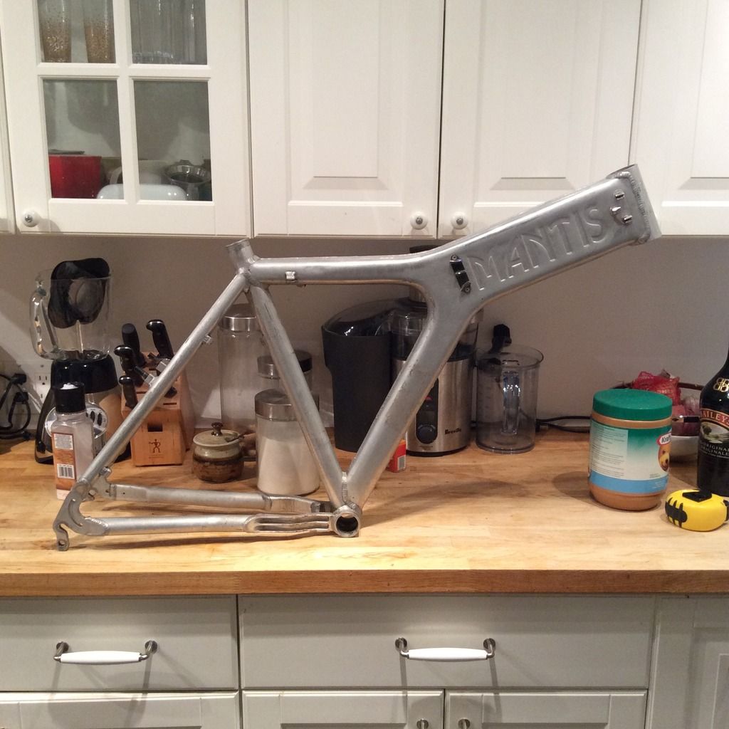

I didn't need another project but this was one of the frame was on my list. I drooled over one of these things at the bike show when I was 15 with the rest of my buddies. It was candy red and more expensive than all our stumpys, fusions, and thin blue lines combined. Post Cunningham I know, but I didn't know or care in 1995 :D

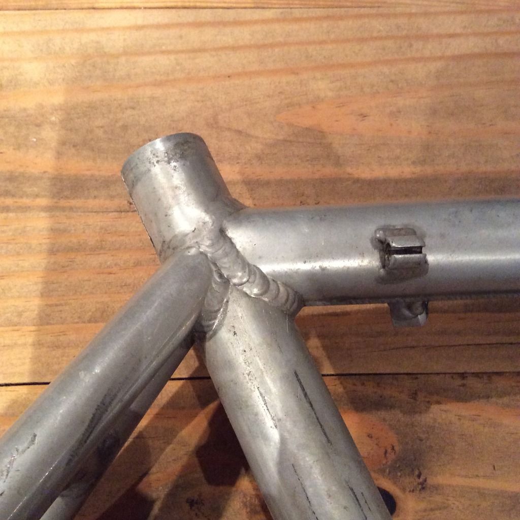

I assume it's a 1995 Mantis Flying V. It has an odd twist though. The cable routing is all different, and no cantilever noodle. It could be custom ordered as its all original with no evidence of modification. It has a seemingly lower s# than every V I have see online.
I think it could have been special built for Maguras. I wouldn't run a brake cable through that top guide. Anyone seen one like it? I may modify the routing a bit ... I don't like how the front derailleur cable fits.

Should be pretty fun to build. The mid 90s had tons of blingy bits and I think this one will get a lot of that treatment. I started with some flashy bikes than have gone through some more classic builds recently. This one will be a lot more wild.

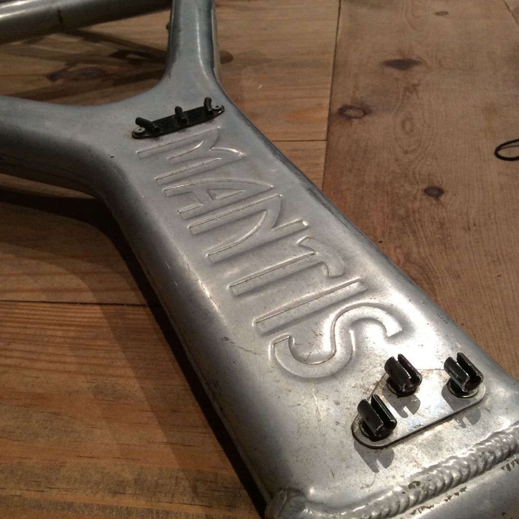

That lower noodle essentially leads to nowhere. If you run a front derailleur you can't run any cable braking using the existing cable stops. I had the frame looked over and we were scratching our heads. The only thing we could come up with was that the pull off the front derailleur was changed to top so a Magura line could follow it to the rear possiblly clamped to it. That would mean that lower noodle was ignored completely. Assuming Mantis' builder wouldn't make a custom noodle plate guide that's was our best guess.

Its a puzzle! Basically its missing the welded on noodles isn't it? One for the FD and another for rear brake. Could ot be used for V brakes as is?

Yeah that's about it. I could go v brakes as is if I pair the front derailleur cable up.
I have a couple of options for modification:
- I could re route the front derailleur cable like a stock Flying V and either run v brakes or add a cable hanger for cantilevers.
- I could modify both lower cable guides for either v or Magura brakes.
I am leaning to toward option 2. I was playing with it and I think that is the best option for a clean look. I like V brakes for simplicity but I have never built a bike with Maguras and I do like variety.

Looks like you got one of the frames that was never finished and then sold years later when the factory/warehouse unloaded whatever they had left hiding in the corners.
It may or may not be missing the brake noodle. I've seen others without one. It's definitly missing the front derailleur cable stop(s) on the frame.
Also the Cunningham era rear cable guide set was likely added later. The correct guide for that "C" frame would have just been 3 simple loops, not the bent tubing.
