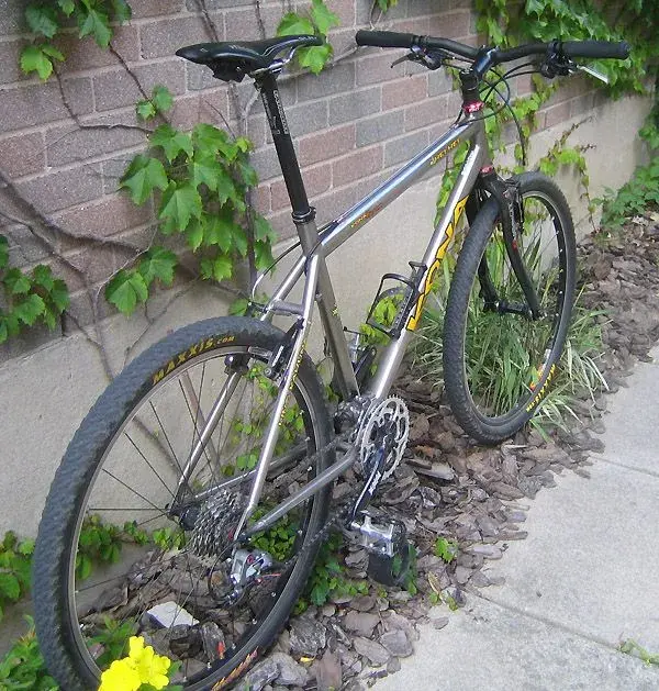

Been meaning to post this for some time. This is by far my favorite ride. At an honest to goodness 16.48 lbs. (7.475 Kg), its an outstanding performer. Super responsive and agile. Not period correct by any stretch but it was sure fun to build.

I like 8) how do you find the forks?been considering them :?

I must say it looked even better when you had a titanium P2 on it, so I have to believe that carbon Trigon must ride better. I mean, you wouldn't have fitted it just because it was lighter, would you Steve?

Ha! Lighter yes. I agree, the Ti P2 looks better but the ride of this fork is sublime. I highly recommend it.

What are those tyres ??

Crikey that's light 8)
Any chance of listing the parts you've used?

Bottle Cage: CatEye plastic
Bottle Cage Bolts: Aluminum
Bottom Bracket: Action-Tec Ti / 68x 107
Brake Levers: Extralite Ultralevers
Rear Brakes: Extralite Ultrabrakes
Front Brakes: Extralite Ultrabrakes
Cables: Tune housing / Jagwire cables
Cassette: Cycle Dynamics Ti 8 spd
Chain: Sram 89R hollow pin
Crankset: Race Face
--Arms: Next LP
--Crank Bolts: FRM alloy
--Ring bolts: FSA alloy chainring bolts
--Outer Ring: TA 42t
--Middle Ring: TA 32t
--Inner Ring: Vuelta 20 tooth alloy
Derlr (Front): XT
Derlr (Rear): XTR mid cage (tuned)
Fork: Trigon Carbon w/ ti canti stud
Frame: King Kahuna w/ ti canti studs
Grips: Kona Race Light
Handlebar: Easton EC90 SL riser - 610mm
Headset: King / Ti base plate
Headset Cap/Bolt: Syntace
Headset Spacer: Carbon
Pedals: Odyssey Svelte Flat - Ti spind
Quick Releases: Control Tech Ti bolt-ons
Saddle: SLR Carbon XP
Seat Binder: Extralite Clamp
Seatpost: Extralite Post UL
Shifters: XT 8 spd (tuned)
Stem: Extralite roadstem (upside down) 100mm
Tire (Front): Maxxis Maxxlite
Tire (Rear): Maxxis Maxxlite
Tubes: Maxxis Flyweight (2)
Wheelset (Front): Custom build / X517 w/ tune hub
Wheelset (Rear): Custom build / X517 w/ tune hub

Maxxis Maxxlite: 310 grams each. Lightest tyre on the market.

That would explainn why the total weight was so low !
Nice build btw 8)

Nice build.
How do you find the Maxxlites?
I know some have moved away from them after repeated punctures due to the thin walls.
I have to say I like the idea of 310g tyres as long as they grip/handle OK and are relatiively durable. 8)
