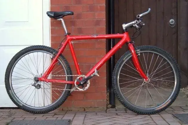

Threw this together today, bit of a mix match of parts.
Spec is;
Frame: 1992 Cannondale M500 (If any one knows differant please say, oh, there is no frame number!)
Fork: Cannondale Pepperoni
Headset: Hong Kong Fuey 1,1/4
Stem: Kalloy UNO
Handlebar: No Name Alloy
Grips: Random oval grips from the bottom of the parts bin!
Barends: Onza (steel)
Brakes: Coda
Brake Pads: Aztec
Brake Cables: Shimano
Cantilever cable hangers: Coda Force 40
Brake Levers: Shimano STX RC
Shifters: NA
Front Derailleur: NA
Rear Derailleur: Alivio
Derailleur Cables: NA
Cassette: Shimano 17 tooth sprocket
Chain: Shimano
Cranks: '95 LX RH, random LH
Crank Bolts: Yes
Chainrings: Standard Shimano 34? tooth middle ring.
Chainring bolts: 5 of them...
Bottom Bracket: UN52
Pedals: Tioga surefoot RH, odd crap LH
Hub Skewers: Shimano
Rims: Sun
Hubs: Shimano Exage
Nipples: Hmmmm
Spokes: Stainless
Tyres: Continental 2.3 Kevlar Bead
Tubes: Raleigh Ha Ha
Saddle: Velo
Seatpost: Coda
Seatpost Binder: Coda
As you can tell, a real mixture of random stuff, but hey, it works.

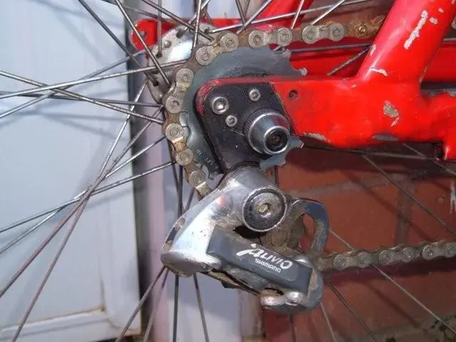

I hacked down an old rear mech with an angle grinder for a chain tensioner, it works, but i haven't tried it off-road yet. Stripped two old cassettes for the spacers, to space the single sprocket on the freewheel. Think you could say this is single-speeding on a budget. :lol:

Dont think its a M500 bud. Pretty sure they came with a Tange fork, my mates did anyway. But thats good news Prob an M700 or above
 Post subject: Re: M500
PostPosted: Sun Jun 15, 2008 10:11 pm
Joined: Wed Feb 13, 2008 6:44 pm
Posts: 1045
Location: Treading Water...bloody summer
My '92 M700 came with a Pepperoni anyways - not sure about the M500 though.

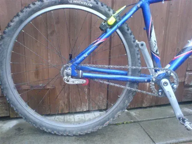

heres my budget ss build. rough cost is only about £35 due to having most parts already....
