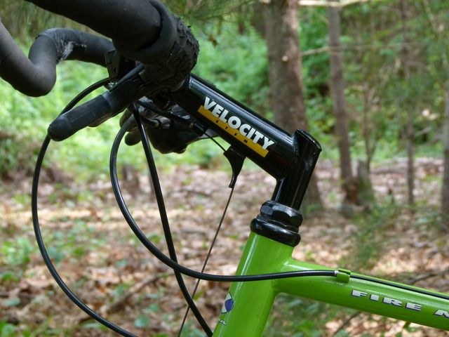

I happen to have a 1992 Fire Mountain that I bought....new. The bike never got much in the way of upgrades. I did replace the original (steel) handlebars with a scott AT-4; it was a bit odd that while at college there were about 5000 bikes, only three green Fire Mountains including mine and all three ended up using AT-4 bars.
The stem that's supposed to be on the Fire Mountain is the velocity sport. I think the difference is it's a bit shorter and has a higher rise, whereas the regular velocity was more of a 90 degree bend.
This is the stem on my bike.
The original seat has a bit of yellow that balances with the yellow part of the stem/forks/tires.
I think I would get some yellow anodized chainring bolts if using an all black crankset.
BTW, the seatpost clamp is on backwards, or did you mean to do that?

It's hard to tell, but it looks like I have a Velocity and not a Sport - mine is certainly right angled:
