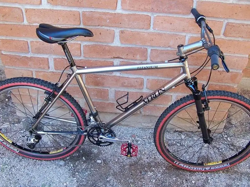

We don't see Orange bikes on this side of the pond so it is cool to see bikes from different countries. I have a 1990 Merlin that I did a retro-mod style and it rides amazing. I also went with the exotic carbon forks and it is a great combo with Ti. I also used a shim to be able to use the 1 1/8 Titec stem. Mine is set up as a 2x9. Look forward to seeing your build.
