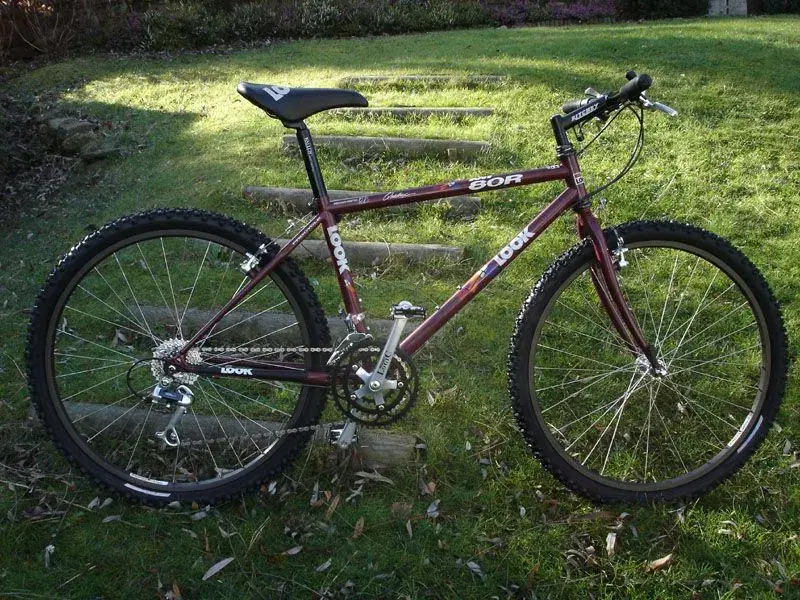

It's amaizing to see your Look MI60, looking good.
I've got a NOS MI80R
