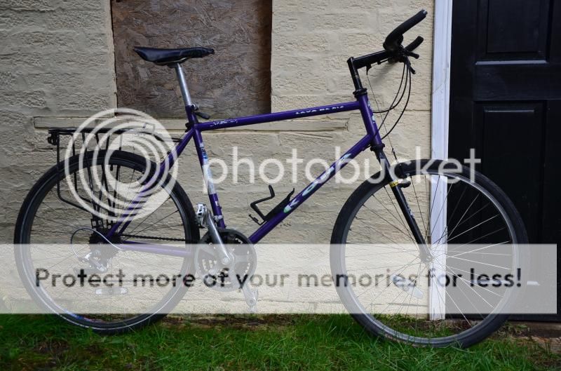

Saw this for sale and felt sorry for it.....bogged down under low-end components and commuter tat. Just had to save it! Nothing more satisfying in stripping off years of worn, heavy, crap components and getting a project back on the trails where it belongs.
I've had a kona itch that I've wanted to scratch for a while now so this seemed a perfect opportunity. Not much of it is original but most of the original components were quite low end so no real worries there....I've got a spares box full of bits that should sort this out nicely.

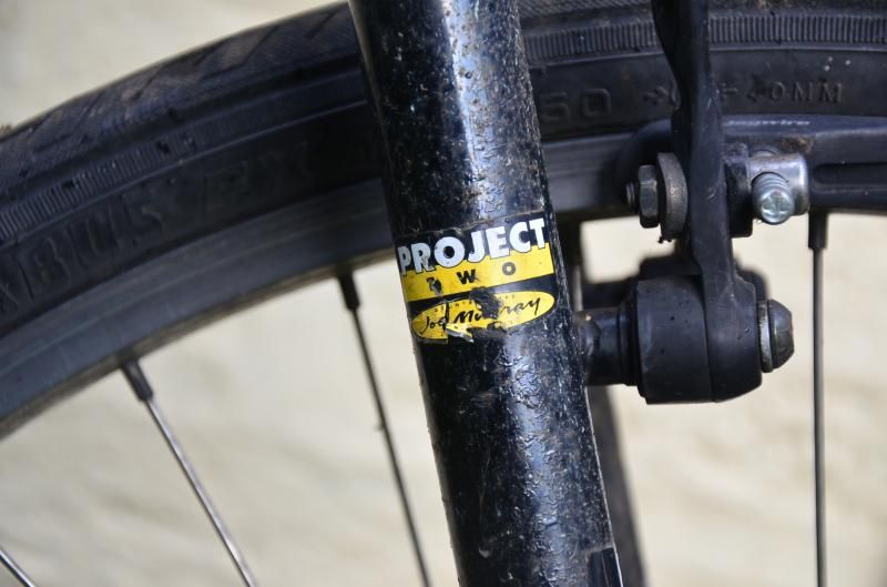

Forks have seen better days.....pretty rusty - so these are on the list for a strip & respray. Do P2's rust really easily? The rest of the frame is really good but the forks and stem are really grotty.

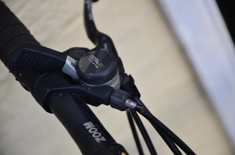

It's got the odd nice bit bolted to it. Minty LH XT thumbie. Unfortunately no RH one to match! :(
Picked it up this morning and after an hour of spannering had it stripped back to a naked frame.
Morning spent stripping it......afternoon spent building it. Quite an indulgent day all-in-all.

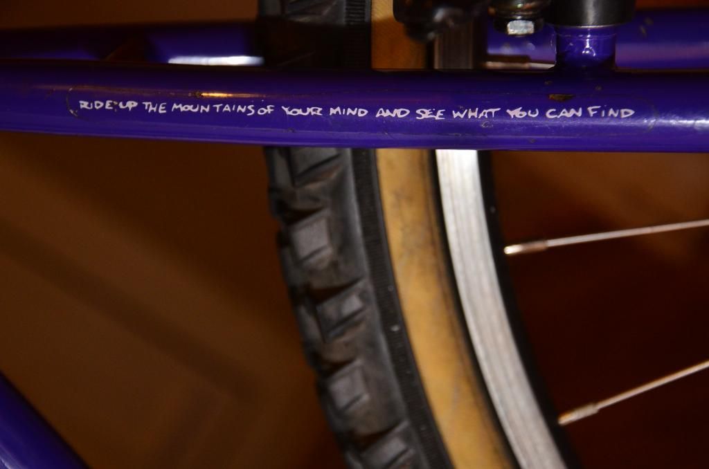

"ride up the mountains of your mind......." ;)

Any chance of helicoiling the thread in the seat post , to too familiar with the seat clamp :?
love the graffiti , 8)
Jo Burt, MBUK stickers circa 94/95/96
