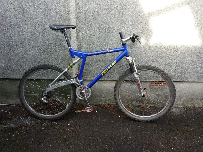

A little project I'm working on.

I had one in '97 and another a couple of years back. Look really well with the yellow decals.
The geometry can be awkward though, the crazy BB ground clearance made it feel like mounting a horse to get onto :) No big deal though, just get the stem built up the steerer another 30mm or so.
Have you had/worked on these before R kid? Firstly, remove back wheel and make sure the long bolt that passes through the elastomers is nipped up nicely, and threadlocked. Tends to loosen off after a while. It won't fail catastrophically, more that you will feel the play in it if it isn't tight enough.

Not really any proper experience - I'll take note about the bolt. Funny thing I have a set of risers and was trying them out on this but I think flat bars are the best.
Love it. I have plans to mod/rebuild my 856 for next season. Going 1X8 and with a 85 mm Magura fork and BB7 discs up front.
The last I rode it seriously it had a 76mm Manitou FS fork and was great compared to the stock Girvin fork.
What are you additional plans for the 756?
I cobbled one together from the spares box a couple of years ago , mag 21 instead of the vector , it's really nice , fast enough for me and quite light

The thing i like aboutr the 756 is that there doesnt see mthat many about, but you do see a few more 856's. I have a pair of nollen vectors but I like the simpleness of elastomers so thats why i bolted on the USA Mozos. I might try and fit it with full STX RC as i do like that groupset.
Stx rc was a nice groupset nice snappy shifters too
And if you get the pace adaptor you can run proper BCD chainrings , lighter than XTR with that set up too
Cantis or vee's tho ?
I want to stick with canti's as it has the canti bit on the swing arm and the forks are canti as well.
