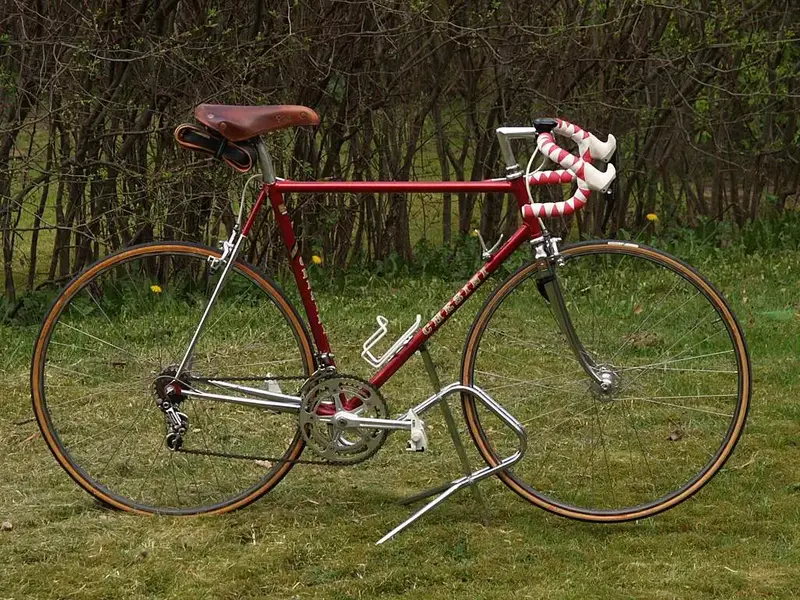

I built this in 1984 and it is still pretty much in it's original configuration. Only the brake handles have been changed.
The Nouvo Record parts (hubs, cranks, seatpost and headset) comes from an older (mid 70's) Crescent roadie that I chrashed mightily with, they were the only usable parts left when the dust had settled.
So, armed with a couple of months worth of paychecks I ordered the frameset and the rest of the componentry, started building and ended up with this.
24 years on, I still use it regularly. Many thousands of miles have passed under it's wheels.
Frame: Chesini X-Uno - Columbus SL tubes
Fork: Chesini - Columbus Aero tubes
Headset: Campagnolo Nouvo Record
Stem: 3ttt
Handlebar: 3ttt
Grips: Benotto wrap
Brakes: Campagnolo Super Record
Brake Pads: Campagnolo in the rear, Aztec up front
Brake Cables: Modolo
Brake Levers: Modolo America
Shifters: Campagnolo Super Record, custom Chesini design
Front Derailleur: Campagnolo Super Record
Rear Derailleur: Campagnolo Super Record
Derailleur Cables: Campagnolo
Cassette: Regina Oro
Chain: Sedis
Cranks: Campagnolo Nouvo Record
Crank Bolts: Campagnolo Nouvo Record
Chainrings: Campagnolo Nouvo Record
Chainring bolts: Campagnolo Nouvo Record
Bottom Bracket: Campagnolo Super Record
Pedals: Look (the very first clipless pedals)
Rims: Mavic GP4
Hubs: Campagnolo Nouvo Record
Nipples: DT Swiss
Spokes: DT Swiss
Tyres: Vittoria Corsa tubeless
Saddle: Brooks Colt
Seatpost: Campagnolo Nouvo Record
Weight: 10.7 kg
File comment: 1984 Chesini X-Uno

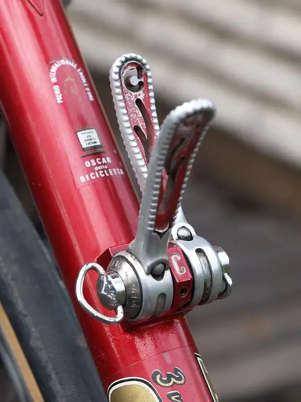

File comment: Top-mounted Campagnolo shifters. The cables are routed inside the frame tubes, as is the rear brake cable.

8) Classy ride, how on earth are the gear cables routed around the BB?
There is a sleeve with grooves for the cables around the crank axle and the bottom bracket housing has an opening underneath.
Here's how it looks :http://www.wooljersey.com/gallery/v/Kevin-Krugers-Bikes/ChesiniXUno/ChesiniUnos26.jpg.html
