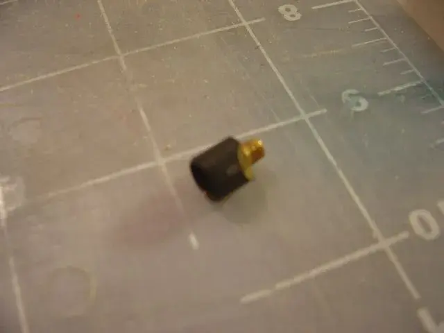

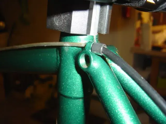

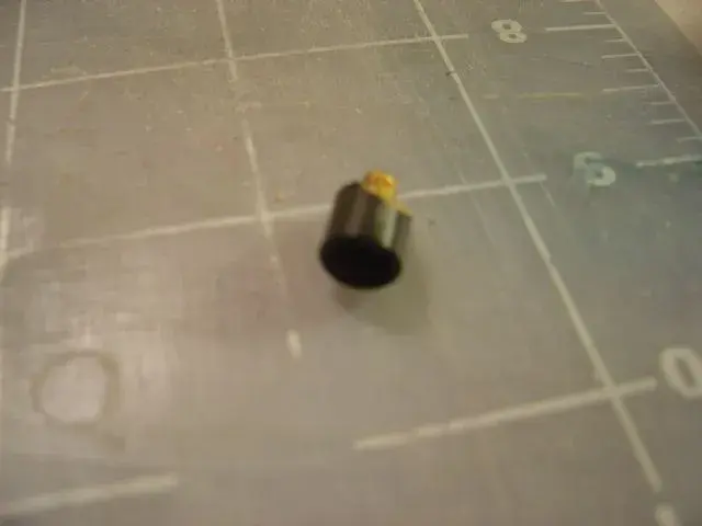

CTK, apologies for the terrible pics, however here is the bit I mod'ed to put v-brakes on this bike.
The part looked much like a cable housing ferrule with a threaded stud coming out the end. I chucked it up in a drillpress and pressed a file against the threads to file them away and make the stud small enough to fit into the cable guide on the frame.
The Ritchey's cable guide is just a little loop on the frame, so it was easy to install this little gizmo, whereas yours has a full-on tube brazed into the frame. You could simply do what I did and go with it from there. The only purpose in the little piece I made is to give the end of the housing a solid place to stay.
