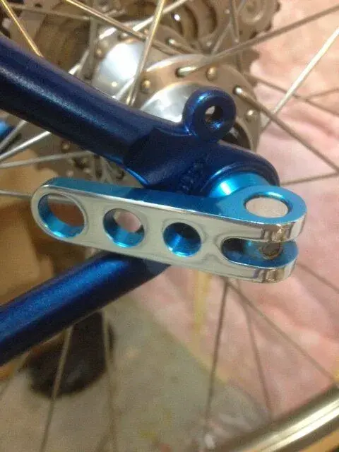

Sanded :
WD :D
I went down the sanding route followed by a polishing wheel with a sisal mop, takes a long time but the finish is worth it !
WD Pro":em8rbuyg said:
Nice ! :cool:
Was that following the instructions I did ? :D
WD :D
Having read your instructions WD I've spent the past 3 weekends polishing
ending up with 2000 grit W&D followed by a metal polish and the Tecut
great results without any power tools / Mops
