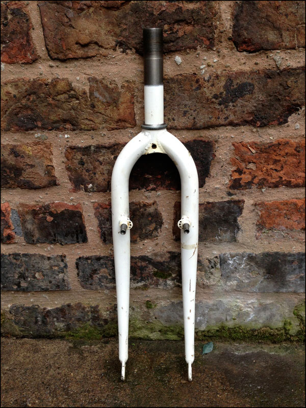

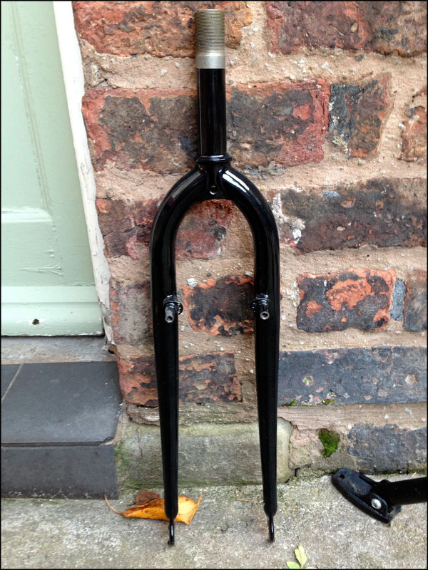

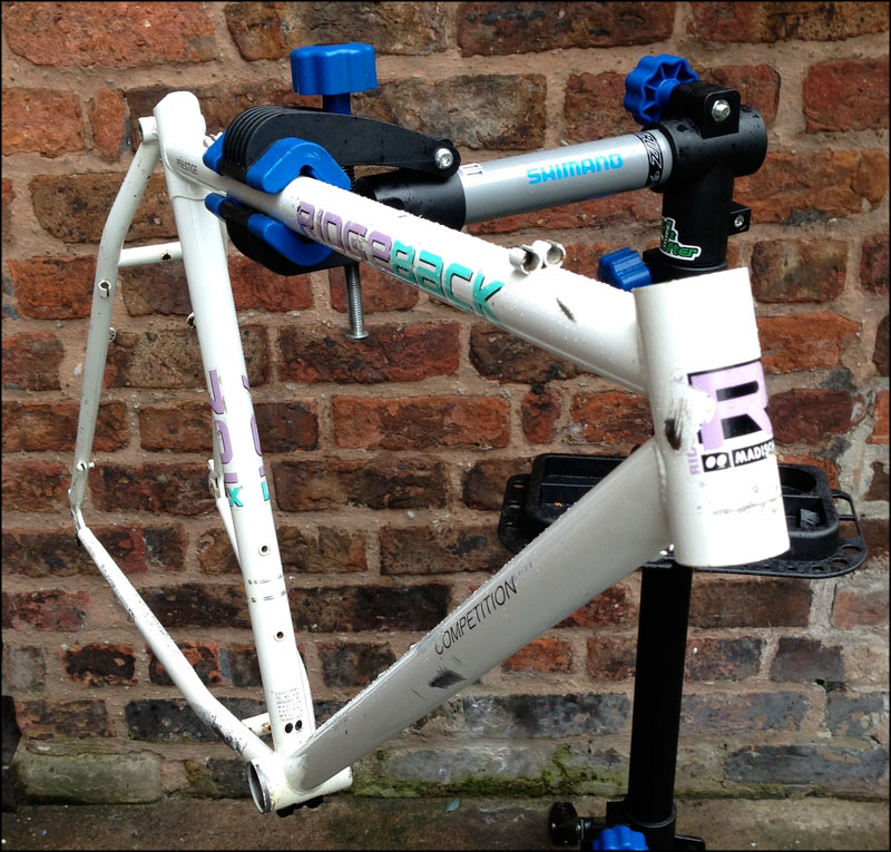

Here are Matty's pictures of before and after the powder-coat.
As you may be able to see, the powder-coaters neglected to mask off the BB threads and brake bosses. The old headset crown race was also powder coated onto the forks.
Fortunately, running a bike repair business means that I was able to chase the BB and other frame threads pretty easily. The brake bosses took a little more time to clean up with a Dremel, a file and emery paper.
The crown-race came off eventually leaving a good clean bare metal behind.

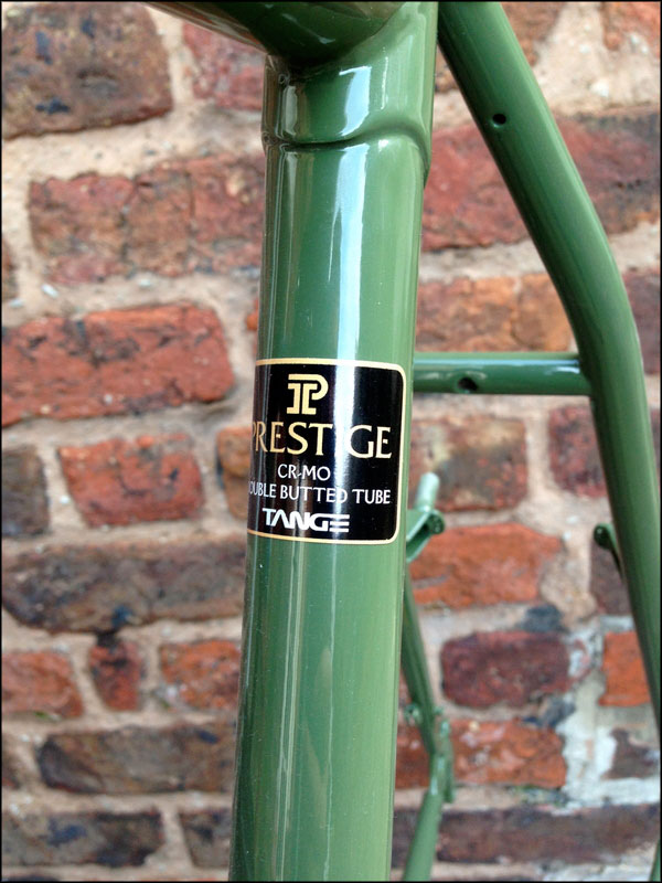

Of course, as usual, I wanted to keep things pretty much period correct and groupset based. I also wanted to upgrade from the 400LX and 500LX that would have been originally on this bike. It's worth noting that the 701LX shared the same Tange Prestige frame with the higher specced 702LX, 703DX and 704XT.

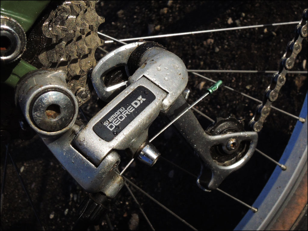

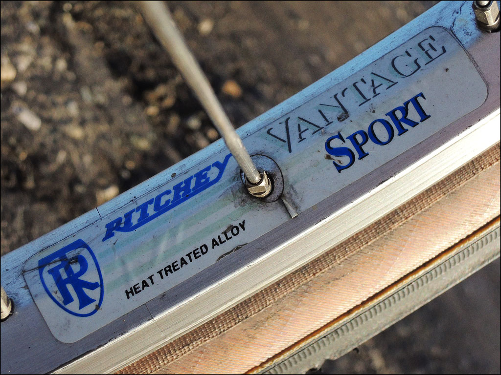

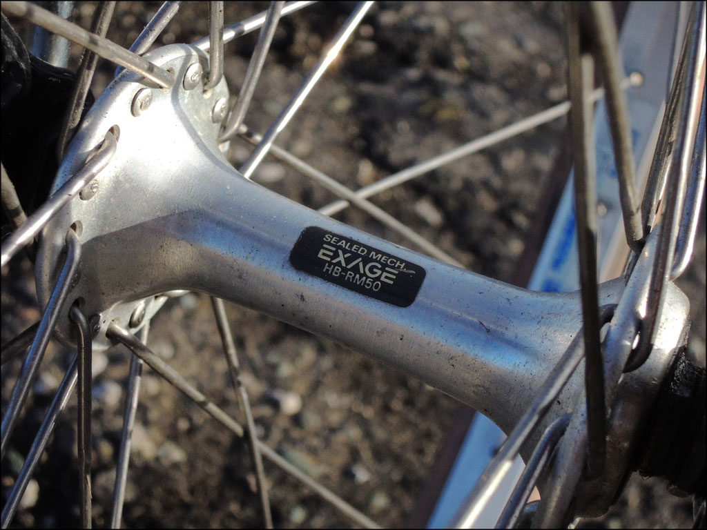

So I looked through my spares and assembled most of a Shimano Deore DX groupset from 1990 and found a nice set of Exage hubbed Ritchey rimmed wheels.

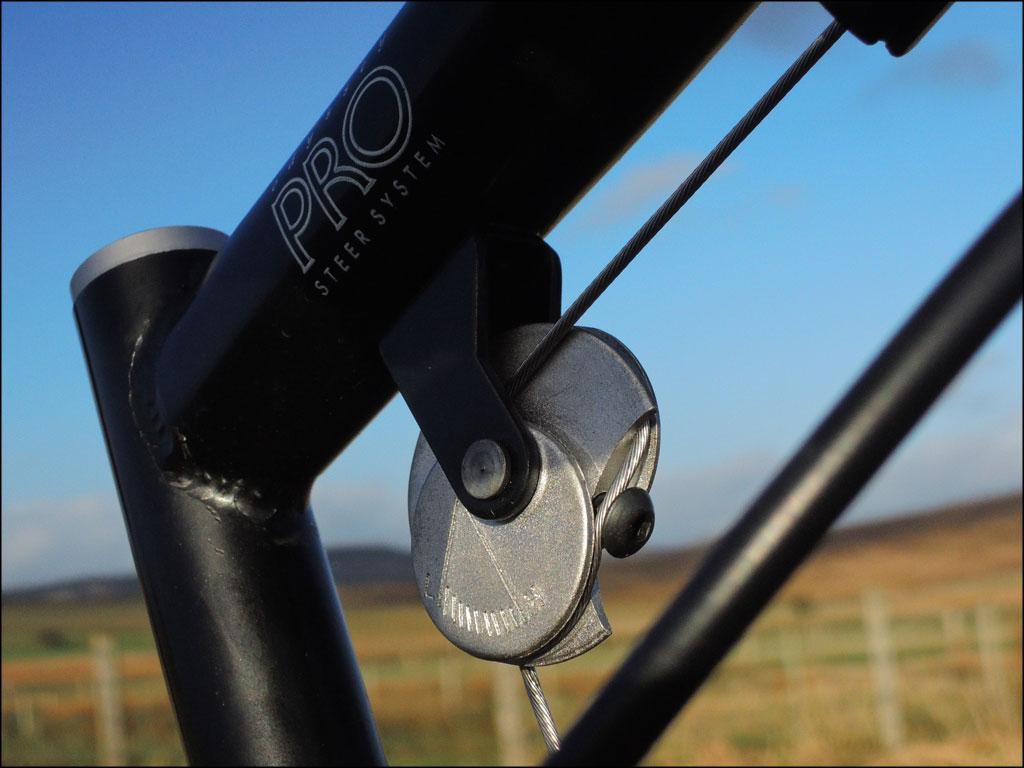

I didn't really spend any money on this bike apart from the NOS Odyssey stem with it's rather nice power boosting roller cam. I did have to buy a new one inch headset as well which turned out to require a JIS rather than ISO crown race. (27.0mm for JIS - 26.4mm for ISO)

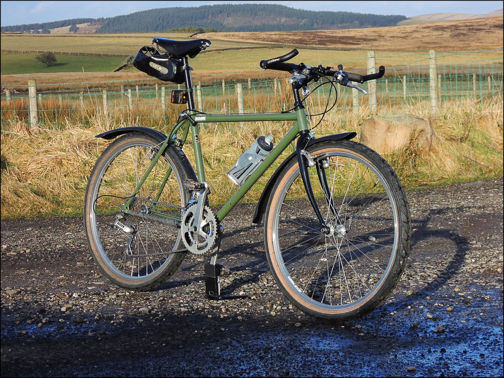

Time for some pictures from a lovely afternoon in the hills just up the road from me...
A you can see it's built up for winter road duties, so I'm utilising an old 50 tooth outer chainring which I purchased back in 1993 for an upgrade to match the fashion for a huge outer ring at the time. This is paired with a steel 34 tooth inner and a 11-28 seven speed cassette.

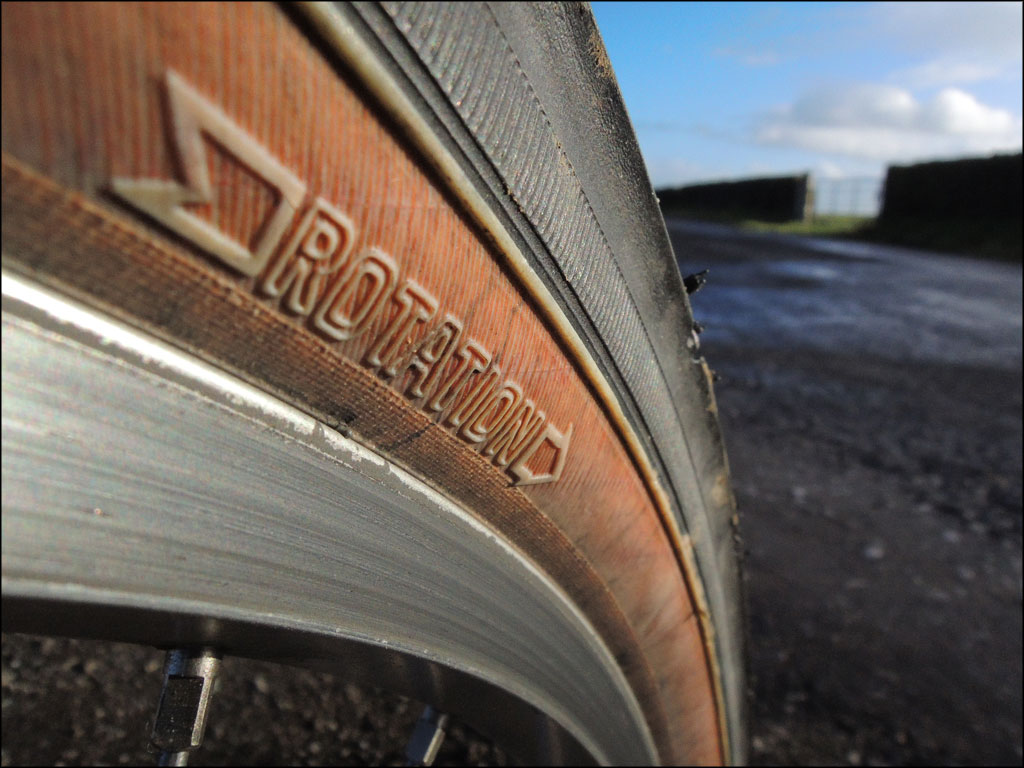

The tyres are a pair of amberwall Schwalbe City Jet 1.9s which I picked up for a fiver at a bike jumble.

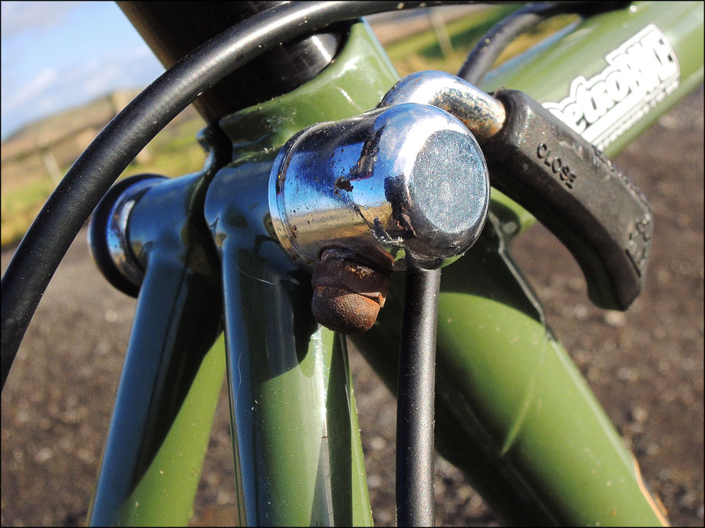

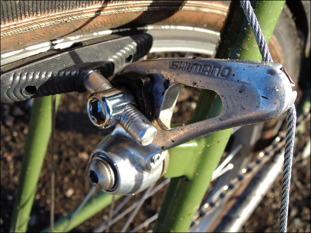

I've gone with Aztec brake pads for proven stopping power which, when combined with the wide profile cantis and the stem roller cam, give some nice powerful braking.
Practical additions include Zefal mudguards, lights and a fully waterproof and rather capacious Ortlieb saddlebag for a few spares. The water bottle also means I can also forgo my usual Camelbak.

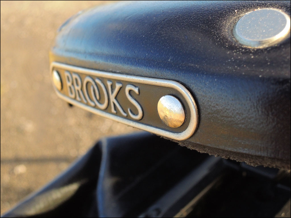

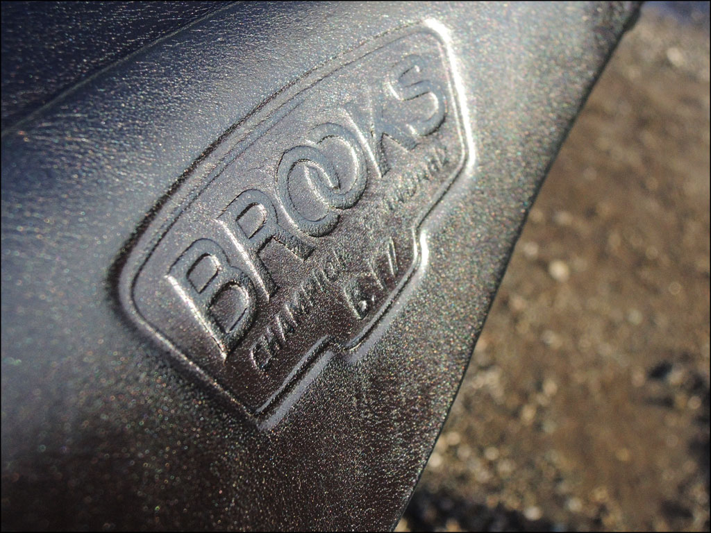

The Brooks B17 saddle is rather extravagant for what is essentially a winter hack bike. But it's been borrowed from my touring bike which sadly for the last couple of years hasn't done much in the way of touring.
And of course bar-ends which I like despite them being voted amongst the top 15 all time worst MTB products in a recent poll. They are great for climbing and for an extra couple of hand positions.
Having already ridden this bike a few times I am becoming quite familiar with it. Overall it's fine and has a nice stable ride with the compliance that decent quality steel gives.
One problem is the very short head-tube and resulting low front end.
Running the stem near to it's limit mark helps remedy this and provides a usable and reasonably comfortable riding position.
I guess it still needs a few tweaks until I'm completely happy with it...
But considering the whole bike cost me so little then I'm happy enough for now.

Looks great Paul , I do like the colours,
Thanks for the detailed pic on the Odyssey stem cam as I was wondering how this worked and now realise that I have done it completely wrong on the 2me2u , I will fit a new cable and rectify 8)

The stem was new old stock and came in the original box with a sticker and some instructions.
Even with those there was a bit of trial and error to get it right.
Very powerful once perfected though.
