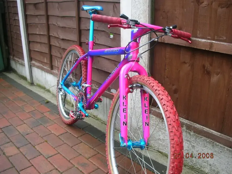

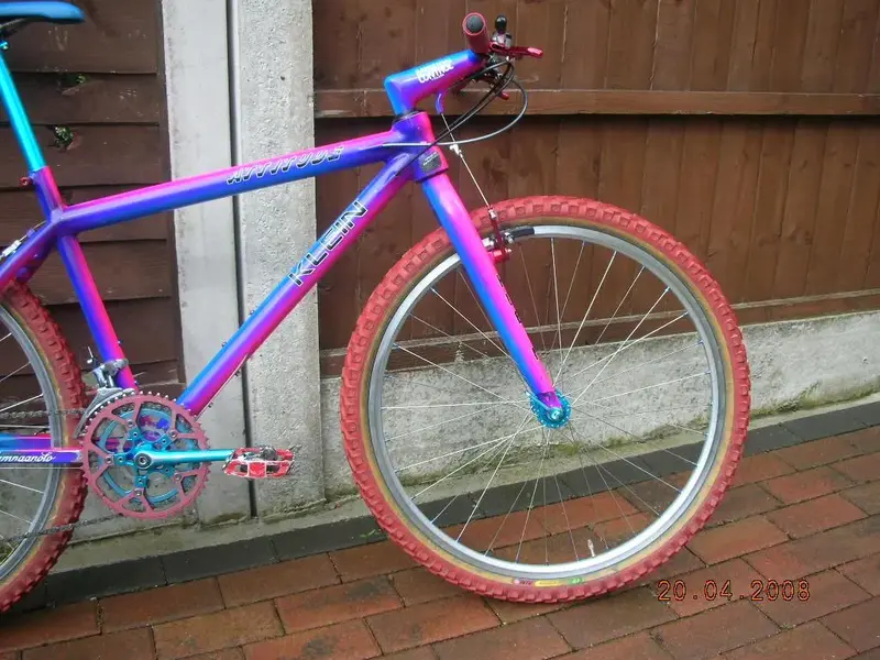

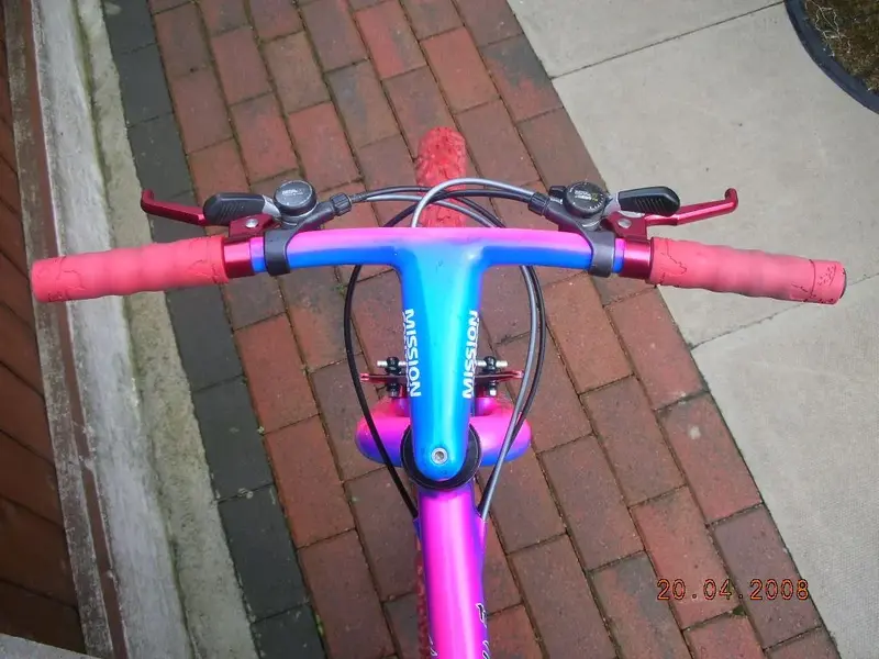

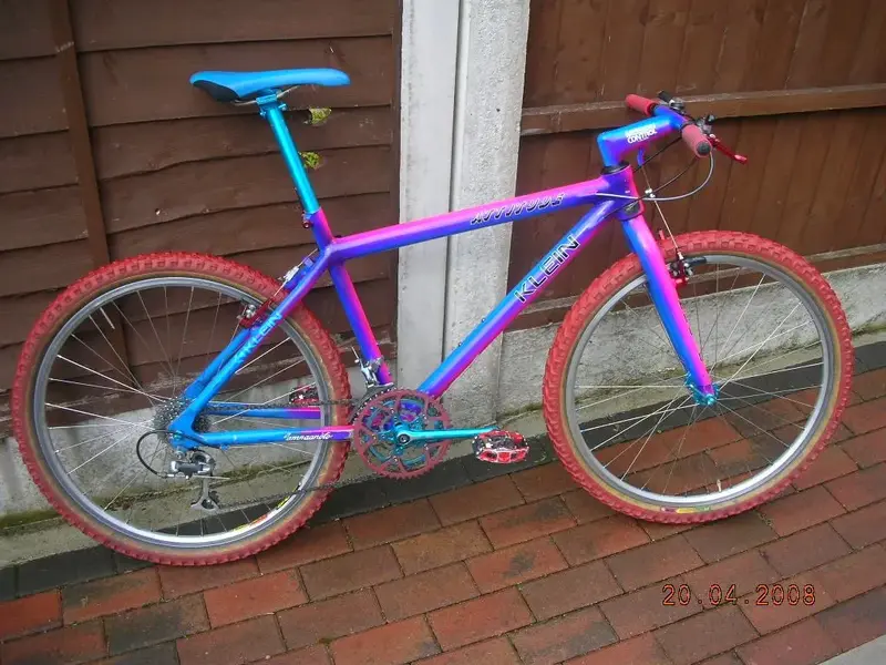

Finally, i've pretty much finished the Klein that I was building for my girlfriend. The bike is the original one that I bought when I was 14. I sold it when I was 17 and regretted ever since. I then happened across it a few months ago on ebay, and it went from there. This is my first retro build and i've now developed a very expensive obsession! I've built it up with a mixture of red and blue components.....I think it works, but others may disagree! Still need the finishing touches; I can't find any suitable straddle wires and I want an m900 rear mech. Then i'll be happy!

nice bikes! but please set up the front brake properly. the straddle triangle is way too steep. the carrier needs to sit much deeper, close to the tire to get the brakes working properly.
biketoolsetc.com has nice diacompe straddles for $3 each
http://www.biketoolsetc.com/index.cgi?i ... Link-Wires

Thanks Carsten! I've been trying to find a shorter straddle wire for a while, but i've struggled. I'm an impatient man, so I just used what I have. But I will be setting it up properly, don't worry!

Seriously though, soon I hope pal. I need you to show me the trails around here! Recognise those brake levers??? I think I actually love them!
